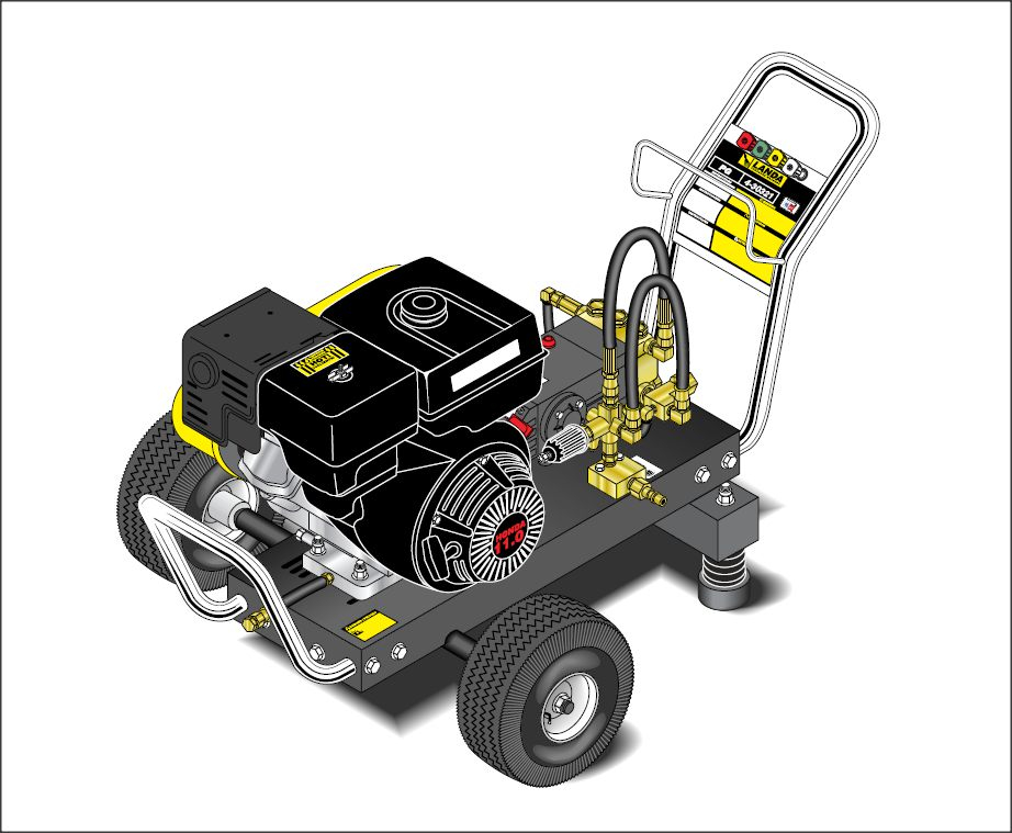

I want a gas power washer but many use more water than my hose can deliver to it. For a unit rated at 3gpm can I lower the rpm of the engine to use less water? The unit is rated at 2600psi and I do not need that much either. If I lower the rpm of the engine can I lower the psi to a still usable 16-1800psi? Thanks.
Yes you can!
I bought a used belt driven Landa 2500 psi / 2.5 gpm with 11 hp Honda GX 340 back around 1995 or so and run it at reduced rpm frequently, not because of lack of water but there are many times when less works better!
The washer has a nice factory "idle down" option where the engine drops to idle speed when you release the trigger, for example need to move around or take a short brake etc.
I have made a couple of changes over the years:
  • Installed a high pressure hose reel elevated above the pump.
  • Switched to larger (log splitter) wheels, to make it easier to move in a grassy yard area.
It has been an excellent washer and I am sure there are other brands with similar features.
