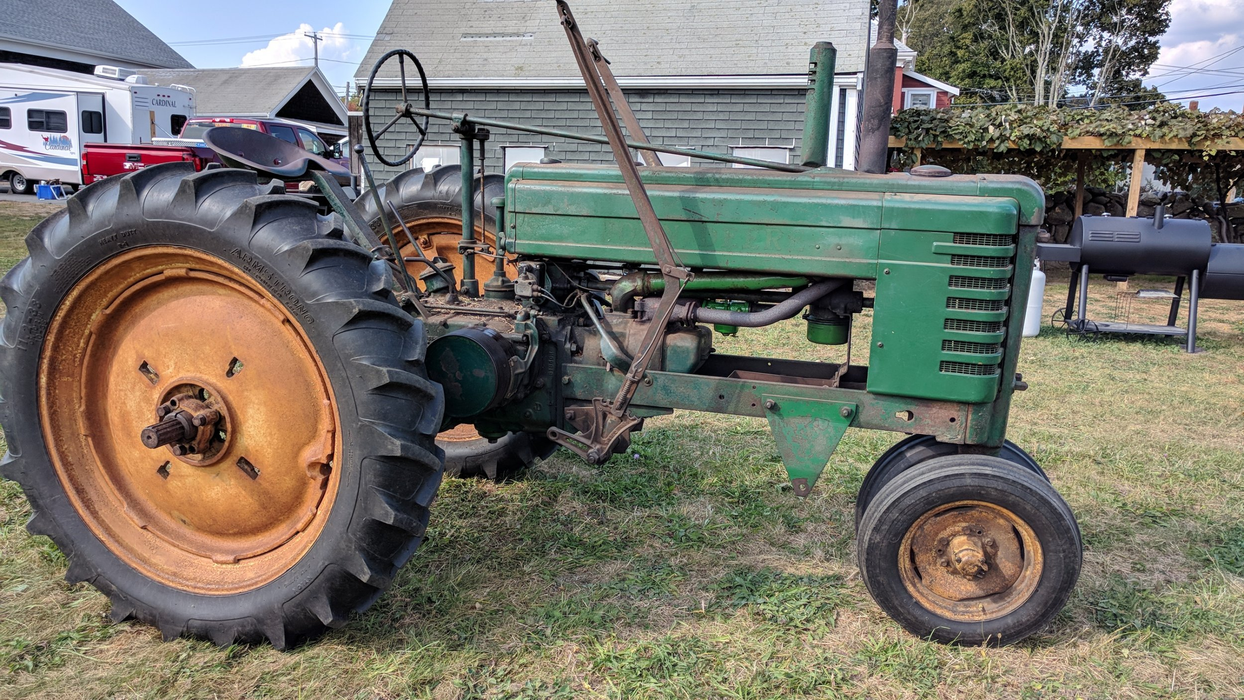

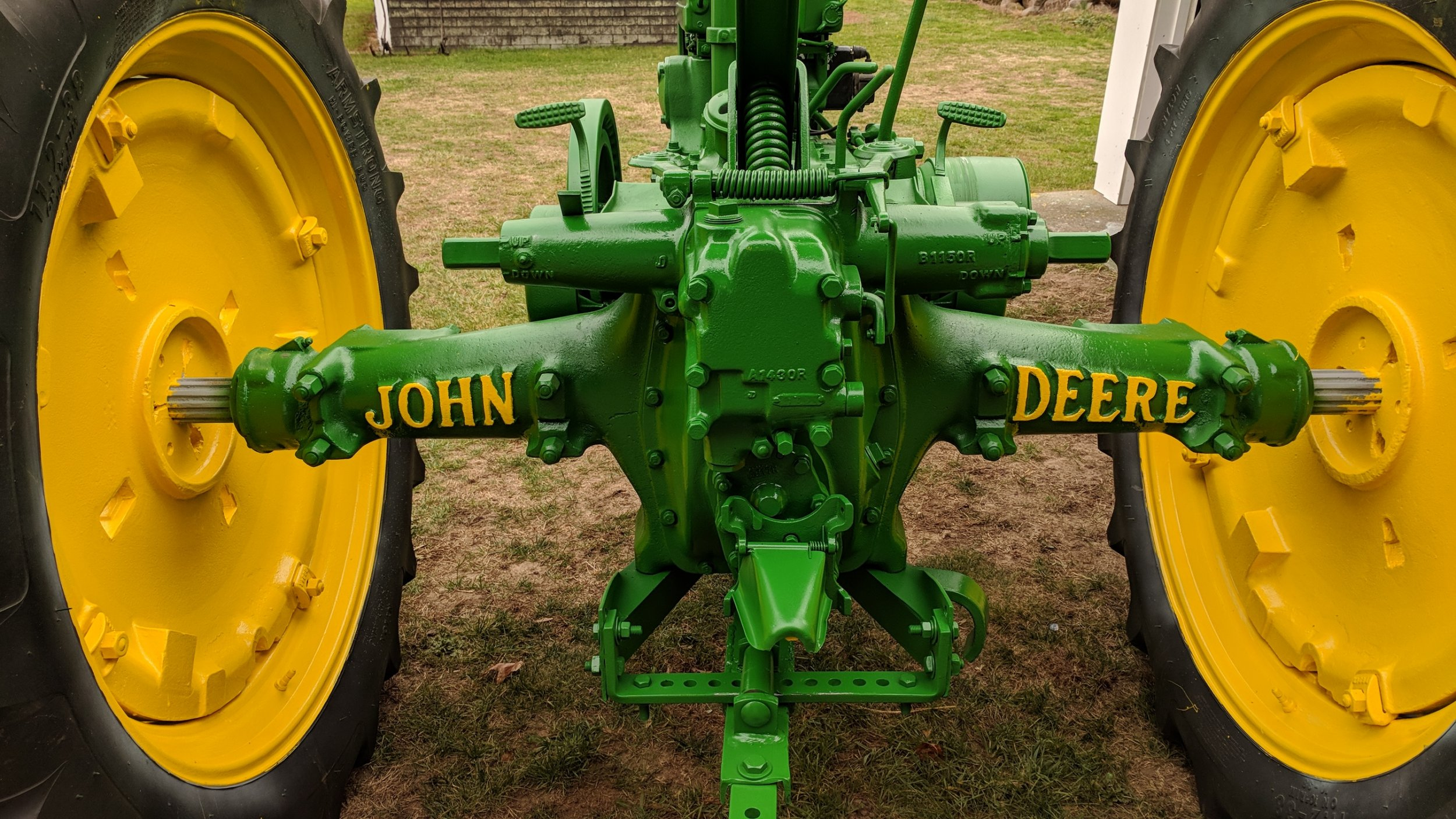

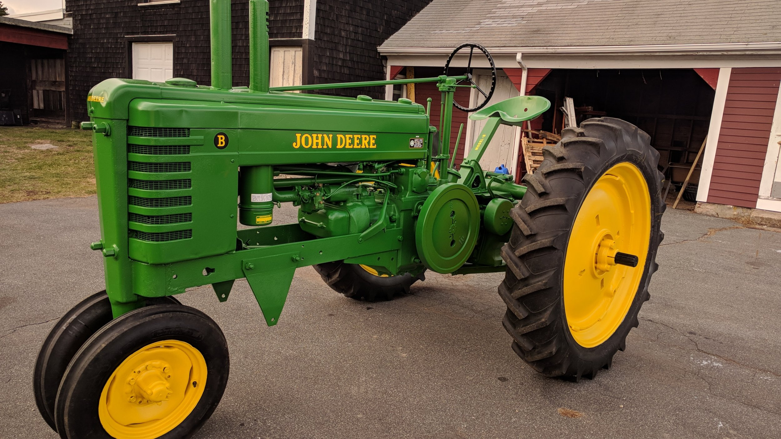

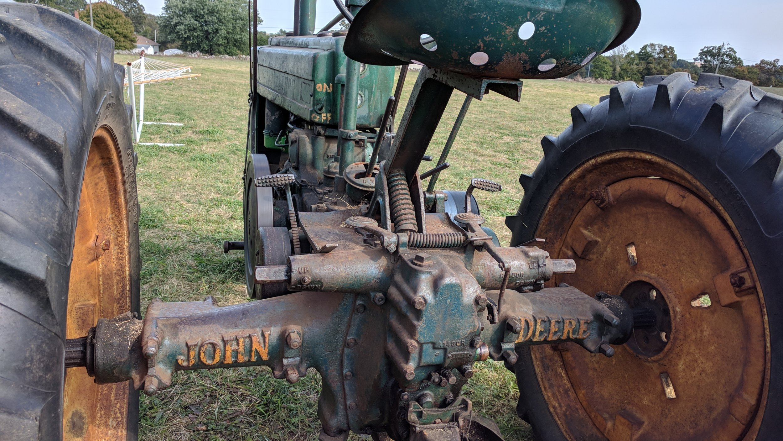

If your lucky to live near a dealership That sells racing fuels you can get gas from them. Hi test and no dang ethanol. Also I live near a small airport and they sell good gas with no ethanol. Only thing it's not cheap which is why it's hard to not go diesel for a lot of work. But this post gives me urge to post my Sunday go for picnic ride tractor. LOL Grabbed my Grandads old 41 B and tore her apart and gave her a new look. If you use good gas and shut off the petcock to keep gas out of the carb you have no problem firing it up and running. Except maybe the new fangled carbs are too sophisticated to do that today. But so far all my small gasoline implements work good using that technique.
Before and After:
