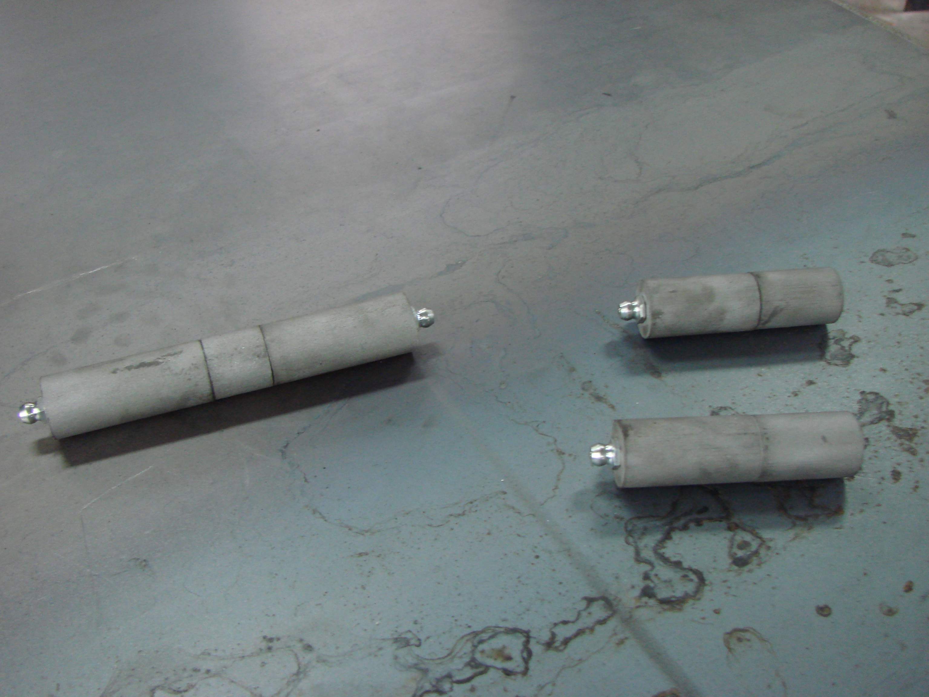

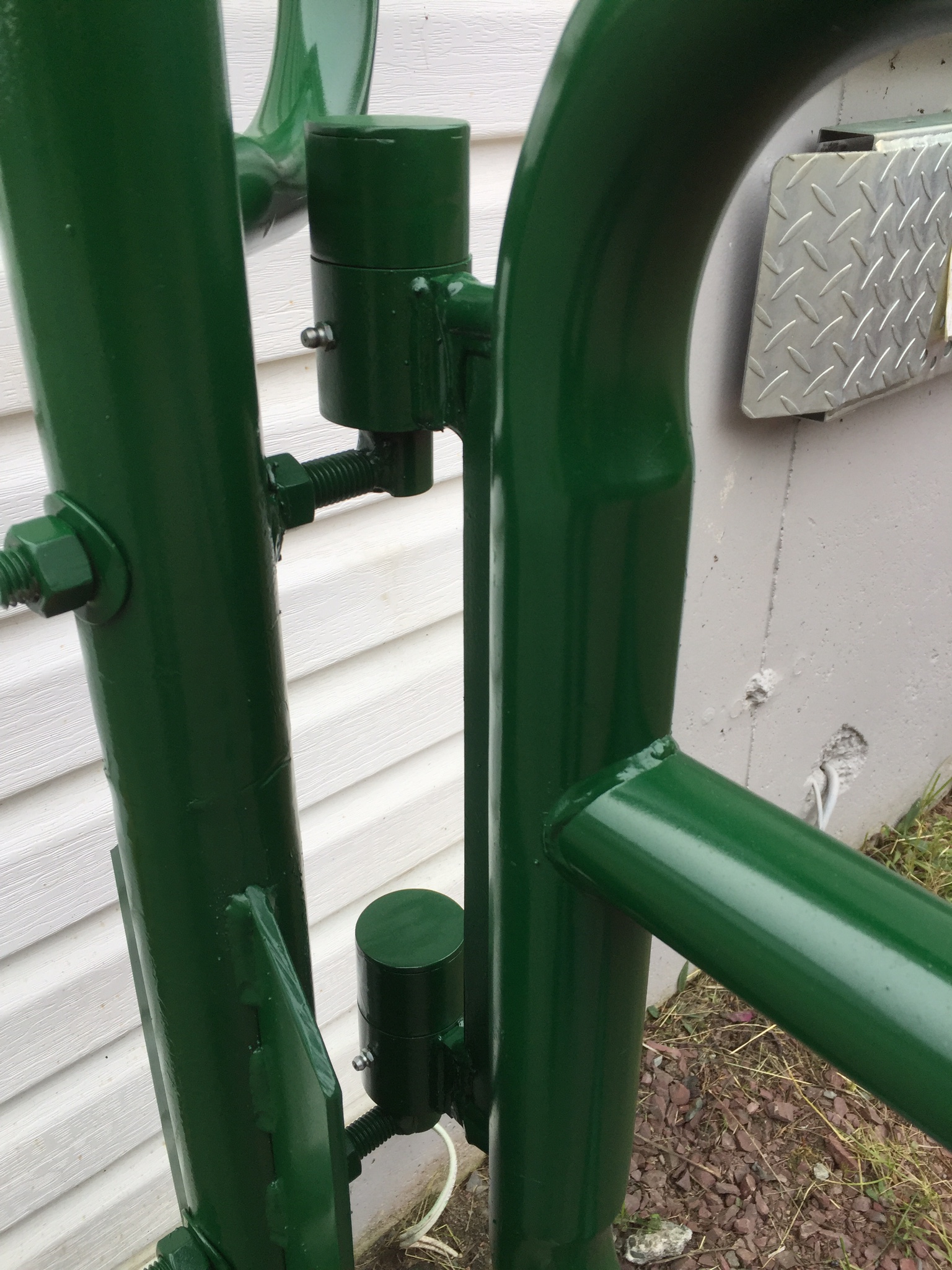

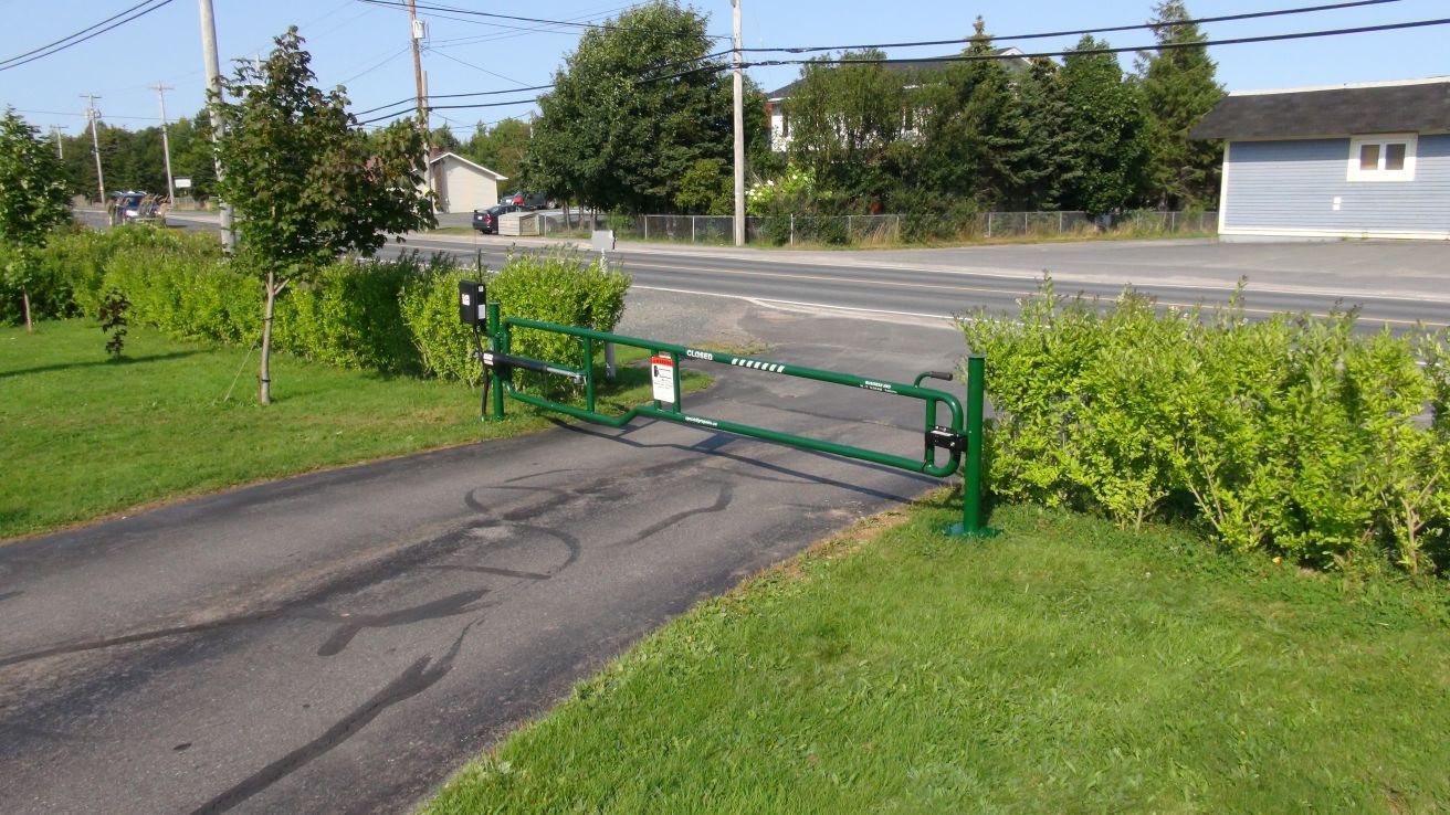

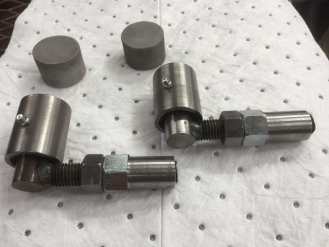

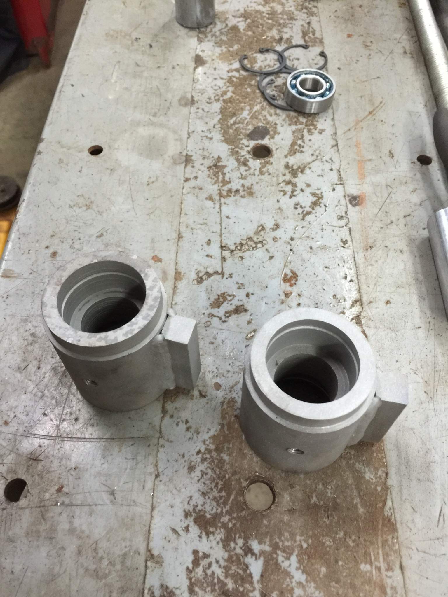

I used those hinges on cabinets that I use indoors. I make my own. Pretty easy to do that if you have a lathe. This summer I put up two new out door gates with auto openers on them and I wanted a hinge that was heavy duty, smooth running, greasable and long lifespan so I build a couple of these. If your gate is really heavy this might be an idea you can use. They are designed so the gate can't be lifted off either. Just something to think about.
Impressive. What's with the two slugs in the third picture?

I have built several gates with that type of hinge , I put the zerks , one facing up and the other down. You cant get the gate off unless you start cutting steel, and as far as sagging , build the post right and secure them correctly and NO problems.

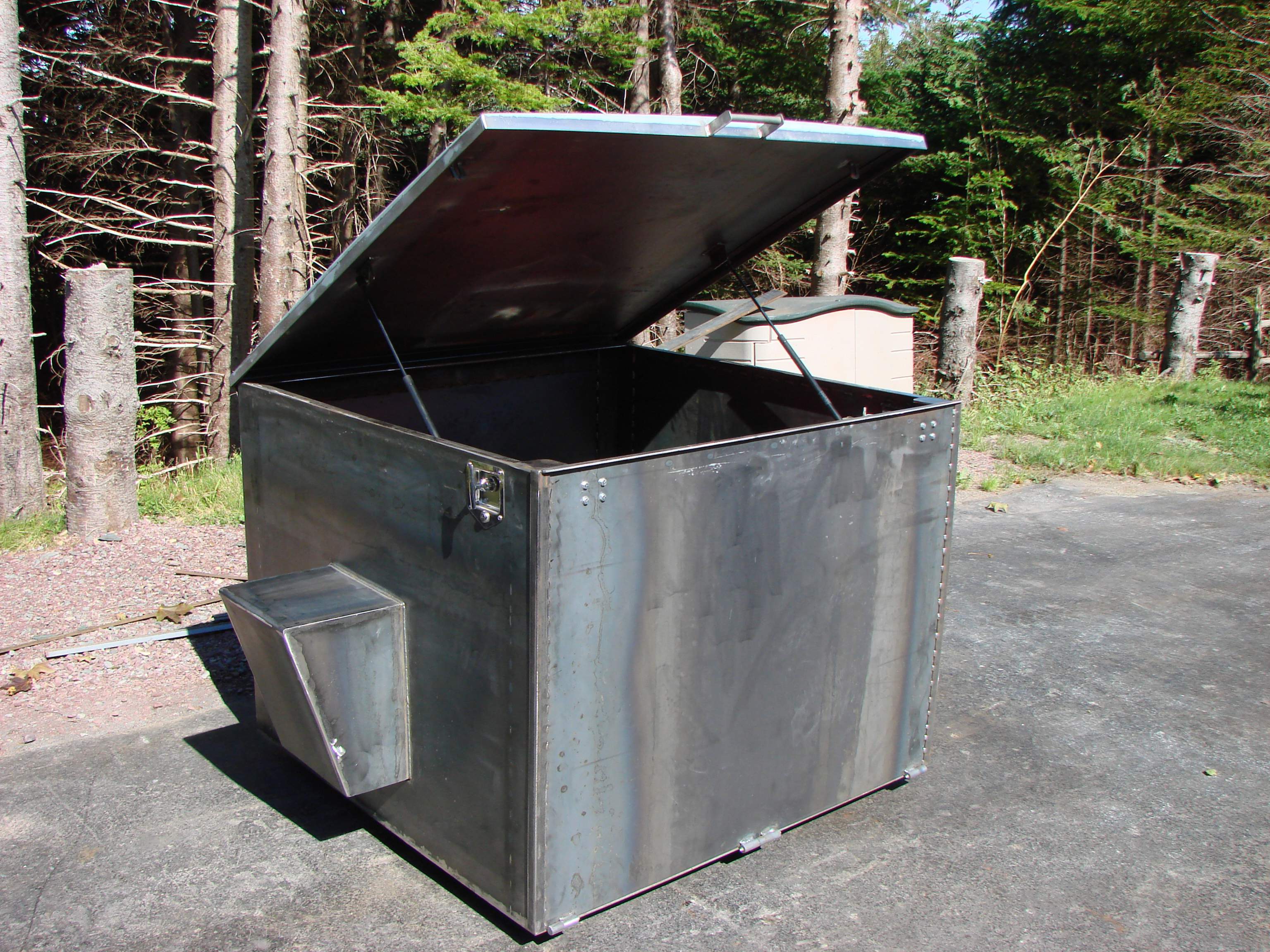

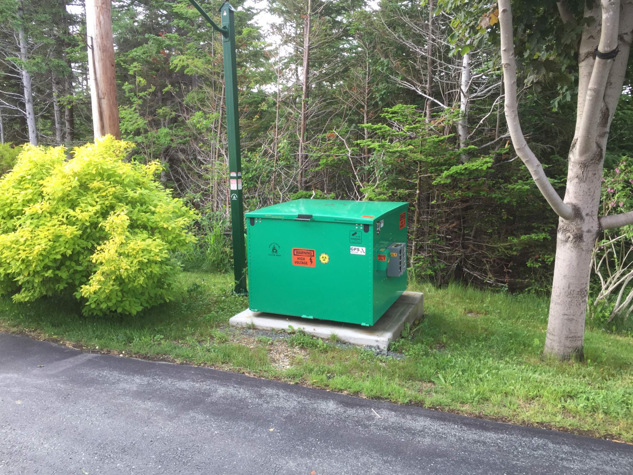

I've also machined weld on hinges as shown in the OP photo. Used them on a generator enclosure I made. Worked well.
