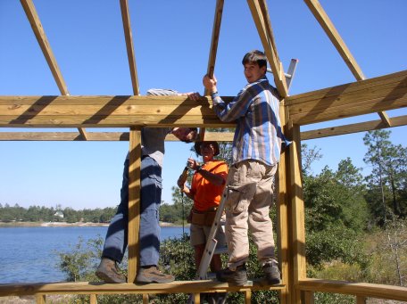

Here's what I did in the air last weekend. The rafter ends are about 13 feet above ground on the downhill side, and the ladder just wouldn't stay outside of them for me to work. I had to bend backwards just to see the edge of the board. Several times I got torqued by the drill driving a screw and had to just stop and look out over the lake for a minute while I convinced myself to continue.

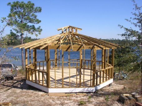

For completeness, here's a different view of the project. If I'd had room on the trailer, you'd see me standing in the FEL in the previous photo. Unfortunately, I had to haul the 2x4s and plywood decking, leaving no room for me to bring my best tool!

That is a great looking gazebo and what a beautiful setting. It looks great and please post pics when it is done. In your climate, you will be able to enjoy it year around. I have to get the other gate drilled and installed tomorrow or I will be working in the snow and ice.
