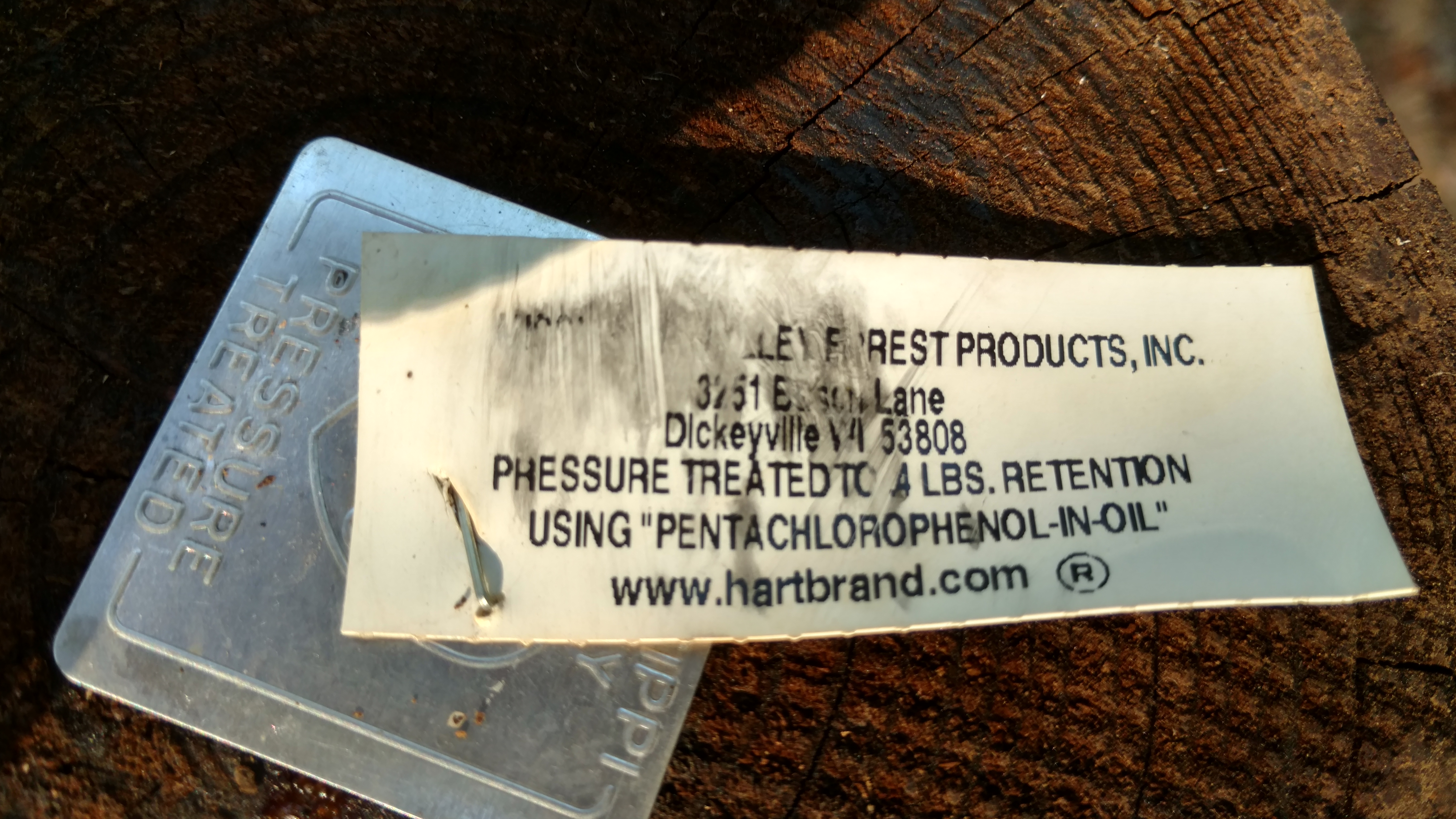

This is the top of the post from the local Farm and Home Supply. I like these posts.
