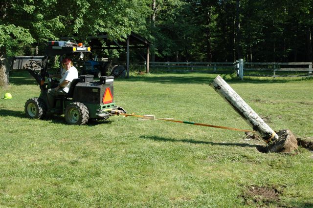

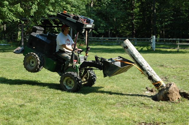

I had little luck removing my own stump, so I took a shot at removing a neighbors gate post. The post was sunk about 3 feet into the ground and had about 300 to 400 pounds of concrete on it. The neighbor had wiggled it with his small SUV but could not get it out. I first thought about using the trencher, but it is in the loft and a little hard to get to. I took the 4 in 1 bucket, lowered it over the top of the post and clamped down. I moved it back and forth and lifted and wiggled from several directions. It came up some, so we dropped an old piece of concrete in the hole to keep it from falling back in. Then I tried pulling it from the back of my 422. It did not go far. I then wrapped the strap around the post and the bucket and lifted and pulled at the same time. The neighbor used a digging bar (not shown in the pictures) to pry some and the post came out. I then dragged it about 600 feet to the burn pile. See attachments.

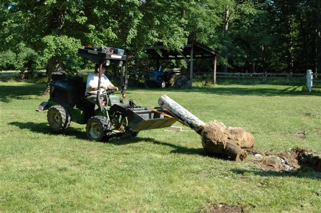

The post supported a gate about 15 feet long.

The camera came out a little late. The pictures were taken by the neighbors wife.

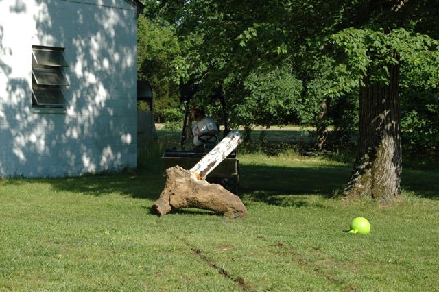

Another shot

Man, I'd be careful getting the rear end that far off the ground! You don't want to end up on your side. Plus the most weight (and thus lifting force) would be with the rear end lower and as far from the front tires as possible. Just my inflation-adjust $0.02. /forums/images/graemlins/wink.gif
   / Gate Post Removal
#9
I agree. In retrospec it looks a little dangerous. It the strap had broken the rear end would fall 2 feet and maybe very suddenly.
