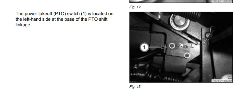

PTO Safety Switch is located.

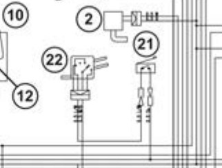

Does anybody know what 22 is in wiring diagram? its referred to as just "Safety Switch" (no, not seat switch) Maybe High/Low range HST switch?.... 21 is PTO safety switch...

my gc2400 manual does not show that exact diagram but since it looks to be dpdt switch (unlike seat, pto switch) I would SUSPECT its the range lever switch.
on my tractor its the only safety switch with more than 2 wires going into it and when the plastic snaps you superglue it into position to allow starting LOL

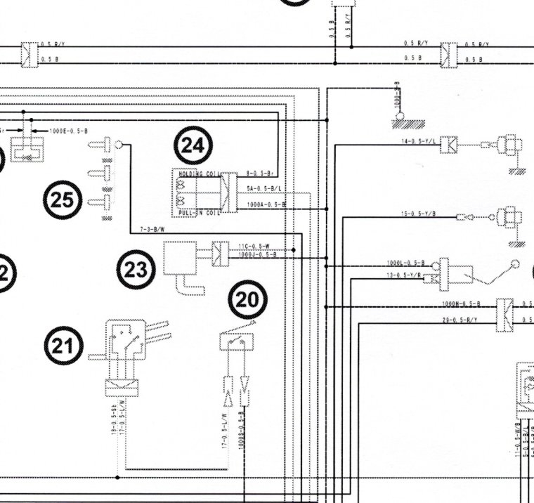

The diagram I have is different. In that area mine shows
2 is labeled 23 = fuel pump
21 is labeled 20 = switch, pto clutch lever
22 is labeled 21 = switch, range gear

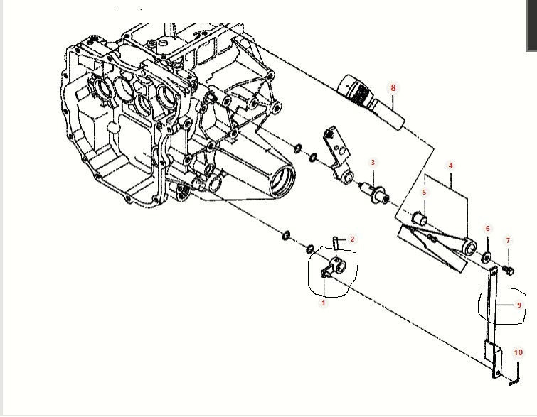

I carefully went through the op manual steps again with the same results. Dave M, I will conduct your test tomorrow if possible. I should note that I can turn the mower and drive shaft (not connected to PTO) by hand with what I believe is the typical resistance from the gearbox and belts and with no evidence of roll pin problem. Referring to the control handle travel, I have not been able to ignore a suspicion I have regarding the linkage of the mid PTO gear shift. I have attached the PTO linkage drawing and circled the linkage (9) which I noted earlier shows evidence of bending resulting from attack from some limbs. I have pushed it back visually straight, but I have been unable to determine if it actuates circled lever (!) correctly. The lever now moves with a detent from about 9:00 to 10:00 position when the midPTO lever is pulled up. Any observations as to this being the correct travel of lever (1). Thanks to all again for the continued assistance!

   / GC 1710 PTO Operation #19
I have not gone under to video actual movement but will try to tomorrow.
I do know it's not much due to mechanical advantage of lever
On mobile right now so can't really examine diagrams. Can say this in gc2400 approx 4 inches from end where both lever tie into under tractor there is rod that runs down to lower end
When moving the handle 3 inches that rod lifts up 1.5 inches and it rotates a lower link up and down approx 1 inch.
More travel on handle gives mechanical advantage
Thing is if that rod got bent it would require LESS lever movement to fully engage
