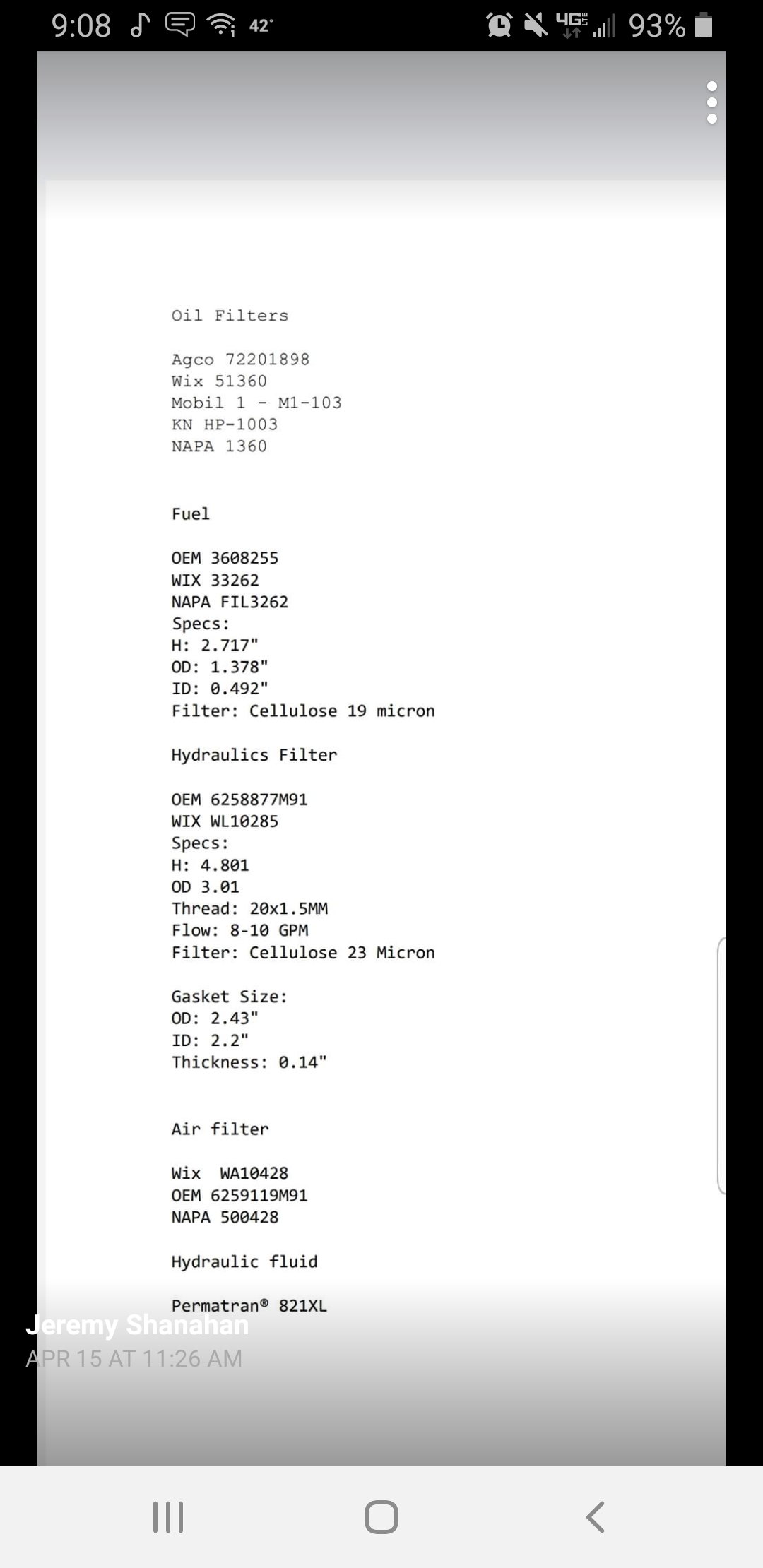

I've always had this sheet with the filter info on it.

I must be missing something from the Wix application listing for this filter #WL10285 because it does not list any MF?

Think you are missing the point of this discussion, it is that the WIX filter (#WL10285) WILL work on a MF even though it is not specifically specified for MF....

I believe there is a Baldwin that also "fits".
It's got to be spec'd in the applications, before most are going to trust it.
Fram has several engine oil filters that "fit" on the GC strictly by the numbers, but they declined to spec, any of them.
They did say they will do that even if it's only because it's outside of the OEM size. They can't make a determination of how much clearance is necessary, based on looking at the OEM filter, and that is apparently as far as they go with it.

Maybe you and some others might be willing to use the Wix #WL10285 filter, but for me I'll stick to the MF #4265229M91 filter and spend the additional $12.77 + - for the MF.
KC
Massey Ferguson 4265229M91 Hydraulic Charge Filter - Jacks Small Engines
versus:
Amazon.com: Wix WL1285 Hydraulic Filter: Automotive
