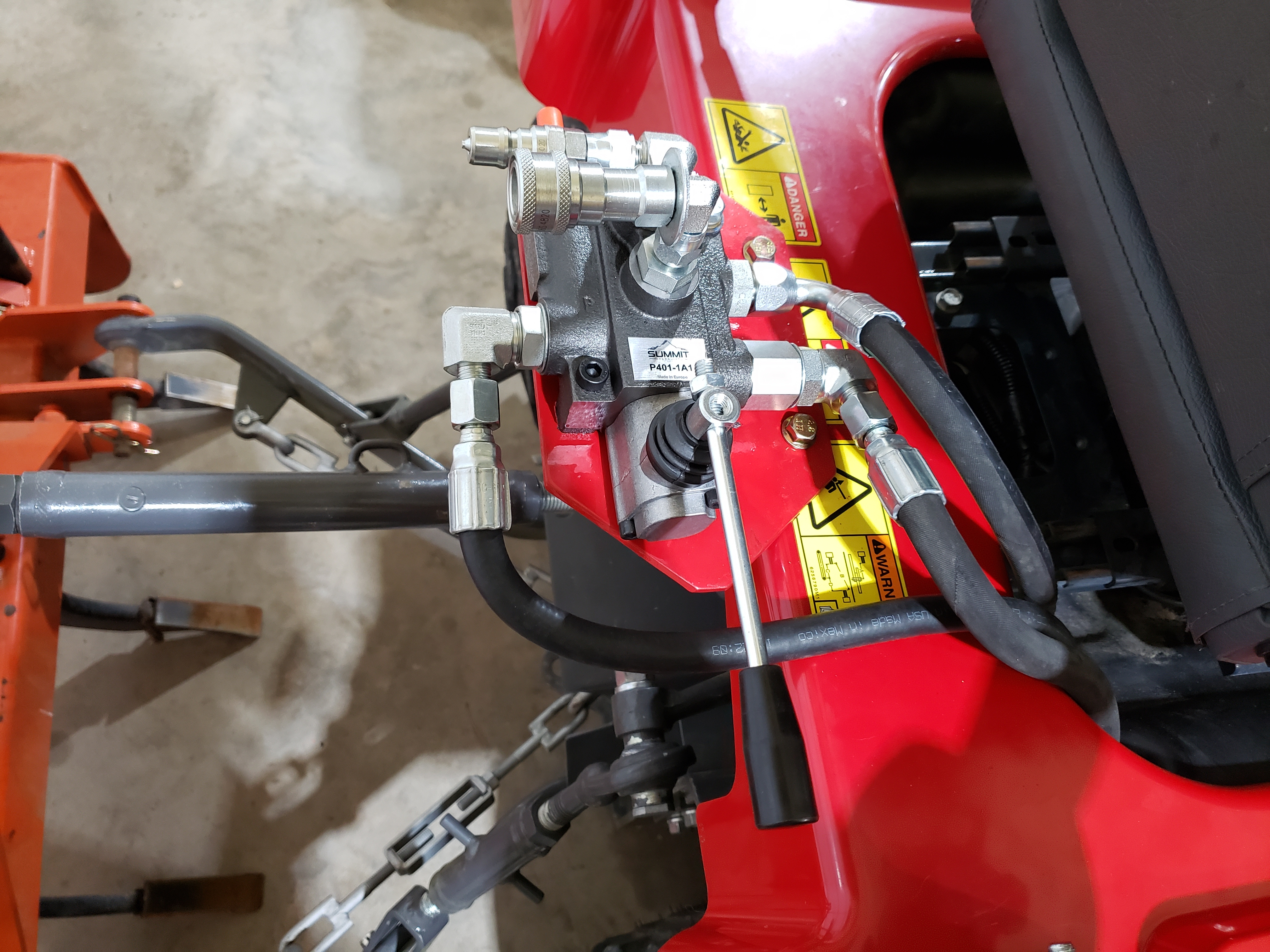

#22

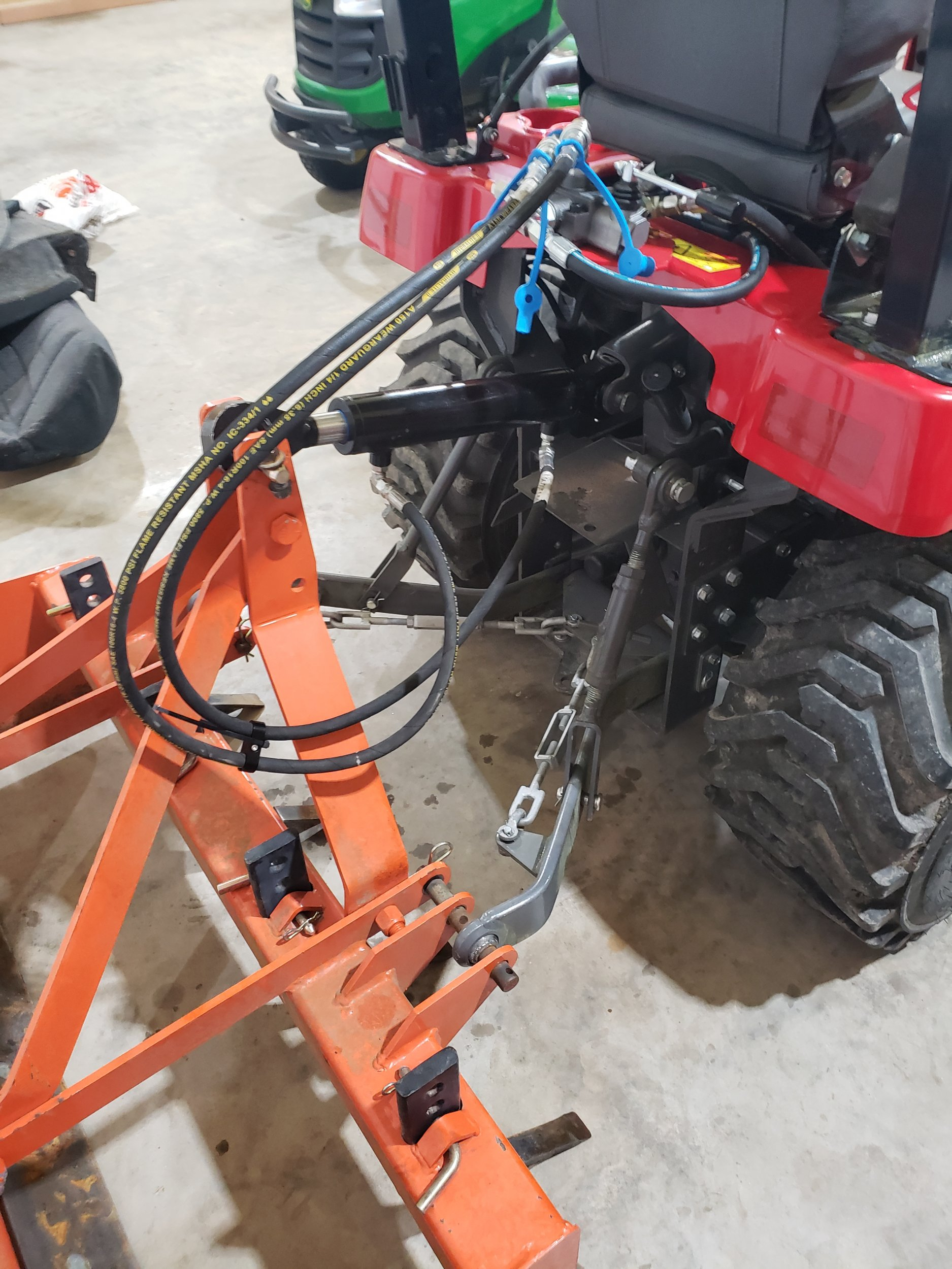

Been busy with other stuff but here is the final setup of the rear hydraulic top link. Hard to document now because i had a lot of hose modifications and experiments along the way. The basics are here, and taking off the rops etc is not absolutely necessary. Better to buy the basic setup and measure for hoses where you want to run them. I can't even guarantee the setup would work for all variants in this exact config also.

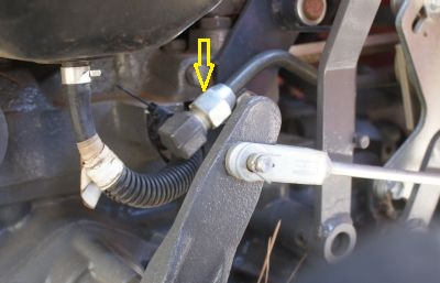

   / GC1705 Project-additional hydraulics #23
Would fitting in pic below by chance be the "Power" (in) to the 3ph from the FEL "Power Beyond" port?
Dale
#24
Dale
No it is not. Pretty sure thats the tank line from FEL valve. The PB line is the soft line i showed earlier in the thread that terminates underneath the front of fuel tank. Basically impossible to get to without removing the rops/fenders. You can just tap into each line underneath the tractor though, i just didn't want extra running back and forth with lines.

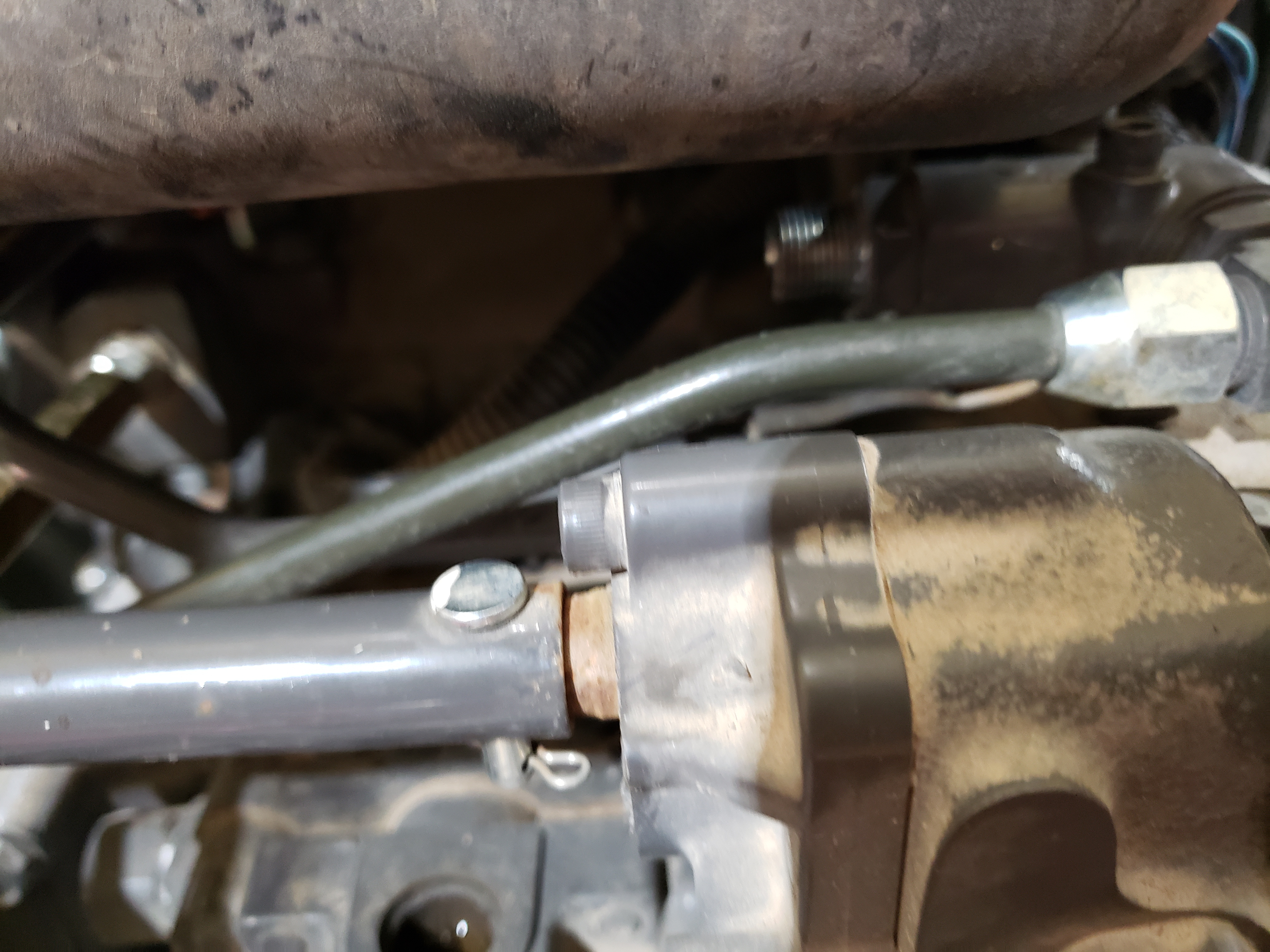

#25
Hard to see but that fitting back there is where the PB soft line terminates. I removed it completely because mine now runs from my top link valve to this spot.
   / GC1705 Project-additional hydraulics #26
Up on further looking I believe you are correct, soft line seems to terminate somewhere under tank where there is no access to it unless one remove all the hardware on back of tractor(seat, body, ROPs, tank)..... Guess one could nipple into it but for now seems sort of daunting since need for PB in not really necessary...... Oh well thanks for the help...
Dale
#27
You dont have to remove the tank. You just have to remove seat, rops, grips and rear fender assy. I did put a 3/8 bspp to 3/8 jic adapter there and ran a new hose, but It would be easier to just series into it underneath the tractor where it goes from hard to soft line. This is especially true when you remove the rops twice because the fitting underneath the seat is the only one that decides to leak out of 13 added on the project.

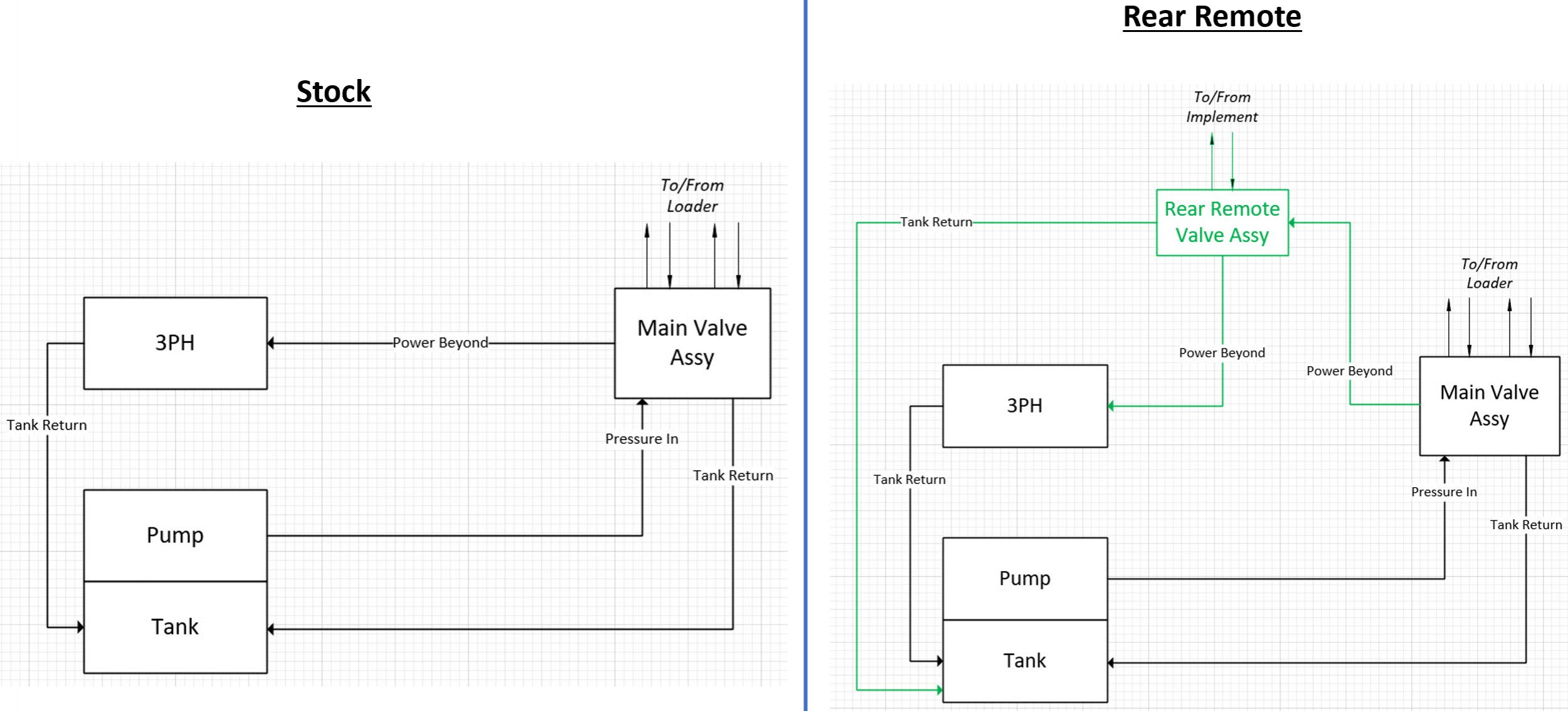

1.) High level system schematic. See attached pictures – just want to make sure I have this right.
The key is that I believe the rear remote should be added in series on the Power Beyond line
between the FEL valve assembly and 3PH. Let know if something is off here.

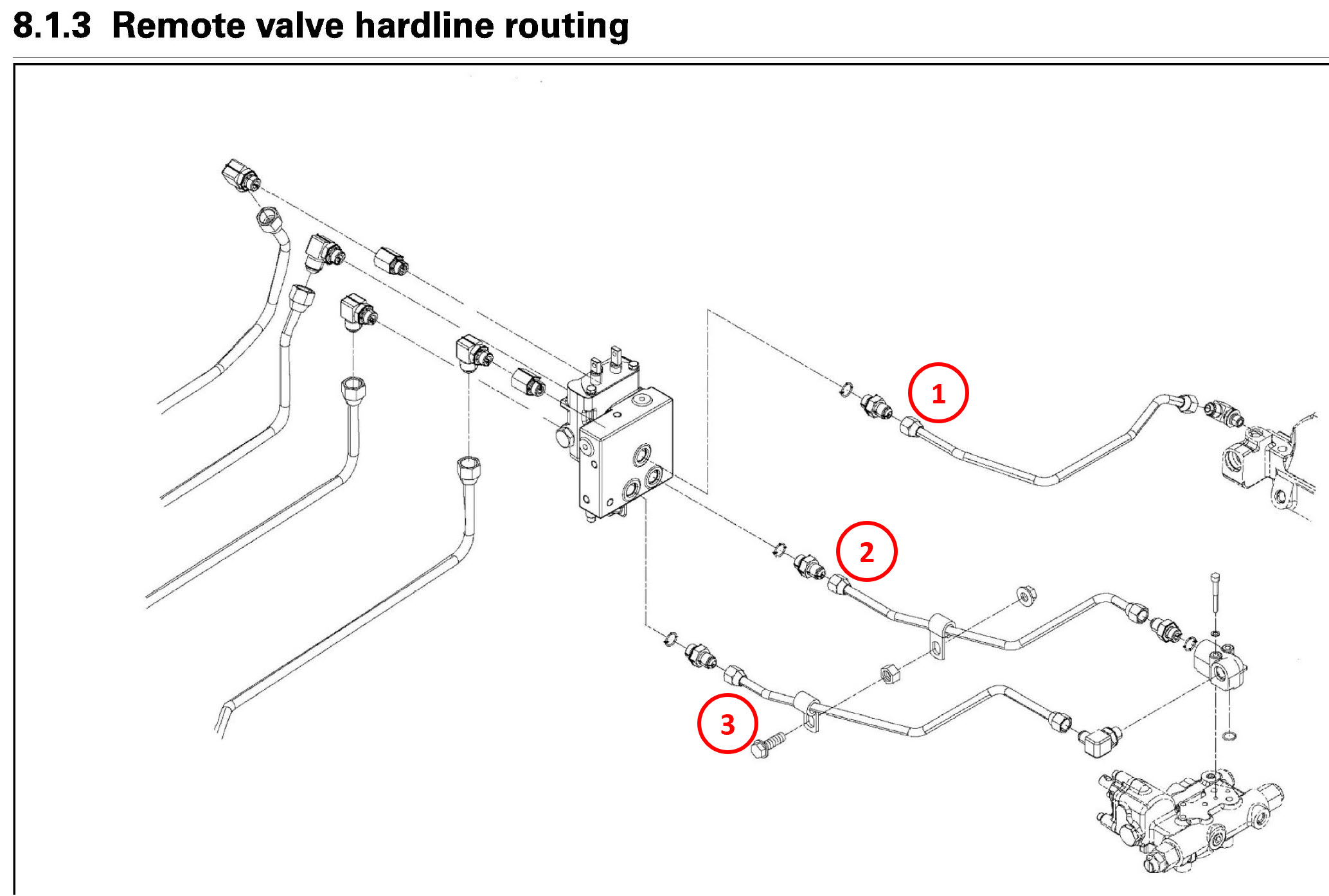

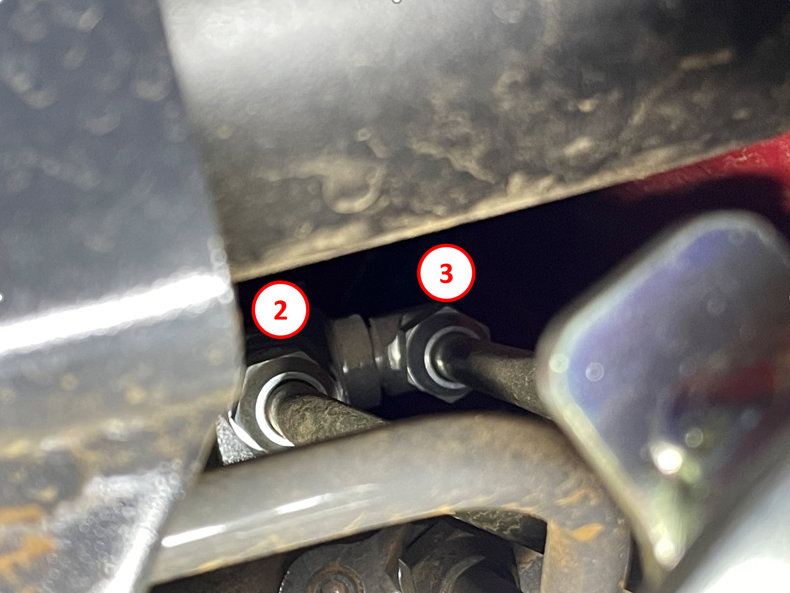

2.) The P, T, and PB lines coming from the FEL are hard-lines (no soft-line connections like in the
earlier GC1700 series tractors apparently). My thought was replace the entire PB hardline and
insert the rear remotes valves in series. The new lines would all be hoses as that would be
easier for me. I’m not 100% sure which line is the PB line as they’re not labeled. See diagram
from the service manual below. Anyone know which one is the PB? I believe it’s #2, but I’m not sure.
3.) Has anyone confirmed whether this port goes to tank? Alternatively I’m sure I could tee into the
existing tank line, but I’d rather go directly here... one less thing to mess with.
4.) Does anyone know what threads the P, T, and PB hard-lines are? Are they -06 BSPP on the 1723/1725 series as well?
