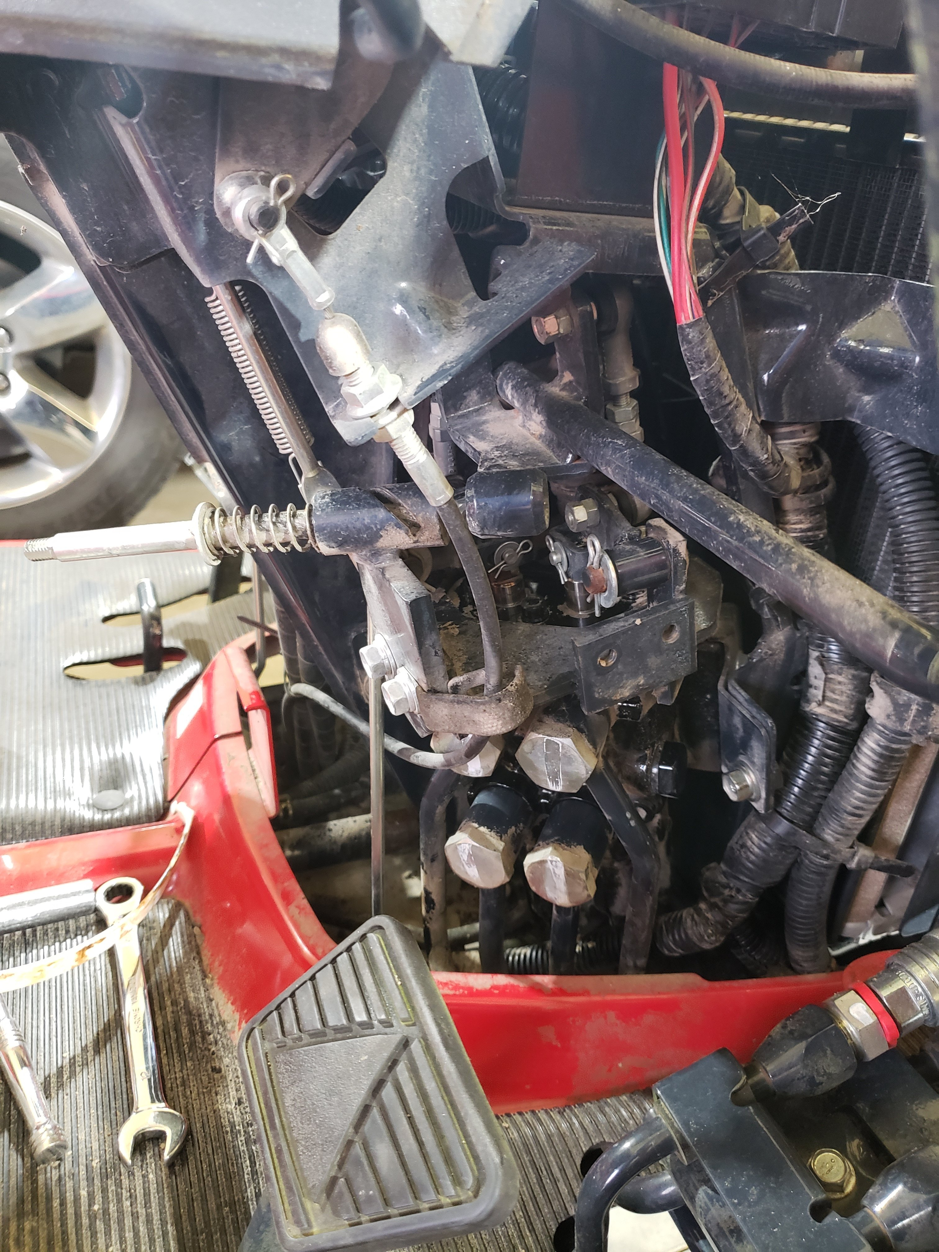

Take a look underneath your tractor. If it is set up like mine you will see the top line in photo (most right line on tractor). It is the one that goes from hard to flexible. This is power beyond from FEL valve and runs to 3ph. I will be tapping into the line here and using the PB of the added valve to hook back up to the flexible line running to the 3 point. I believe there is a cap on the no BH version that can be used as an additional tank return on the right side of the tank or these can be t'd into.
Thanks to Jerry at mytractortools for helping me understand the plumbing.

The loader valve nice and tucked where pb port is near impossible to reach without full removal, hence why tapping into the line underneath makes sense.
The hex plug where I am fairly certain I can use as the return to tank for the additional valve.

Thank you.... I was aware of the three line under tractor, but I did no know what line served what purpose.... Now that I know what line is FROM FEL PB port rest should be simplified (except for access)...

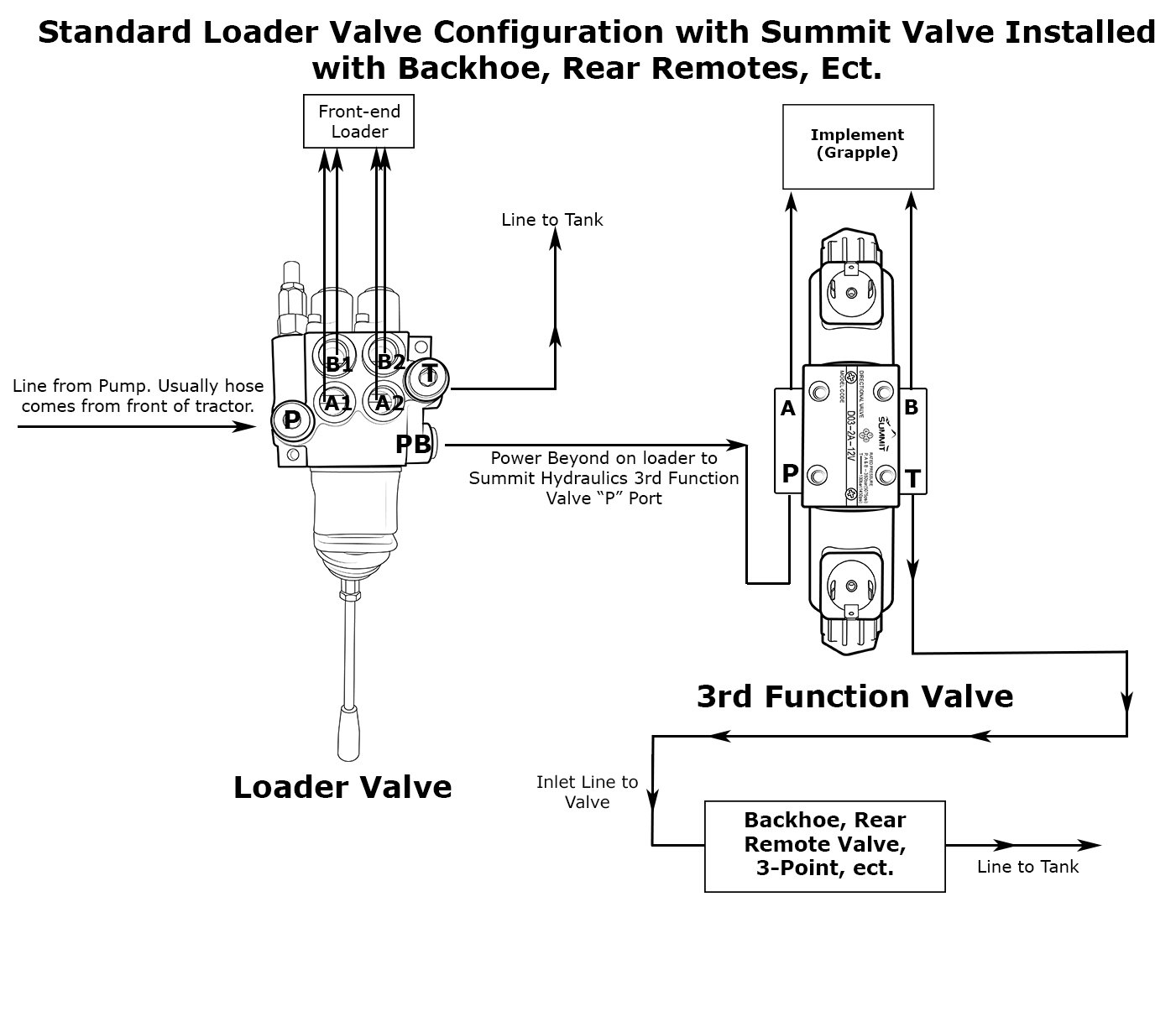

On another note, the valve I am using for the grapple does not have a power beyond port, yet it shows it can be plumbed in series to the next valve using the tank return line. Why is this able to work? I was under the impression that every valve in series had to have a PB and tank return, unless of course it is the last valve in series PB wouldn't be required.

My guess is that it can work for 2 reasons:
1: The return T port is rated for fairly high pressures (3000 PSI) though I would not recommend running more than one of these valves in series.
2: Rather than diverting some flow to PB, the 3rd vunction takes all priority in the system in the moment it is used. So any excess fluid still runs downstream to the next valve but what you get there is all you get, if any. When it isn't being used it flows straight through to the next valve in series which would basically get full PB flow from loader valve.
I could see this potentially being an issue of causing poor performance downstream when the 3rd function is active. In my case, that will only be the single spool remote valve for hydraulic top link and the 3 point hitch. It is not a big deal to me as I dont see myself working the blade and grapple at the same time.
This is all my best guess, but I believe this will work. If anyone can clairfy the reasoning for the lack of PB on the electrically controlled valve that would be great.

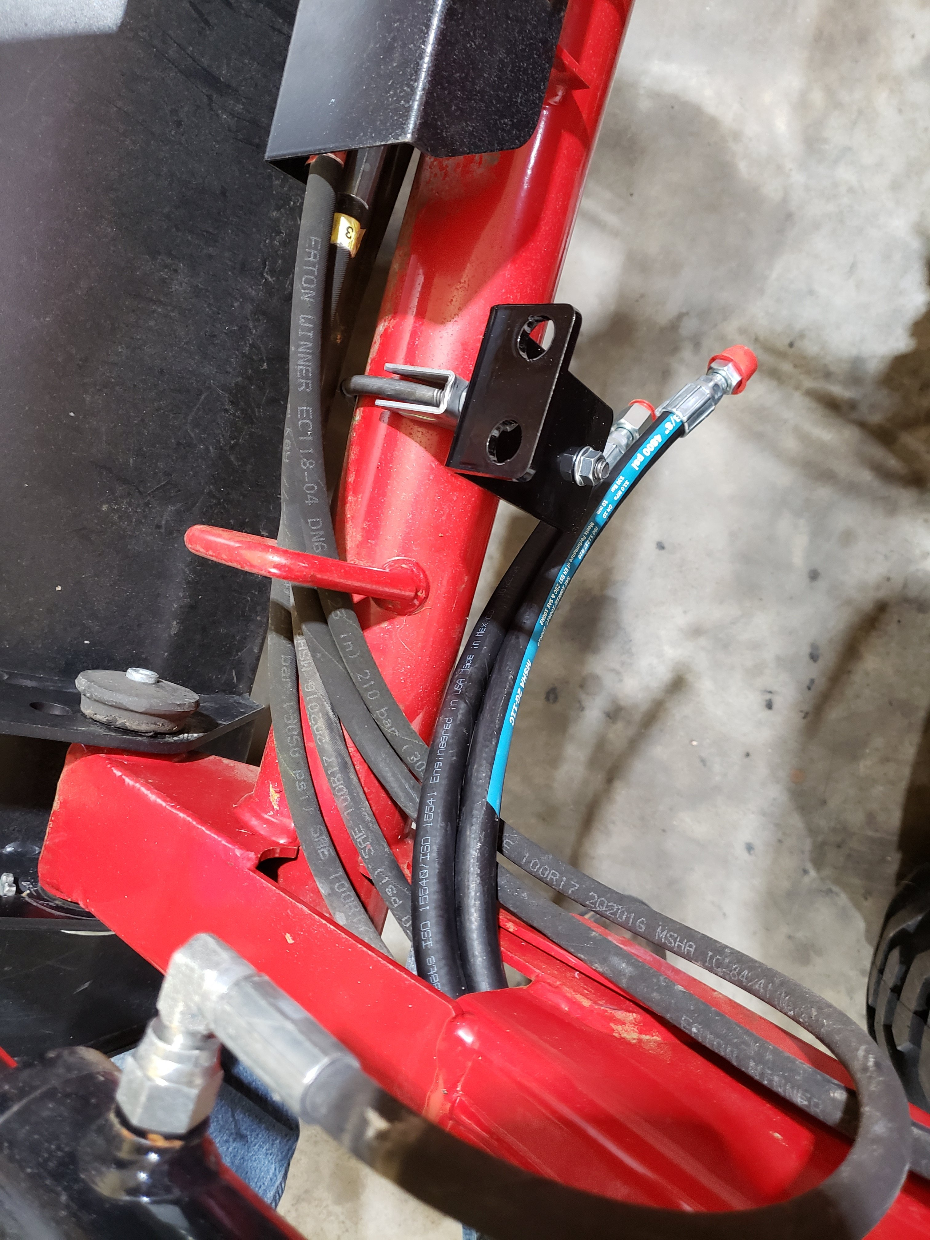

Confirmed today that the soft line runnig from the hard fel power beyond is all female -06 British standard pipe parallel threads, or BSPP for short. Where the soft line meets the 3 point to feed it from FEL, there is an adapter (male to male) to allow the female hose connection to attach.
If you wanted to add in only a 3rd function valve this would be pretty easy. Get 2 hoses made with 3/8 jic females (summit kits use jic for their solenoid valves), one female 3/8 bssp x 3/8 jic male adapter, and one male 3/8 bssp x 3/8 male jic. Basically tapping into the power beyond line where soft line meets hard.
The TFK1 kit for Kubota from Summit hydraulics would work perfect if they could provide it with 2 feet longer on each fel hose. I had 2 made exactly 2 feet longer than the provided hose and they are pefect, so i ended up with extra hoses. The 2 used for tapping into the PB line will be a little longer than necessary, but very manageable. Adding an extra valve for hydraulic top link changes a bit for me, but atleast i am able to use some of my extra hose.

I really dont know why the aftermarket doesn't make a kit for these....once you know the connections this really isn't bad, especially if you were JUST doing the 3rd function. I only took off the rops and fender to completely remove soft line so i could run straight from top link valve PB to 3 point.
Even that only took 20 minutes. Most daunting task is pulling the grips off levers. I found that giving them a good twisting motion back and forth broke the glue and i could slide them off. Maybe i should kit out a 3rd function for these and amazon/ebay them 🤔.
