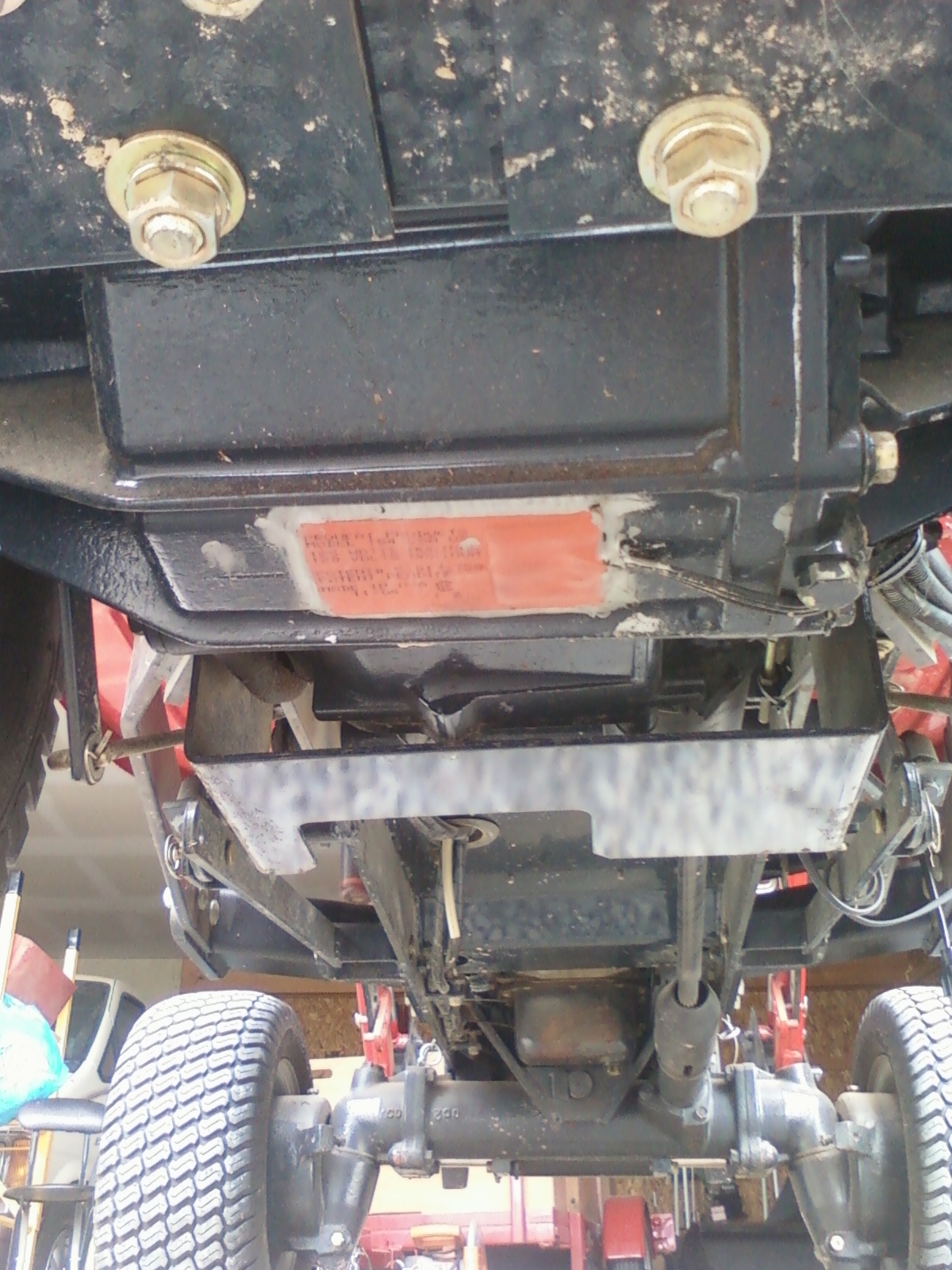

Here is a picture of one installed. Maybe it will help.
   / GC2300 OEM Trans. Filter Skid Plate
#36
That's the aftermarket filter guard.
I believe he has the original equipment one.
I didn't even know there was an OEM version, but glad I got the one from RetailRems because it protects the HST fan.
