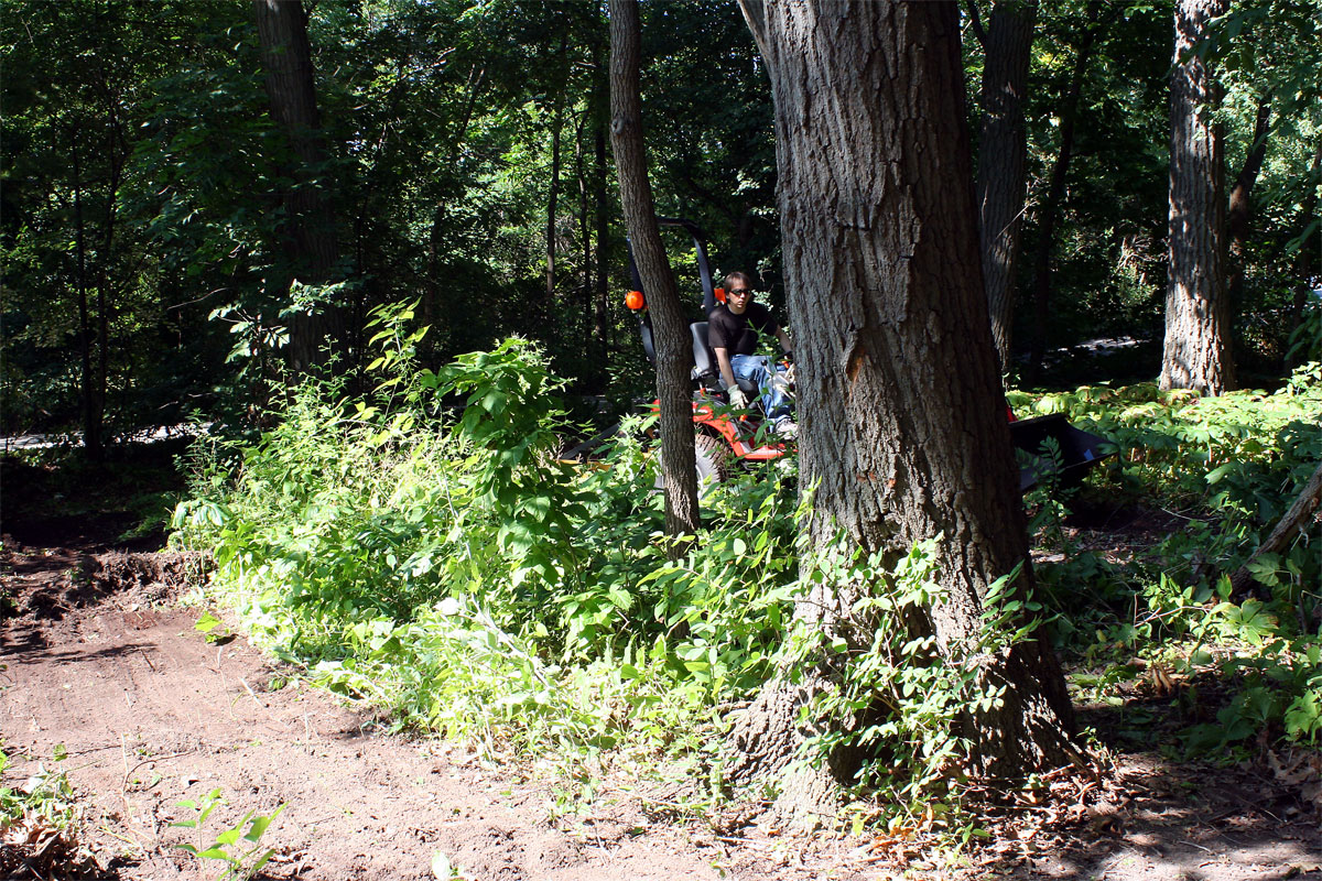

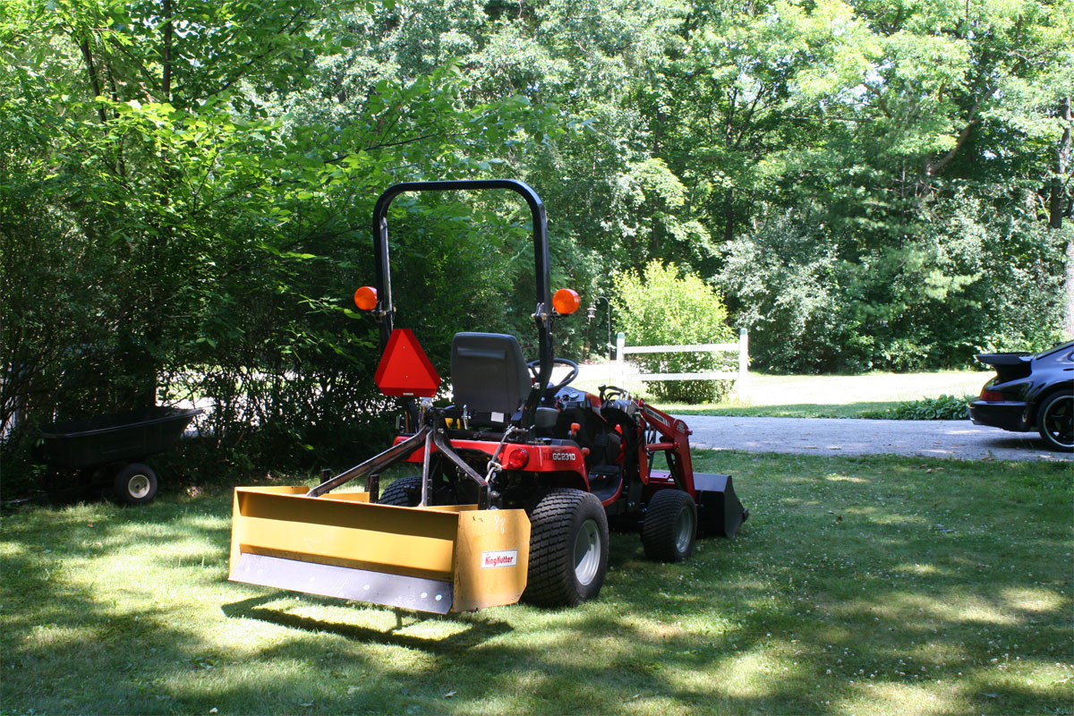

   / GC2310 Pricing
#38
Well I got about 6 hours in today. I started to clear about 1 acre of heavily wooded land to make room for a new garage. I was mainly using the box scraper and the FEL. Worked really well. For this I wish I had the AG tires, but all in all worked better than I thought.
No Back Hoe work done today, I did tear up one stump with it the other day. about 30 minutes of use. I need more practice with it. :)
I also mowed about 1/2 acre today and I wasn't blown away by the mower. I guess my JD GX345 was a great mower as the MF did about the same. The JD wasn't driven by PTO so it was quieter, the whine in this mower is actually a bit much. This is my first experience with this type of attachment so I was actually disappointed in the load whine. I am running about 2100 rpm. Maybe it takes a little getting used to it.
One big disappointment was after the BH was sitting all day in the garage I went to re-hook it up and I saw a drip... turns out one of the lines running down the boom was dripping pretty good. I will look tomorrow and see what exactly is going on, I have about 9 hours on the machine and the BH has only been used 1 time The leak is in a place where there are no pinches etc... weird. I hope the dealer will warranty a line for me.
Had the loader off and back on today, that was easy to do. Mow deck is easy know that the shaft coupler is freed up.
