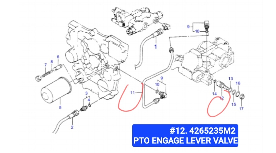

Oil level went back to middle after starting it and curling the bucket. Both FEL and 3 pt were down.
Oil was clear driving, using FEL, and 3 pt lift.
I put the deck on to cycle it. Engaged PTO for about 15 seconds. Checked fluid. All cloudy with heavy foaming layer at top. Engaged another 15 seconds and it was all foam.
Drive back into garage. Lowered both FEL and 3pt while it was running at idle. Fluid cleared in about 1 minute.
Was at middle level.
I turned off the tractor and watched the fluid level drop to below the eyeglass.
What's up with this? Do I have a vacuum somewhere?

yes to both, top off then test with deck on. fwiw I use little red dye to easily see in glass and trace leaks.
Good call on adding some die. Definitely going to get some. I did test with deck. Still foam.
My most recent post explains the fluid level.
It's at middle with FEL and 3pt down. I shut it off. Then the fluid in the glass drops below the sight. I've never seen this happen before.
I've never read about it happening either.🤷

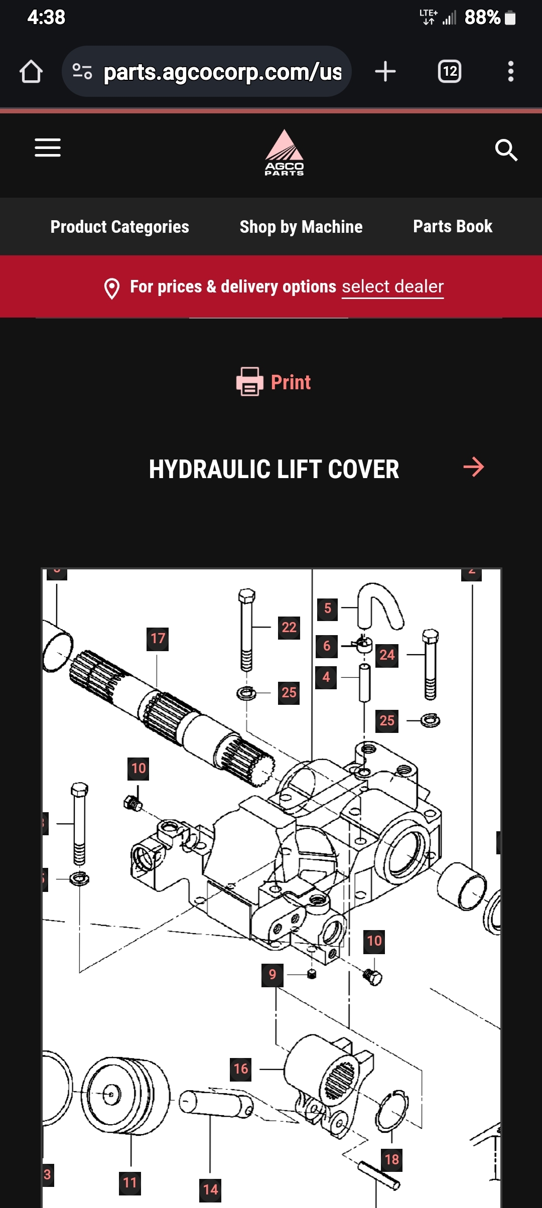

Something doesnt seem right.
It's never done this before.
Tractor is at idle.
It's setting level with FEL and 3pt down.
Hydro level is at middle.
Turn off engine and level drops below glass.
I have released any residual on both. I actually disconnected all of the FEL quick connects.
When I start the engine, oil level immediately returns to middle.
Turn it off, drops back down. Where's the fluid going? Is there a pressure relief valve not opening?

Is the foam from the PTO gears turning in the oil? If pump was cavitating it would be happening all the time and not just when PTO is engaged.
I know that running the PTO on both the BX1850 I used to have and 2400H I currently have heats the oil up more than just driving around without PTO engaged.
