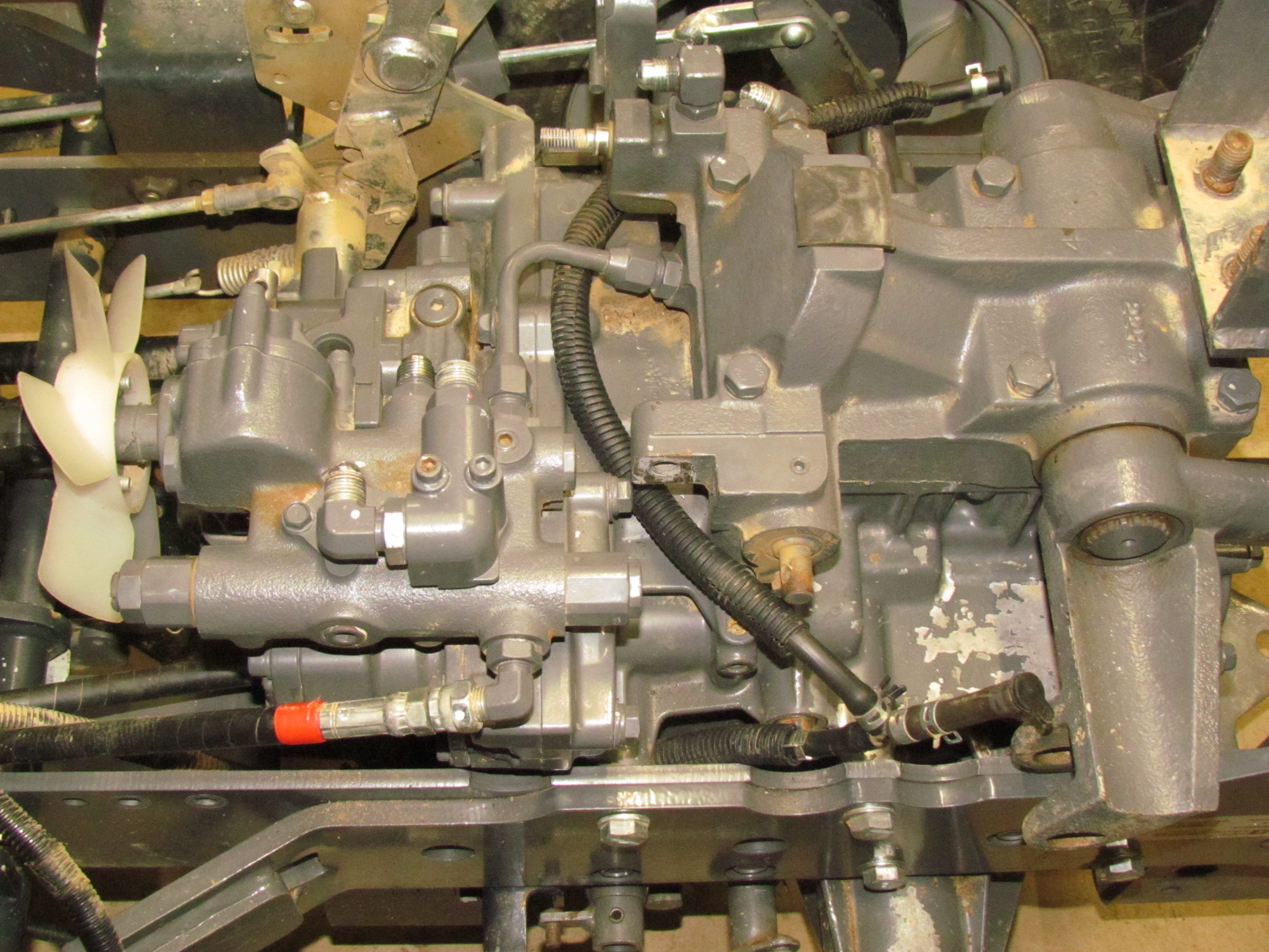

The PTO engagement valve is lever operated. Seems to be a rotary valve. I'm looking at it now. I fully engaged the lever, then disconnected the arm that connects to it.
So when lever is fully engaged, the valve is open as far as it can. And when disengaged, the valve is closed as far as it can be.
I have looked for an actual picture of the valve, but couldn't find one.
Here's a photo of the PTO valve on the later model GC.
To answer your other question, a quart does seem like a lot of oil to drain out of the hydraulic filter, but I don't remember for sure.
Someone asked whether the PTO gears are always turning or not; I believe that they always turn when the PTO clutch is engaged, but they just rotate freely on their individual shafts. They only turn their respective output shafts when either the mid or rear PTO levers are engaged (i.e., I think that engaging the mid or rear PTO levers connects the gears to the shaft).
BTW, on your older GC, you can actually open up two windows on the left side of the transaxle and the shift forks for the two PTO's will come out. Don't know if you can get to them though with the transaxle inside the frame.
