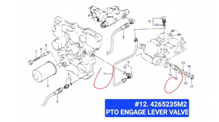

Is the foam from the PTO gears turning in the oil? If pump was cavitating it would be happening all the time and not just when PTO is engaged.
I know that running the PTO on both the BX1850 I used to have and 2400H I currently have heats the oil up more than just driving around without PTO engaged.
It only foams when the PTOs are engaged. I'm not for sure how the PTO gears work inside the transmission. Are the PTO gears under pressure?

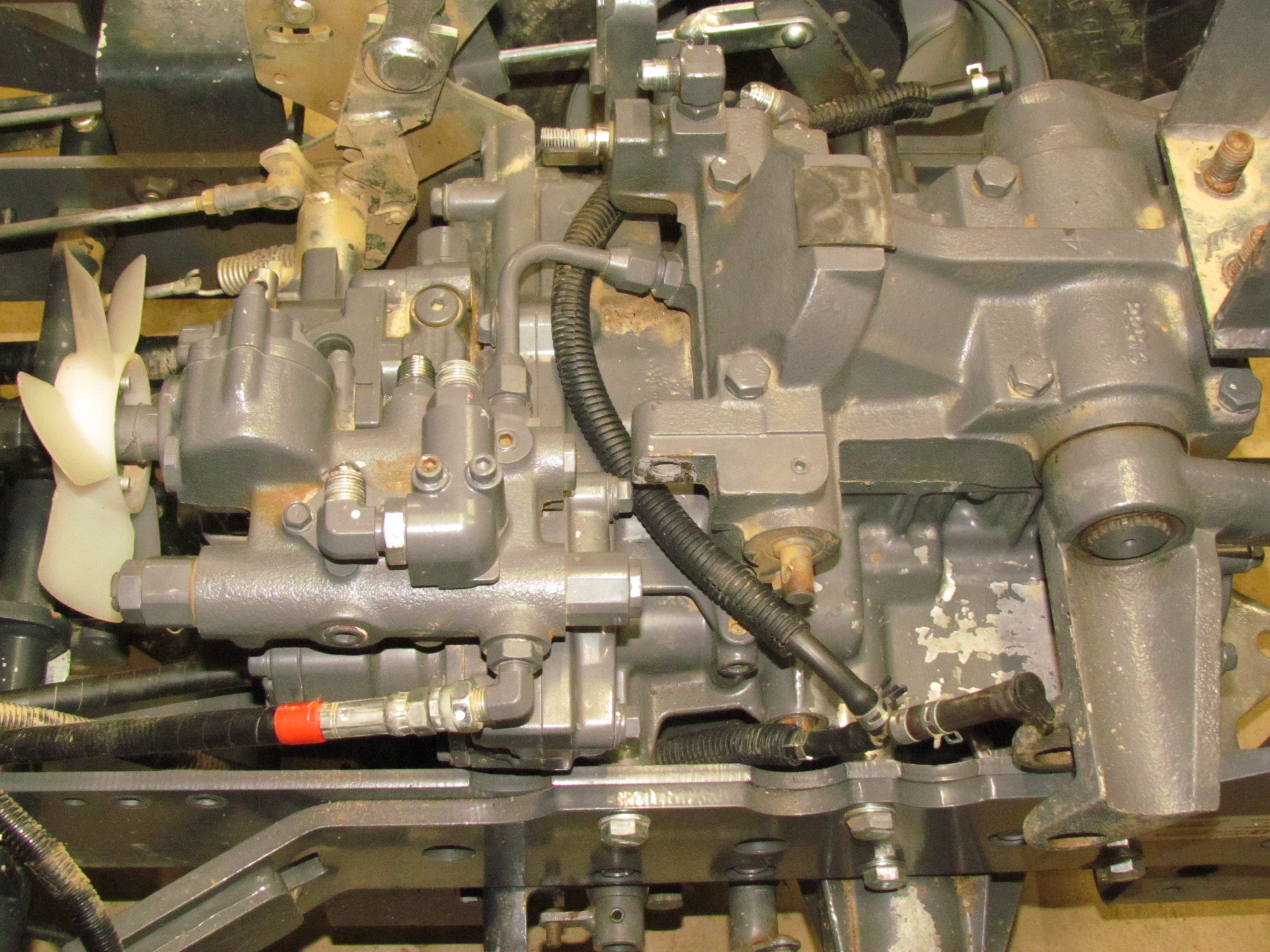

But the steel line #11 that connects to the PTO engage lever constantly whines. Almost screams. Whether engaged or not. The line isn't kinked.
Could it be blocked? Could it be related? Could it be the pressure relief valve? Or PTO valve?
FEL, steering, and 3pt lift cause no foam.
Could be the PTO relief that is unstable causing vibrations in steel line. That could change with engine RPM, fluid temperature, etc.
Could it be blocked? Could it be related? Could it be the pressure relief valve? Or PTO valve?View attachment 3613818
Try driving at full speed for a period of time with PTO off to see if oil shows any signs of foam. Reason for this test is to see if gears from transaxle may also aerate oil at full travel speed operation.
I doubt hydraulic problem since only happens with PTO spinning.

Now I'm curious about the line to the PTO valve and your description of the noise it makes. That can't be right. Does that line get warm to the touch quickly? That would certainly make me wonder what's going on in there.
   / GC2600 whining gone, then came back #29
I am curious If the PTO relief is unstable would that steel line resonate? That would kind of explain working then quit but don’t explain why it became unstable. Also not sure if the PTO relief is constantly unloading a little flow or more of a pressure reducing valve maintaining a preset pressure to PTO circuit. Either way could be unstable..
   / GC2600 whining gone, then came back #30
I'm not at all familiar with that tractor, but many similar systems pipe return oil from the steering circuit through a pressure reducing or regulator valve maintaining 200 to 300 PSI. That flow is then used to supply hydrostat charge pressure, PTO, any other clutch packs or low pressure functions. I'm really wondering what's going on in that circuit?
