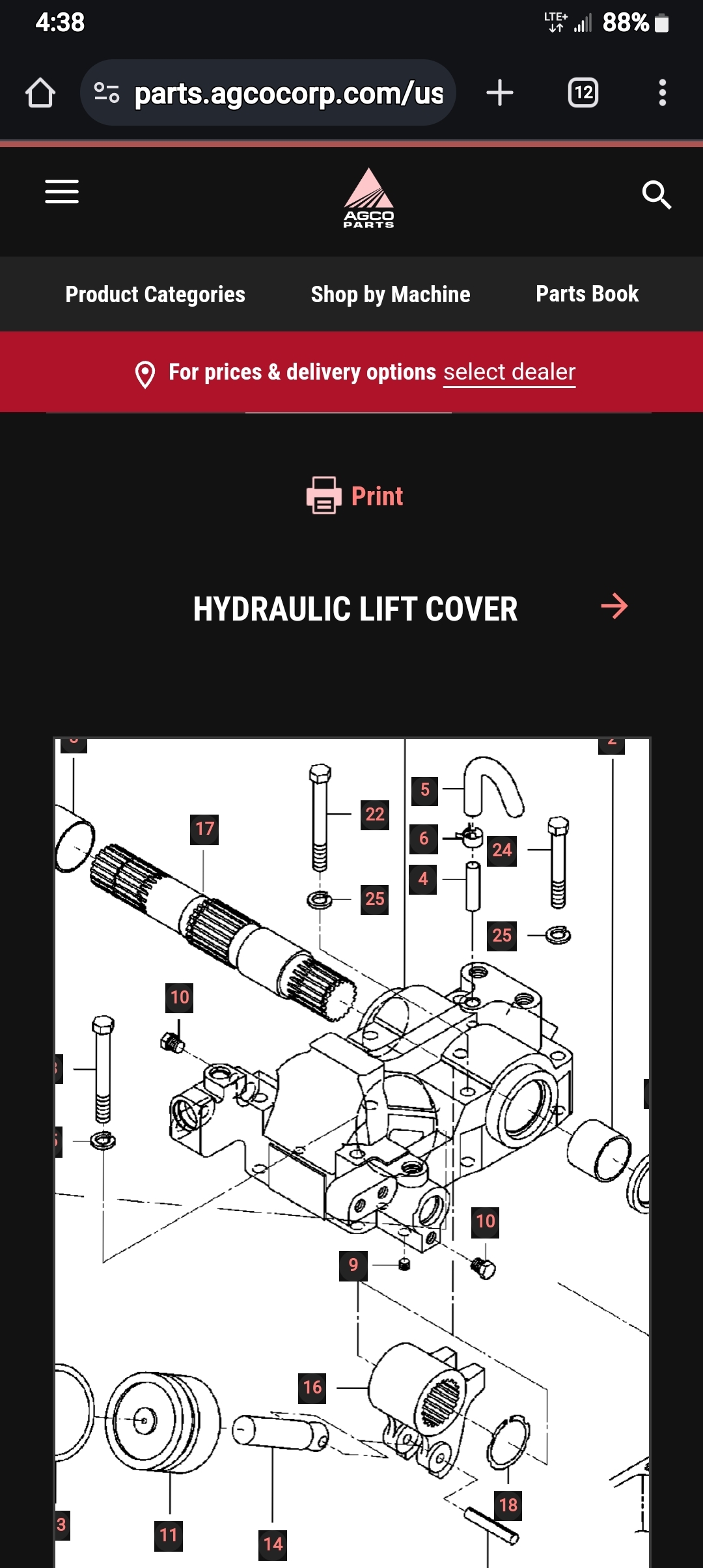

A shot in the dark. I see on the parts diagram:
#9 4264757M1 SCREW PLUG
#10 3758117M1 SCREW PLUG SEAL
Both where the steel line and the PTO valve connect to the hydraulic lift cover.
What are they? Are they under pressure?

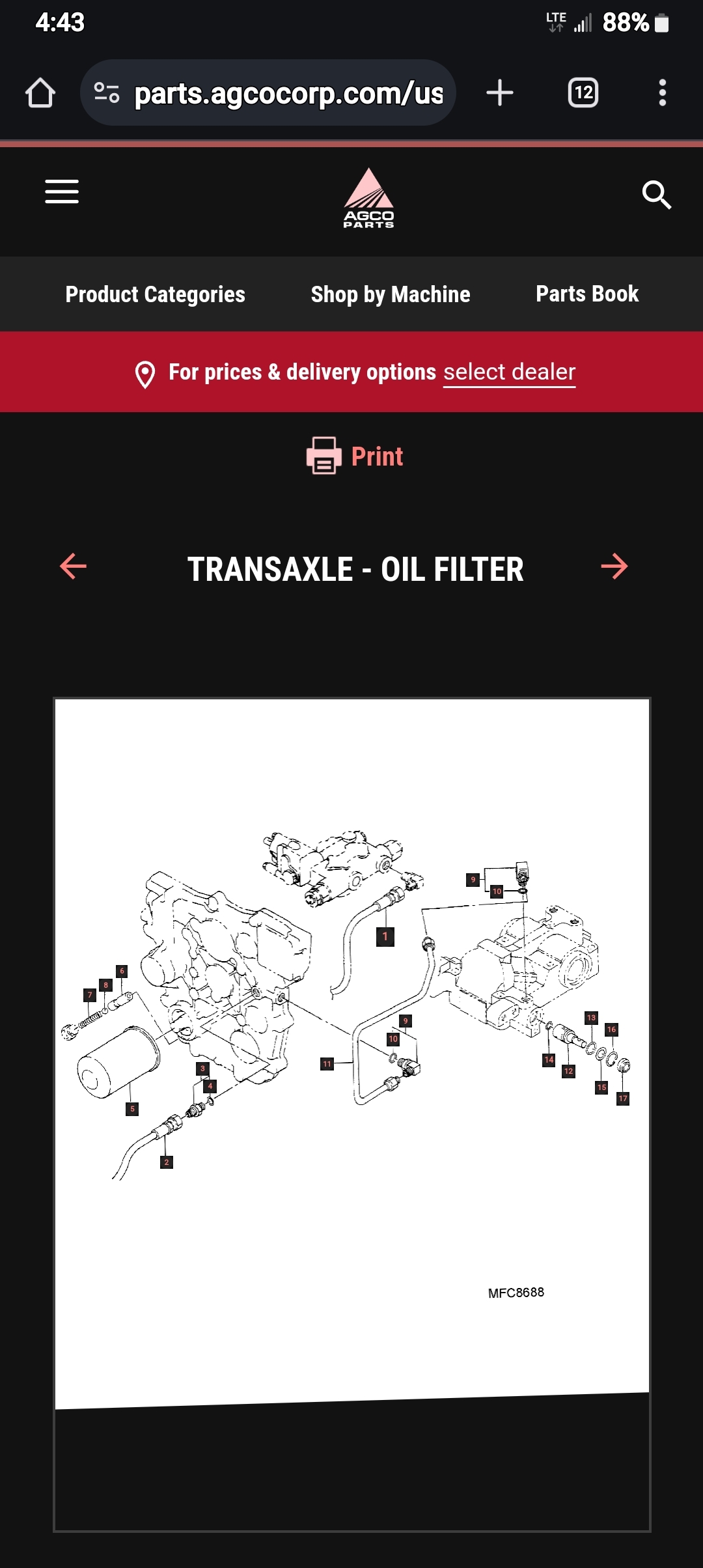

I do not see what looks like the PTO relief or charge relief in either of those screen shots. I suspect that the PTO relief maybe part of the PTO valve assembly but am not certain of that.

The PTO relief valve is items #6-8 on the diagram.
Items #9-10 are fittings/seal. They are always under pressure but that should be limited to about 79psi by the PTO relief valve, which allows the fluid to return to the sump via the hydraulic oil filter.
This is fed from the return from the steering valve.
