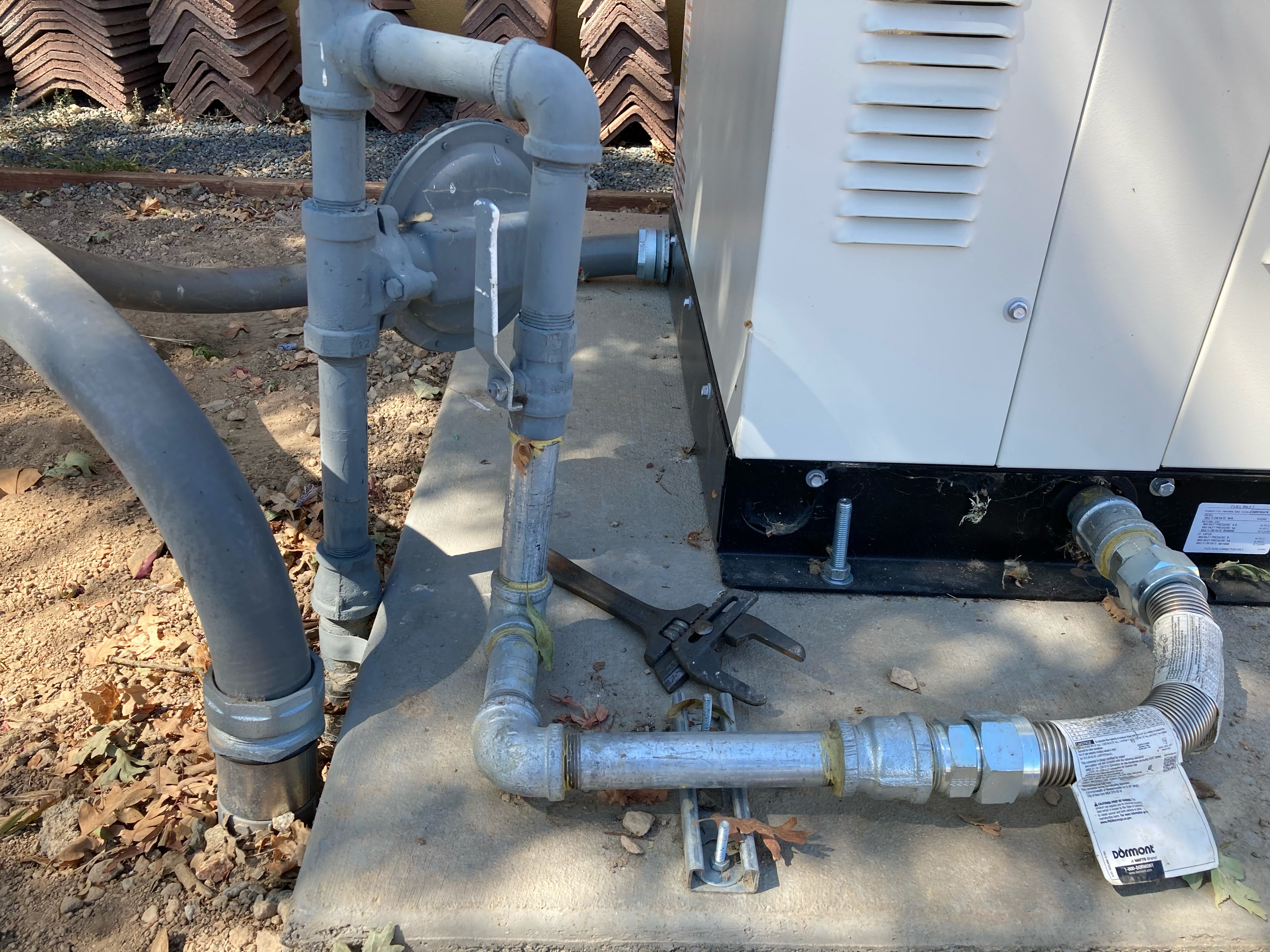

Update:
I had a look at the installation today and a couple of things to share.
One, the required pipe is inch and a quarter NPT, and the underground pipe is that. But coming out of the ground, the installer reduced it to one inch NPT to feed a second regulator (gas to gas) in the midst of this one inch pipe. (Honeywell 1813, available in 1 1/4" ) and then through four 1" elbows and about three feet of pipe before feeding it into the 1 1/4" inlet on the generator.
Second, there is, of course, a second regulator, liquid propane to gaseous propane, at the propane tank. It is specified as being able to supply the necessary 240cu.ft./hr that the generator needs. There is about ten inches of 3/4" NPT pipe at the regulator.
Third, apparently the generator initially started up ok until they added significant load to it, when it started surging. Many tech visits since have been unable to fix it, and other errors are / were being thrown.
I have no idea what either regulator is set to for pressure. Any suggestions?
Is it possible that the undersized pipe or second regulator, or both, would cause the surging issue?
All the best,
Peter
   / Generac 48kw generator: DOA, Generac unable to repair/not helpful #30
all propane installations use 2 regulators. a primary one at tank that allows for high pressure and another at generator that drops pressure to meet generator requirements. that unit needs a 2nd regulator that can provide up to 605,000BTU of fuel and the unit has to allow between 7-14" water column of pressure at start up and running. this level is not supposed to fluctuate more than 1" on the meter. do you know weather anyone actually used a manometer while starting and running?. if there is a surging issue i can almost guarantee its a fuel issue. personally i see so much wrong with that picture, its amazing. generac recommends at least 10 feet of 1-1/4" pipe between regulator and generator to allow for a storage area for fuel to assist with start up. second, i do not see any type of a drip leg to protect system from contamination. third, that looks like galvanized pipe which is not supposed to be used on gas systems (need black iron pipe. galv pipe can create flakes of galv coating entering system among other stuff), and the instructions clearly state to not bend the flex pipe, and to not attach flex pipe directly to the generator feed. you need to cross reference regulators to see if they can handle the huge load that unit puts on system.
an d one last thing....but very important. did the installer reconfigure the unit to run on propane. i have run into this problem before, on both the liquid and the air cooled units.
i just looked at a 48kw installation manual, and the chart specifically says no pipe smaller than 1-1/4" no matter what the length of installation.
