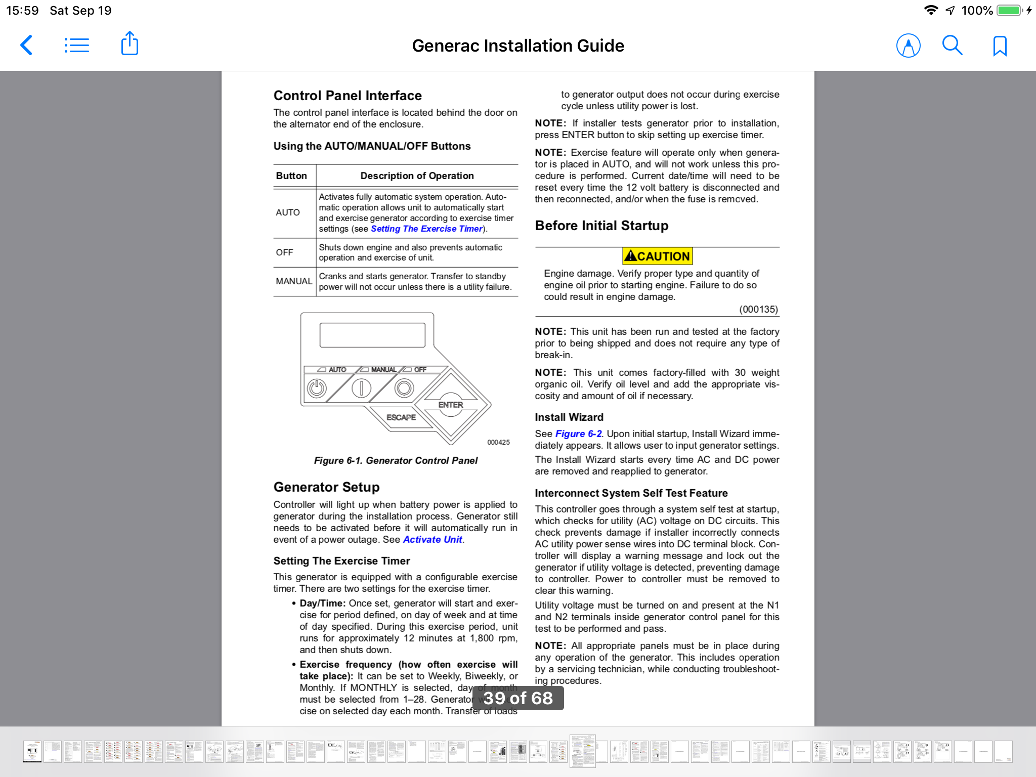

There are clearly a few issues with her installer's actions. Thanks for helping to identify them.
Also in the photo is that there isn't five feet of pipe from the regulator to the generator, as also suggested in the installation manual.
All the best,
Peter
   / Generac 48kw generator: DOA, Generac unable to repair/not helpful #42
On the photo i posted there is an object labeled JET PORT KEEPER. this is the place where the propane jet is stored. Its supposed to replace the natural gas jet. This photo id copied off of the installation manual for a current model 48kw generator. I took the image from generac site. So i dont know why you cant find it on your install manual.
#43
I don't know what to tell you. Newer model?
Figure 6-1 in her manual is the keypad layout for the computer controller.
No mention of jets anywhere in the manual that I can find.
All the best,
Peter
