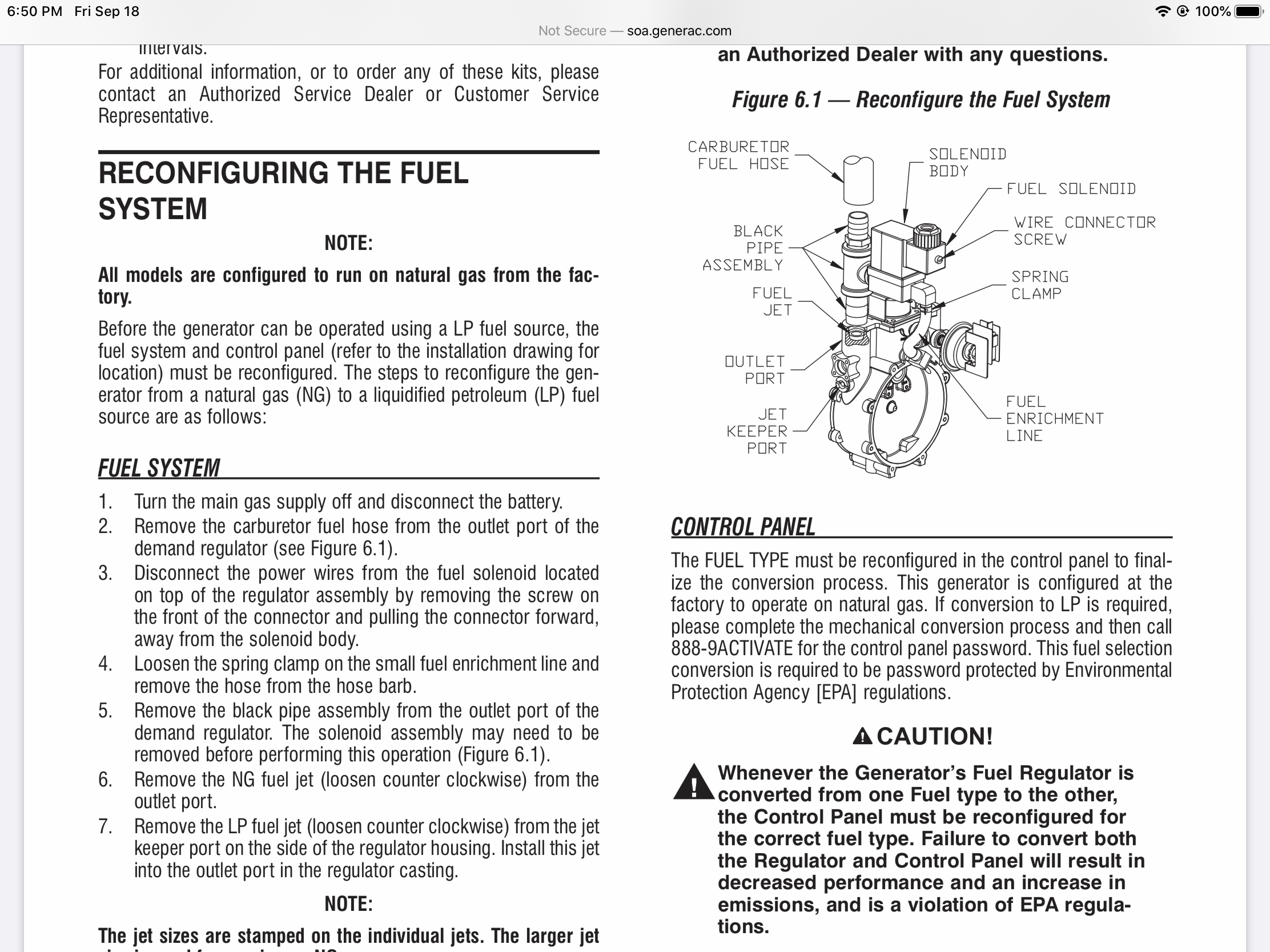

an d one last thing....but very important. did the installer reconfigure the unit to run on propane. i have run into this problem before, on both the liquid and the air cooled units.
i just looked at a 48kw installation manual, and the chart specifically says no pipe smaller than 1-1/4" no matter what the length of installation.
Awesome! This is really helpful.
So, I did check the regulator specifications, and the two regulators that have been installed can supply the 250cu.ft./hr / 605,000BTU/hr., if they are adjusted properly. Like you, I am suspecting not.
I had the same suspicion on the piping. Can I ask how to check whether this was configured for propane? I don't have the installation manual for this unit.
I will try to find out if the regulators were adjusted under load.
Thanks!
All the best,
Peter
   / Generac 48kw generator: DOA, Generac unable to repair/not helpful #34
The propane jet should have been attached to the side of the carb. The unit is shipped always preset for natural gas. Installer has to swap ports. 86AC90C9-C111-461F-ACD9-8420CD2A6FF6.png. The only thing is i dont recall if the propane jet is smaller opening or a larger opening than the natural gas. Been years since i set one of these.
Also, the controller has to be reset thru the dealer portal to function on propane. The installer, if generac certified, should know how to do this.

FWIW: Natural gas has a lower energy density, so it needs jets that are almost twice the diameter of propane.
The owner's manual makes no reference to changing jets on the fuel conversion for this generator. (RG04548ANAX) Is it possible the newer models don't require jet changes? I will have a look on the exploded diagram of the carburetor.
Given everything else that has happened with this install, I certainly worry that the wrong jet could be in the carburetor.

No, all liquid cooled units are shipped set for natural gas and need to switch jets for use on propane. Than the controller has to be set to propane under the dealer menu. I helped install a 45 kw kast year, had to switch jets. That page i posted a few links up is from installation manual, not owners manual, for a RG04845ANAX.
Hmmm...I downloaded the owner's, and the installation manual for her serial number and there is no mention of jets in either manual. New feature?
