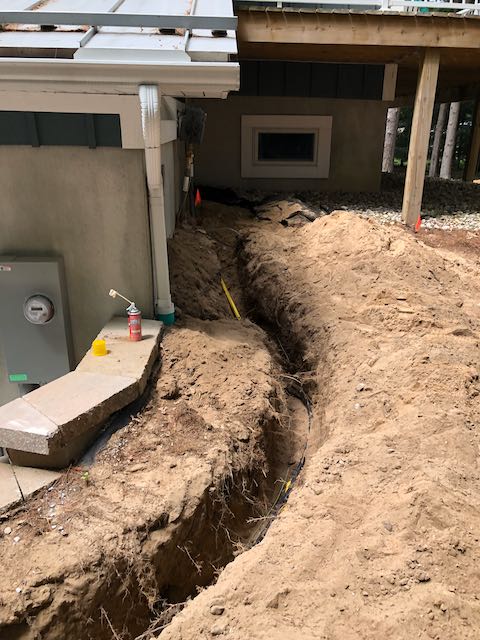

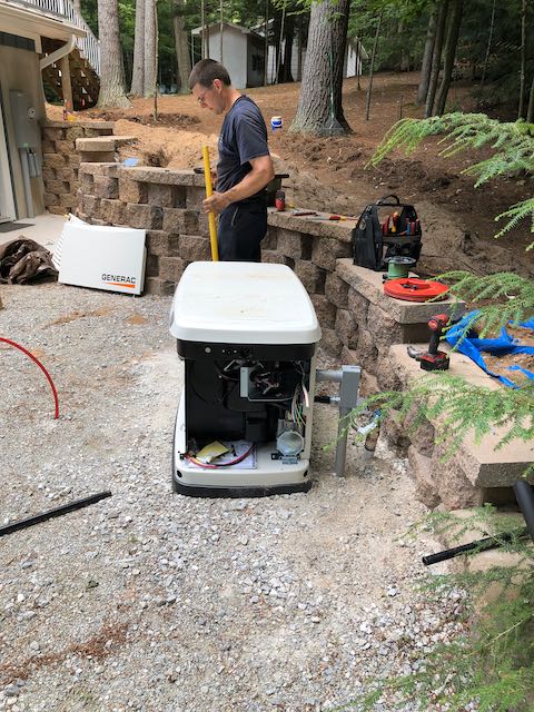

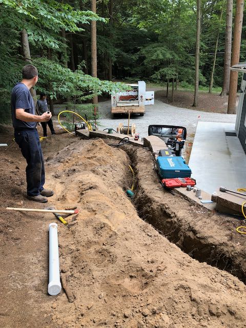

I bought from northern tool, 22k unit with battery and oil warmer and $200 rebate card. Came with 10 yr warranty but w/o transfer switch as my 400 amp transfer switch was installed when I built. Free shipping. Had local generac dude install it around $2k He is 6 miles away.

~$2,300 to be closer. Because I put it in three years after I built I needed to pull another electrical permit and final inspection (glad to have it inspected). Connecting to the Propane, Electric run all buried, hand dug, drilled through the wall of the house. Professional installation and activation was required for the 10 year warranty.
Sounds like you have done this before and have experience with all of the installation requirements here so yes, I probably paid too much.
