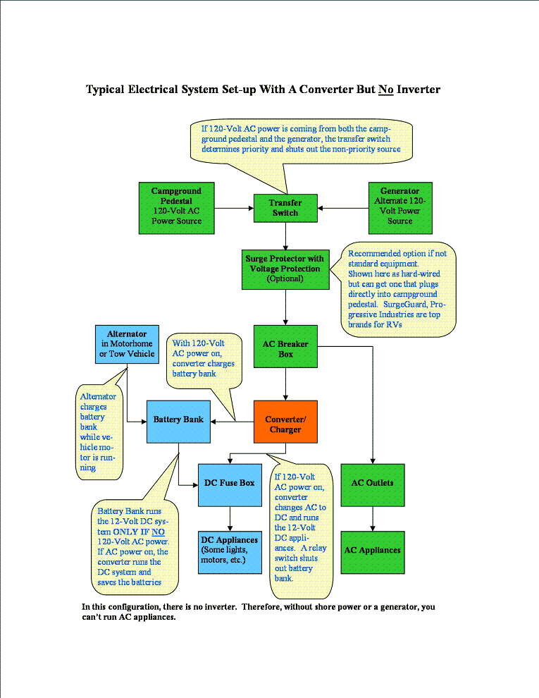

As a side note to backfeeding the house...I'm just curious as to why my motor home is factory built to backfeed the 5K generator back into the coach using the AC source cord with no transfer switch, just a closed circuit. If it's so dangerous to do that, why would Gulf Stream design it that way?
This has nothing to do with the grid, obviously....I just noticed some saying this was bad for the house in general.
This is a typical rv system.. your transfer switch is in there somewhere,,It's totaly automatic as Airstream is very high end,,
Also if the airstream is not plugged into the utility to begin with, it cant possibly backfeed. And if it is plugged in it cant run power from the generator. This is NOT a residential structure that is constantly :plugged" into the utility.

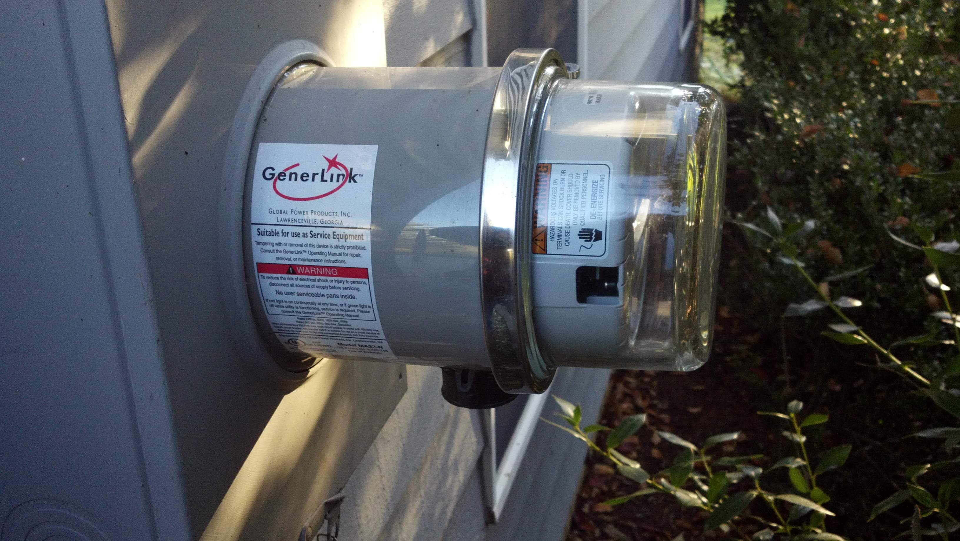

Or look into using a Generlink.
www.generlink.com
I have 400 amp service. This will not work for me. Good idea otherwise. One problem I have heard is that it will not connect to the generator if the utility is working. There is no way to test your connection. I may be wrong about this.

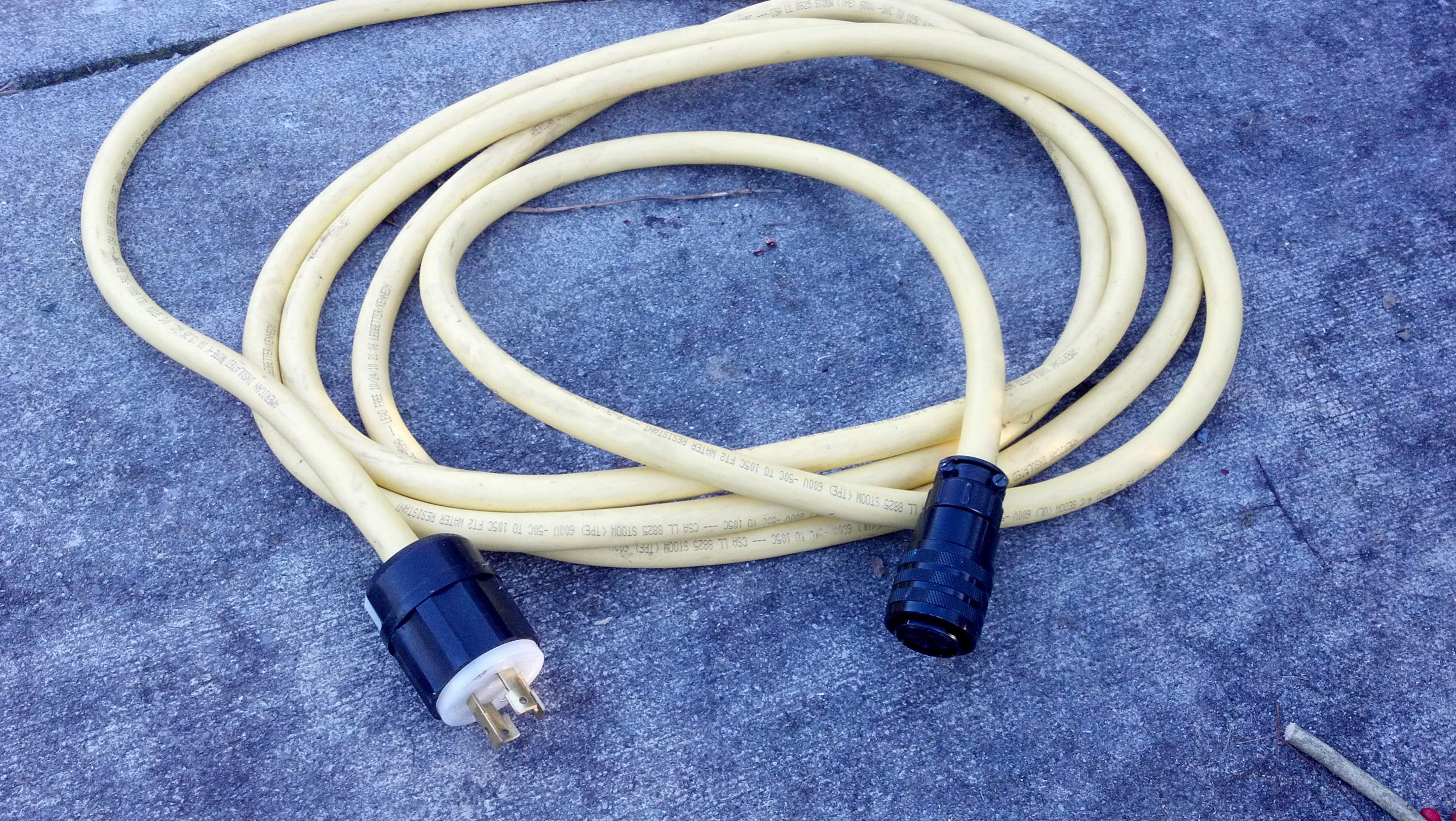

Howdy,
Generlink is made for 200amp service. It is a collar which extends your meter out about 4 inches. There is a special cord end which plugs into it. see picture below. The generlink unit favors generator power. In other words, when you attach the cord, your meter disconnects from the utility, and your on generator power. That is how you test. 3 little lites along the bottom by the plug tell you if utility power is waiting on the other side. If its not lit, then the power from the utility is not there.
30amp Generlink cord set
For larger service

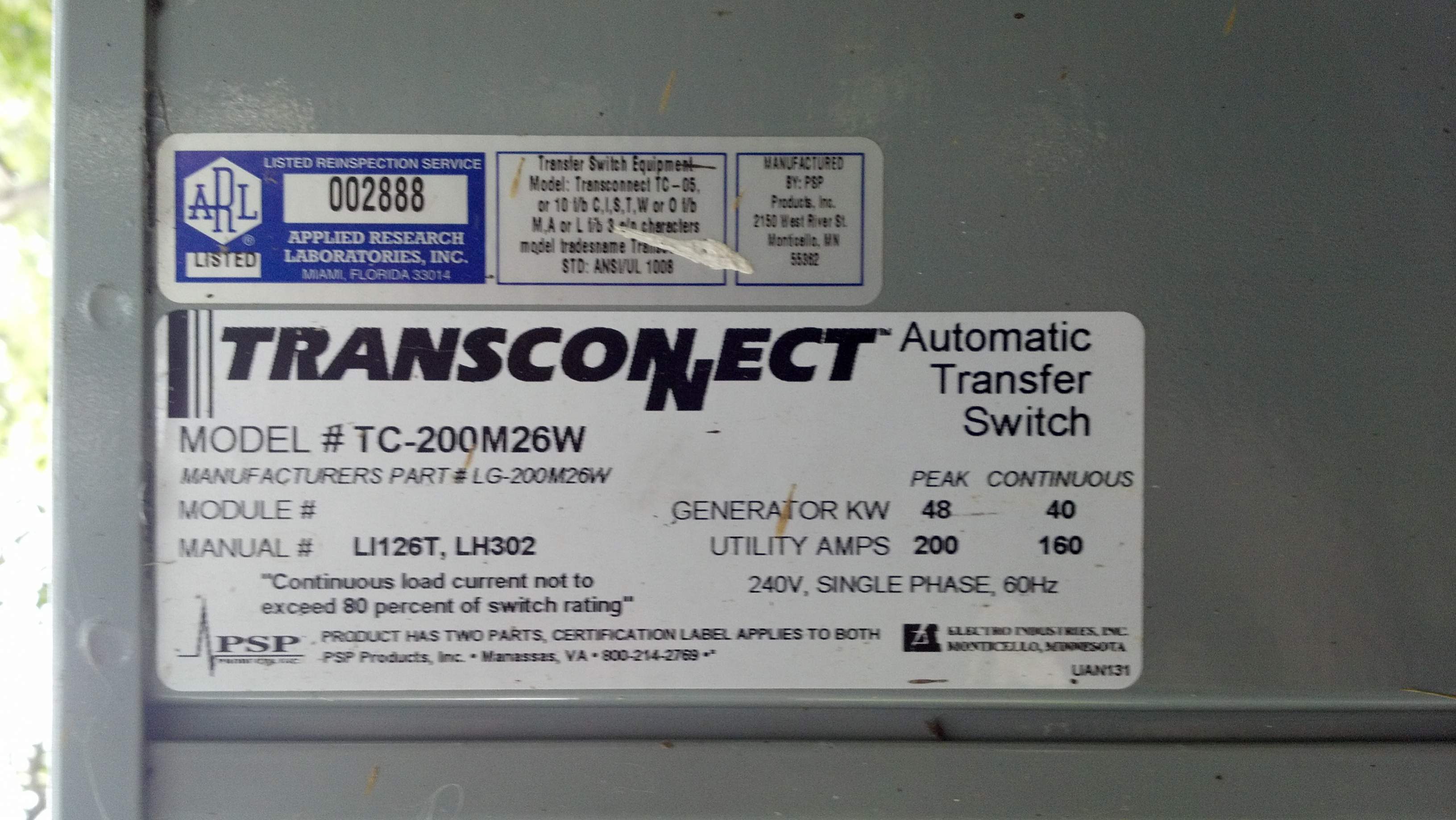

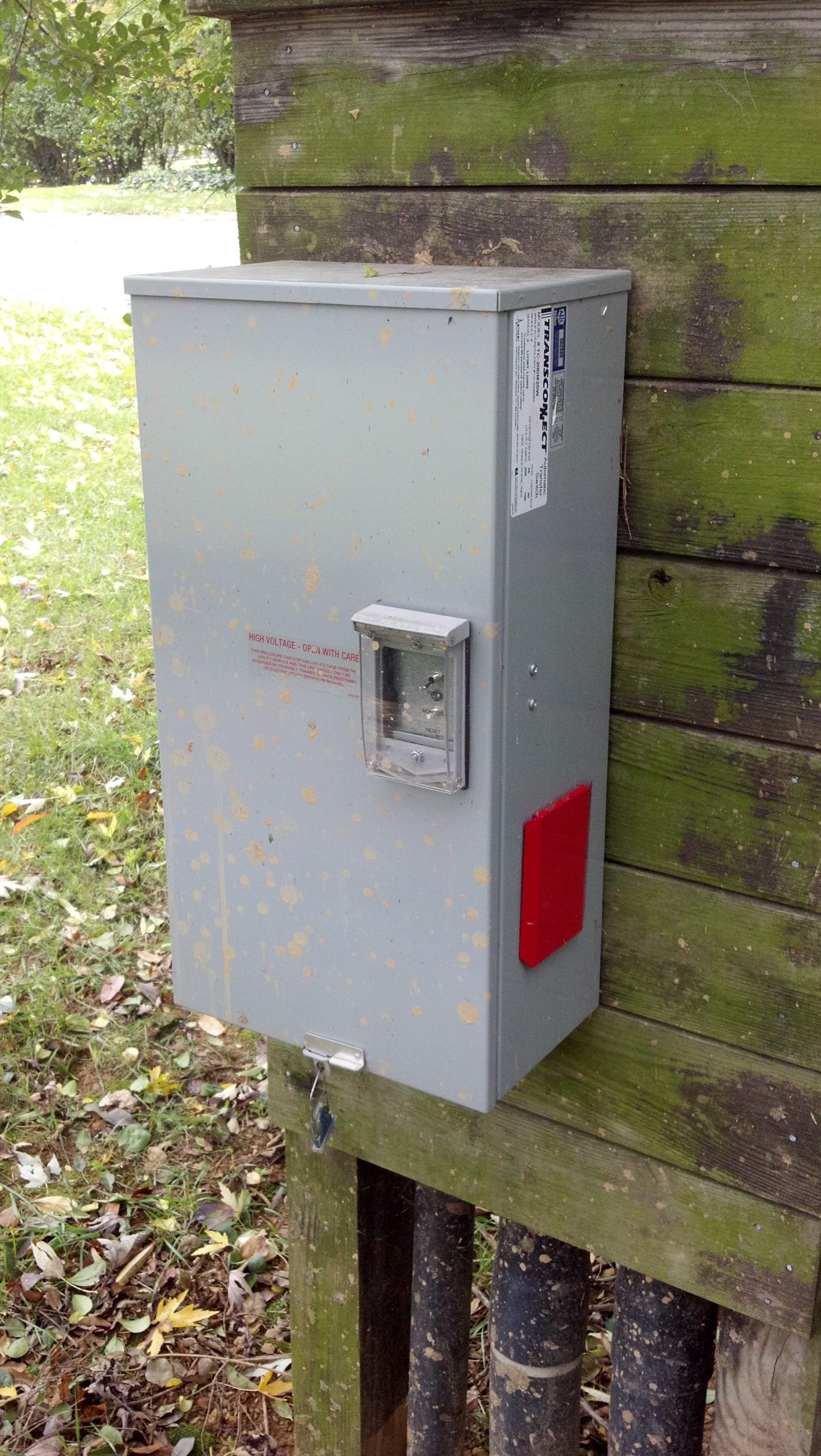

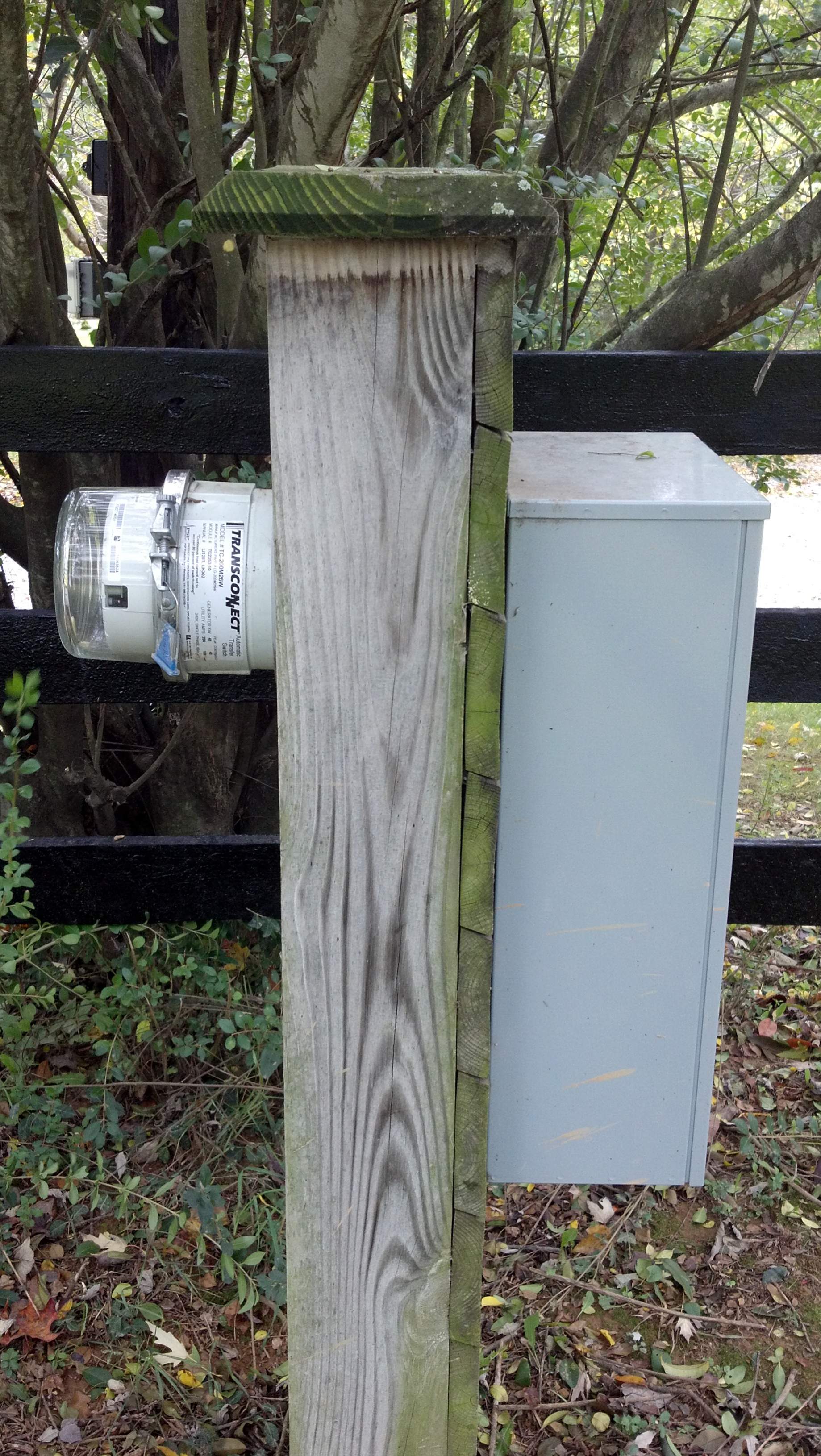

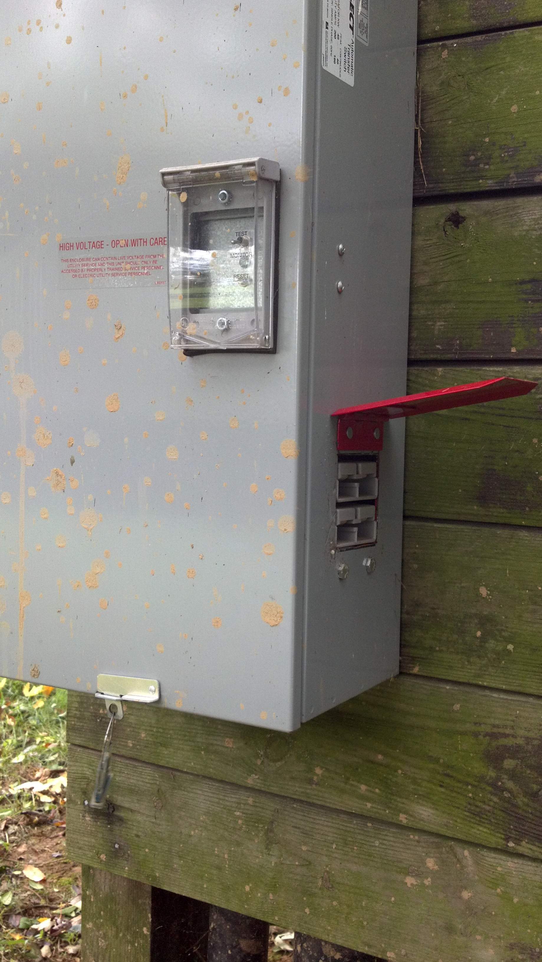

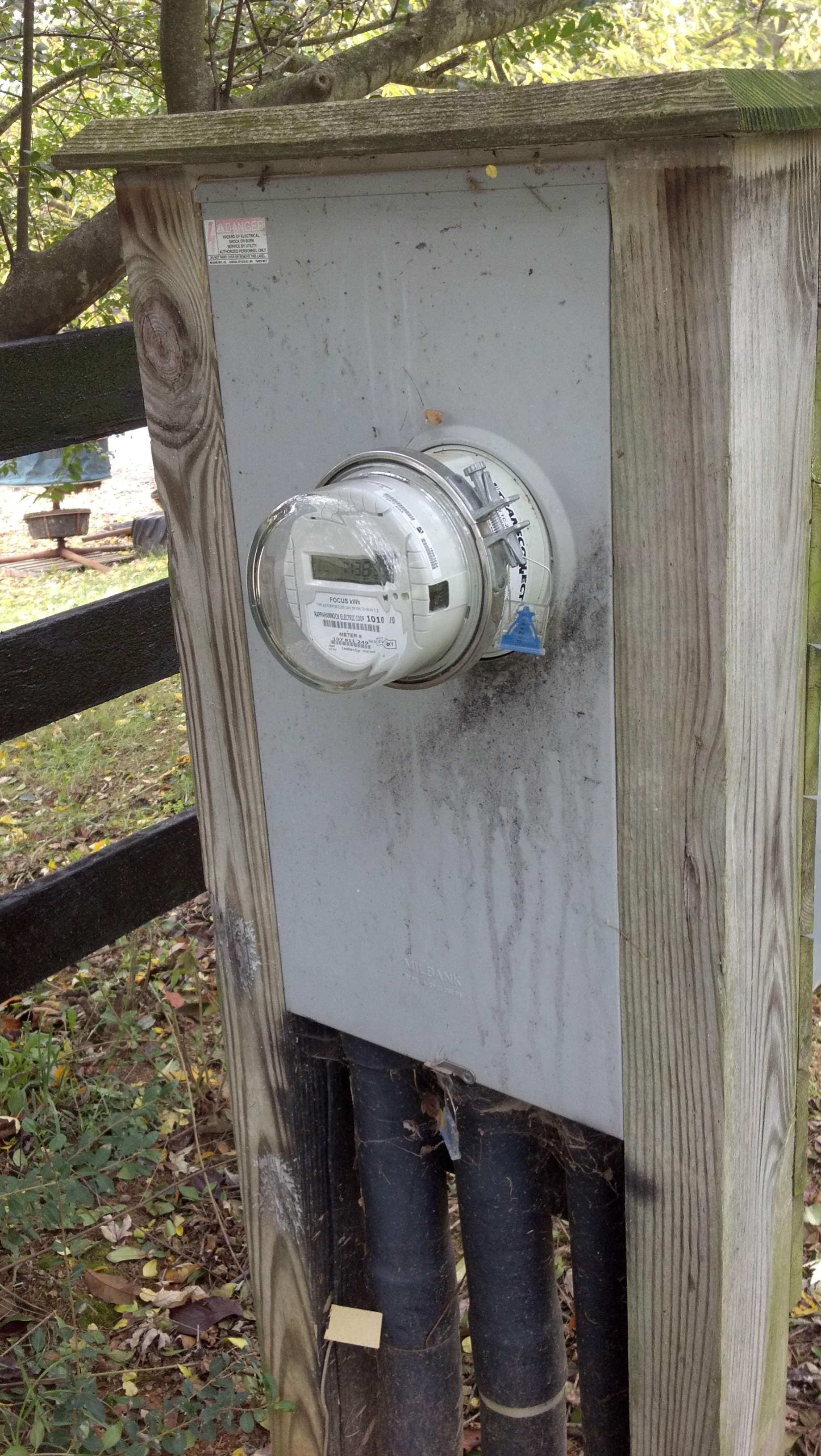

I too have 400amp service at a central farm distribution point. It was easier and cheaper to have my utility put in a special hook-up. Transconnect unit. Similar to the generlink, a special collar moves the meter out about 4 inches. It then has a special pigtail which connects another box. The other box has all the automatic transfer and disconnect circuitry. I have a full power plug (dual modular anderson 350amp gray with 2/0 pins) The same which is on the pto generator. see below
This really works well for me. I have feeds going out from here to the shop, run-in shed, barn, and large house. Each with there own panels.:thumbsup:

Howdy,
A LOT easier and cheaper. I looked all over the place and the 400amp transfer switch is made of gold. A lot really depends on your utility. I am in Northern Virginia, and have Rappahannock Electric Coop. Here is there pricing page of switches REC Electrical Services Prices I talked with them and was able to bump up into the next size switch. I also paid a little more than the $1,400 which is the 25kw.
If you look at the break down of what it would cost with;
wiring
electrician labor
utility to pull meter and put back
permit
it really adds up. I am sure it would be more than the $1,400. And since the utility did it, they have a permanent permit :)

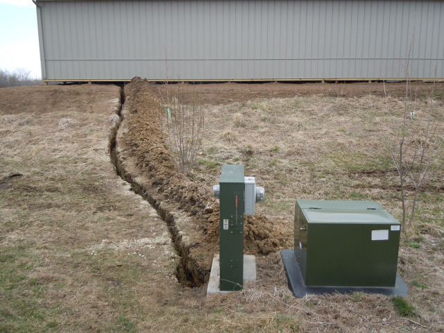

I have a tombstone by the transformer. It has a switch allowing selection of the grid, all off, auxiliary power. If I use a generator I could connect the cable on the AUX terminals of the switch and select auxiliary power. It is simple, no back feeding is possible but it isn't automatic.
The switch is in Grid position.
Handle in horizontal position is all off.
Handle pointing down is AUX power.
I could possibly leave the handle in off position and wire in some way kind of transfer switch to make it automatic.

Thats a cool idea.. i have never sen anything like that. :thumbsup:

That would work, it's basically a double throw 2 pole switch.
What do you have connected to the aux lugs now? Is it wired for a generator input somewhere on the house?
Also another set of wires not connected, is that for a future shop/ barn.
I see the double lugs for the load, good idea.
The good thing about that is you can totally disconnect from the grid, from the transformer forward on your property, so you could work on your main panel or whatever with no juice in the box or anywhere in the house. the only bad thing is you have to go out in the yard to operate it.
I don't think you could ever make that automatic though.
JB

The tombstone was installed by the power company. The transformer is just behind it. This is where they put the meters. The tombstone has two sides. One is locked and sealed. There is the total power consumption meter. From there are wires to the switch on the "user" side. On the "user" side is also meter for heating.
At this point there is nothing connected to the AUX. The neutral lugs (on the bottom in the middle) look like (in the picture) connected to the AUX terminals but they are not. The picture shows the switch before I connected the wires for the shop.

Ok I see in the close up, thanks.
You could of run extra wire in the trench for the aux line. or are you thinking of just putting the generator right next to the meter/ switch. That is, if you have plans for a genny at this time.
I'm sure it must be deceiving in the picture, but it looks very close between the neutral bar/lugs and the hot lugs.
JB

The point I was trying to make (not very well as it appears) is that some were trying to say that feeding the house was dangerous with a generator....I wasn't referring to the overheads, that's a whole other issue.
If Gulf Stream (more or less) backfeeds the coach with a run of the mill 5k Generac, then why is it dangerous to feed the house with a generator that is sized to the house useage?...Overheads out of the question, as mine won't power the other 4 houses...It'll die trying.
From what I have read about the Gulf Stream system it dosn't feed back it has a built in transfer between your shore power and the Gulf Stream generator.. If you walk into your trailer and turn a light on and it's not plugged into shore power the genny will start.. am I right on this ?? and if you walk in and turn on the same light and your plugged in the genny dosn't start,, " No Back Feeding involved"

There is nothing wrong with feeding a house with a generator that is sized for the house and has the proper transfer switch installed..
