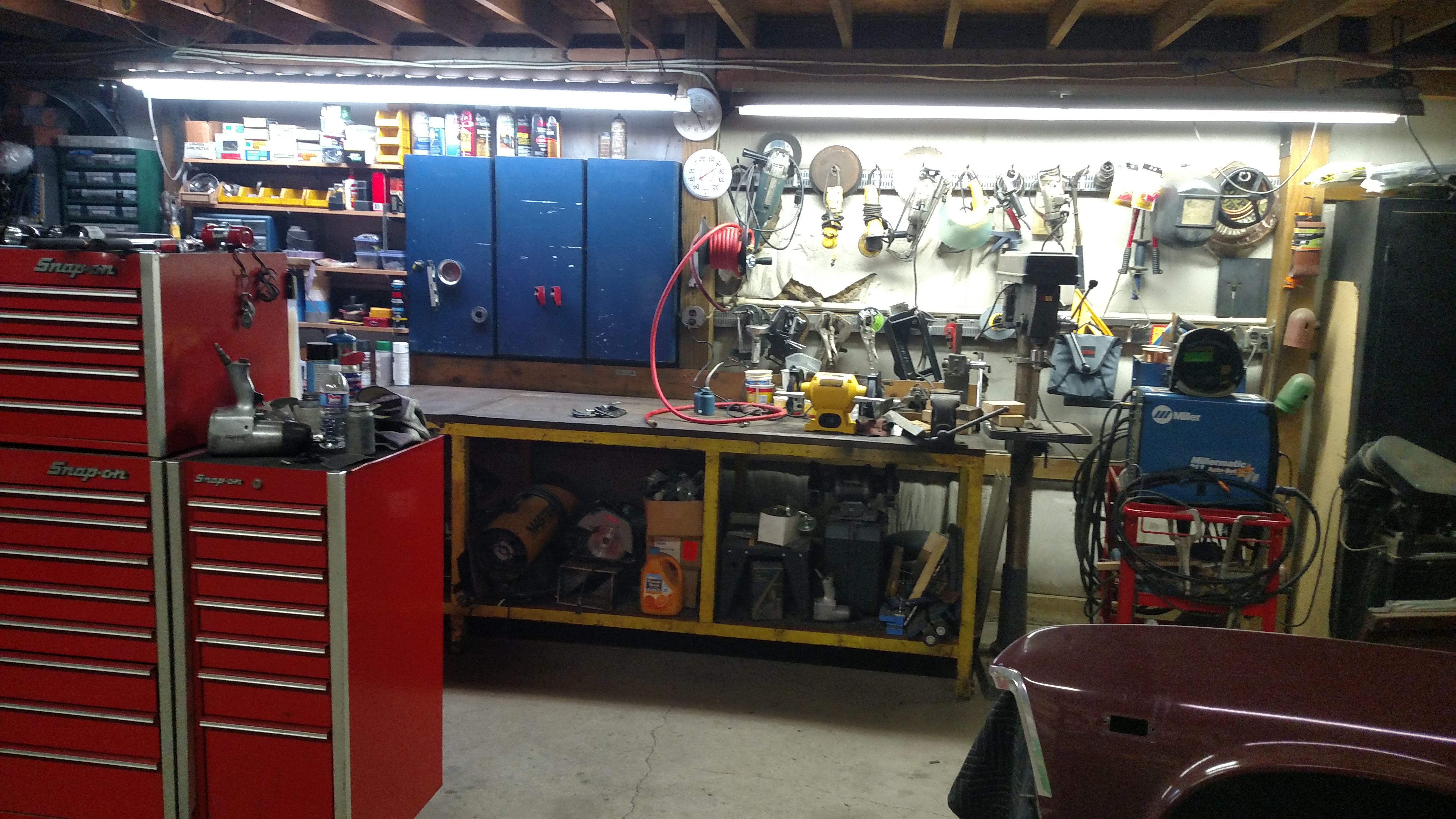

Nice job! Thanks for sharing it.
What are in the blue tanks on your workbench? Seems like an intriguing set up.
All the best,
Peter
The ones at the back of the bench are old ignition parts cabinets I painted blue. I keep all kinds of stuff in them.
Since this picture was taken I have cleaned things up a bit. Too many projects going at one time.

���� that looks like a very productive area.
