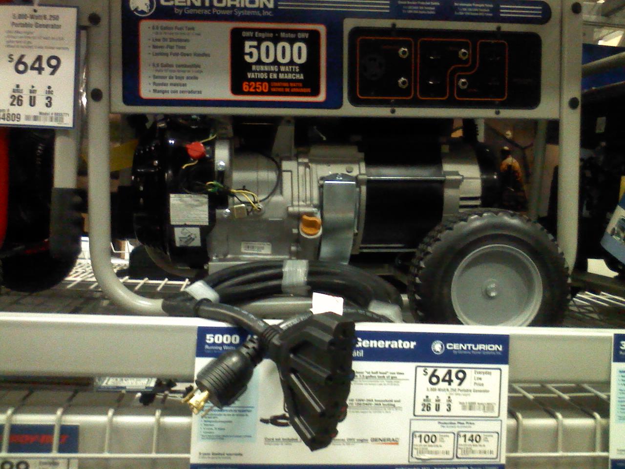

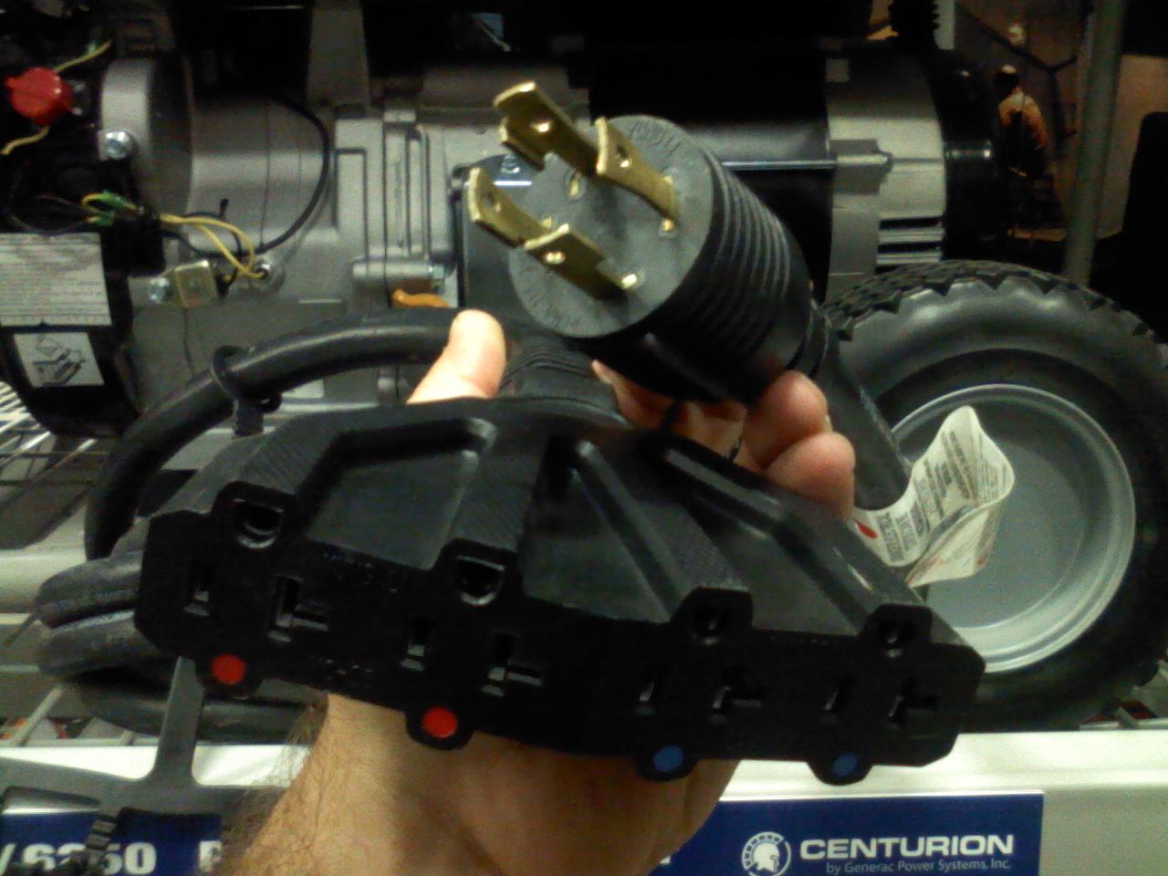

I saw this cord at Lowe's today, using the 4 prong 120/240 outlet.
This one has four 120 volt, 20amp receptacles. 2 have a blue marker and two are marked red.
Though it doesn't say it, I'm assuming it is 2 circuits carried by this cord.
An alternative to a transfer switch, where you could have a balanced draw on a single cord coming in the house.
I noticed none of the gennys had the 30 amp 120 outlet, just that 120/240.
