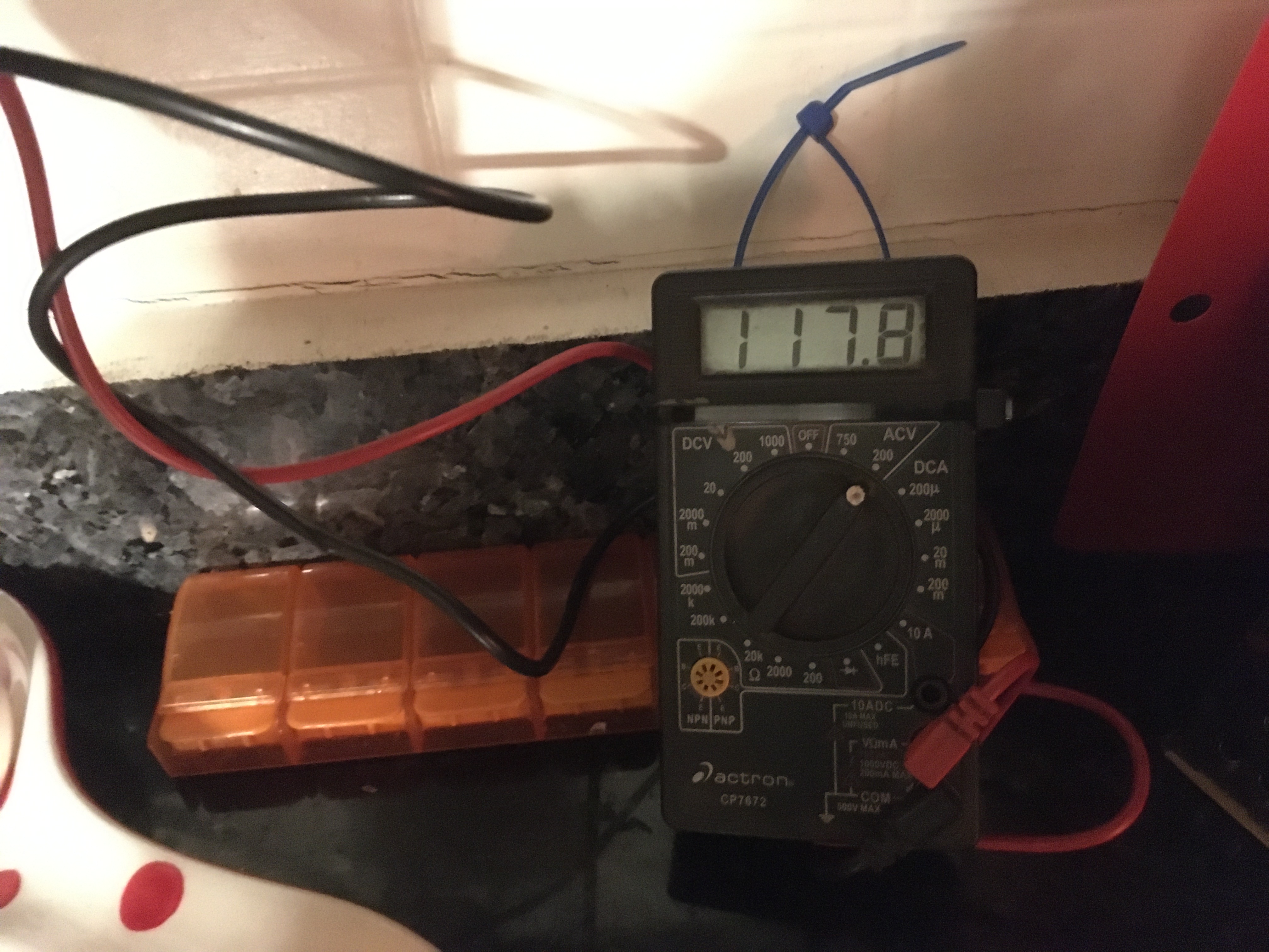

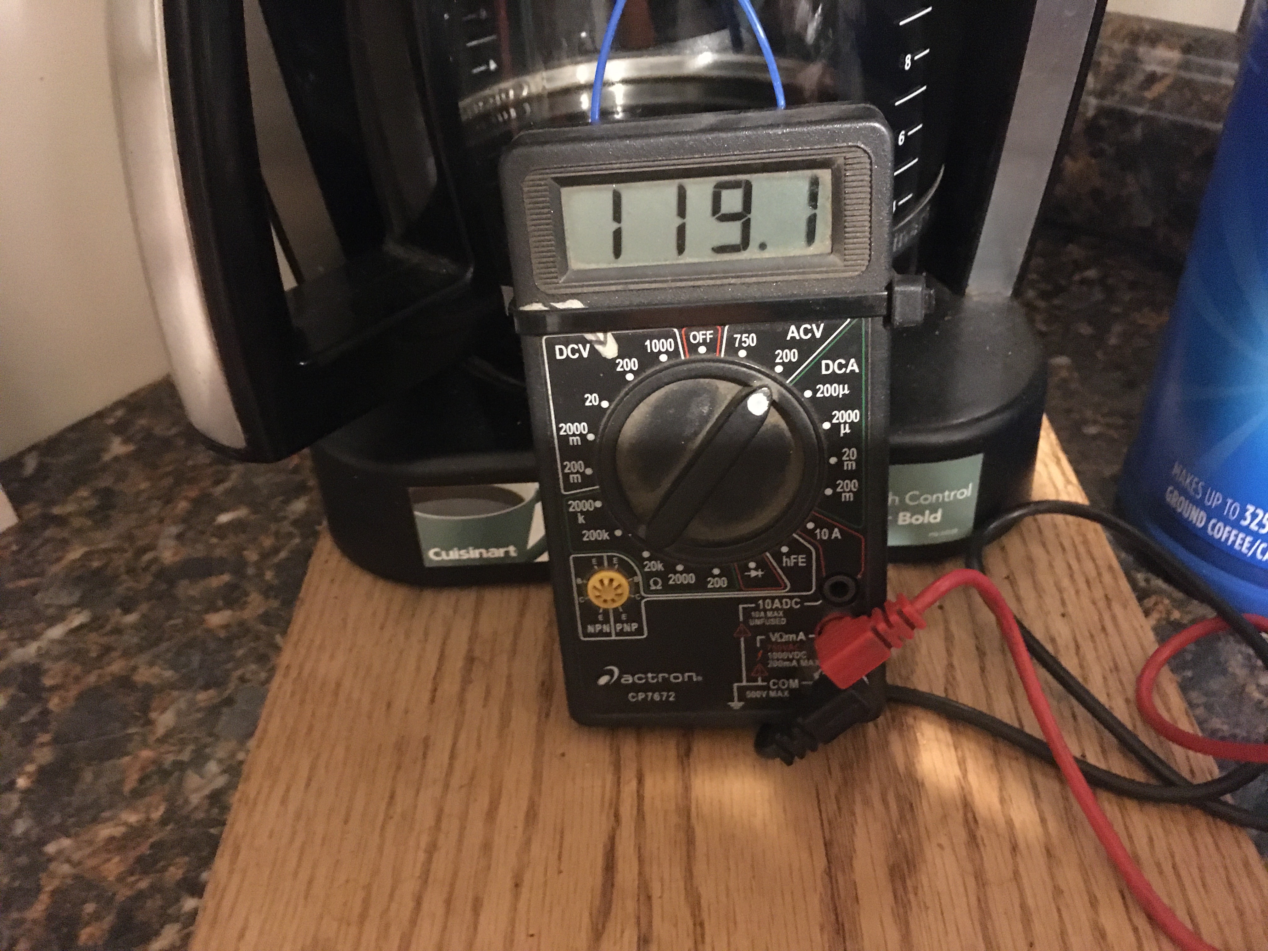

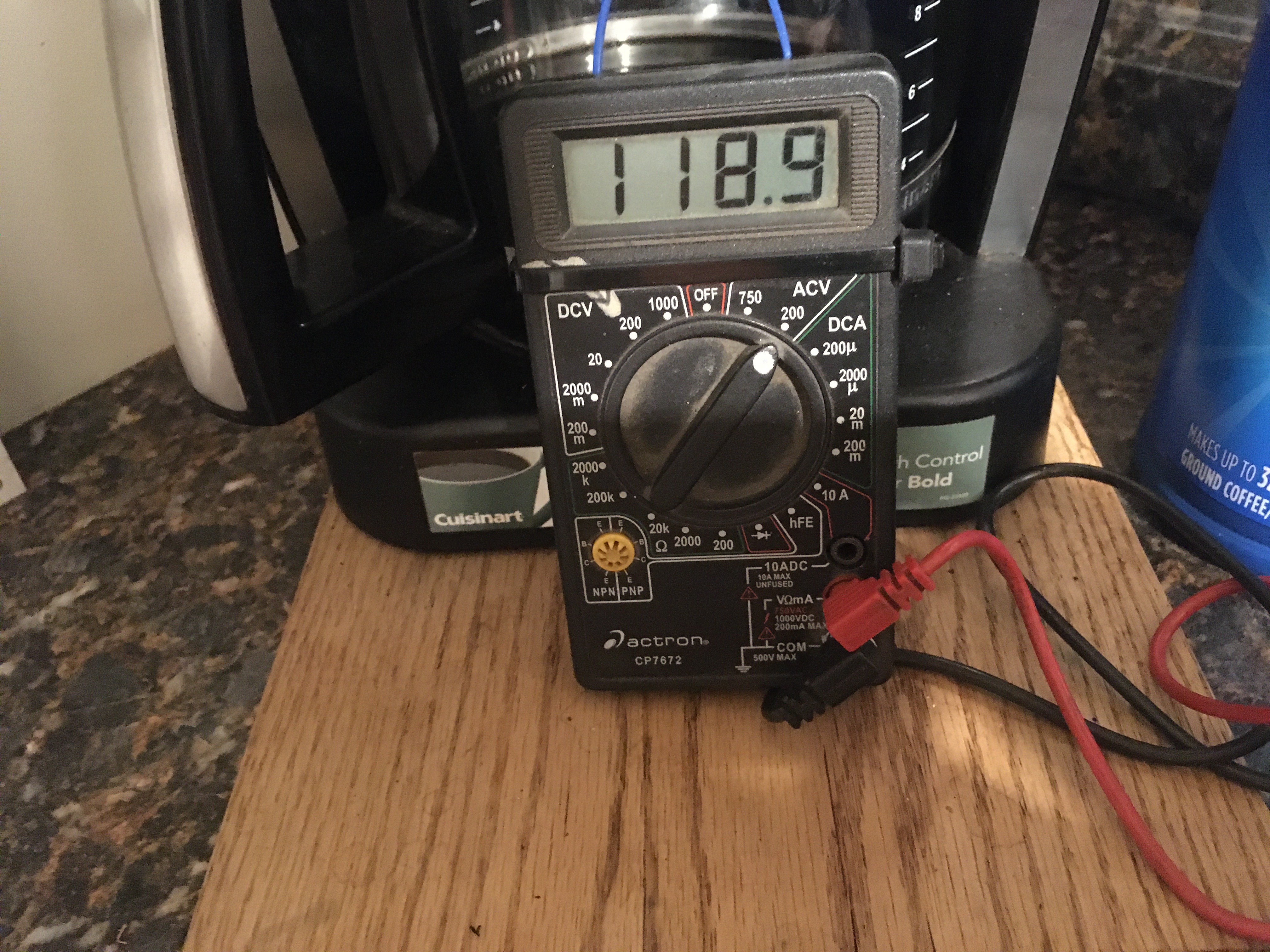

I didn't see anything about poles or HZ on this one but did see 120/240 volts, but what happen to the surge number, has peak and running, comes with transfer switch hook up but I already have 7000 watt transfer switch. The best part it comes with a 10 year warranty for New England TBN members...........
https://www.homedepot.com/p/Westing...tch-Outlet-for-Home-Backup-WGen7500/301466616
I did a quick 120 volt check tonight in several outlets cause someone hear mentions volt variances, yup got some variances tonight, cant get a 120 volt reading like I have in the past, could be some UFO inference going on............
View attachment 655413 View attachment 655412 View attachment 655411
I have noticed CMP has some varying voltages/hertz lately.
It was that night the voltage numbers was going up and down, the last time I checked last fall my outlets were 119-120 and stayed that way. Guess electricity making is still a complicated science, cause some are still not sure if we should went DC instead of AC.
