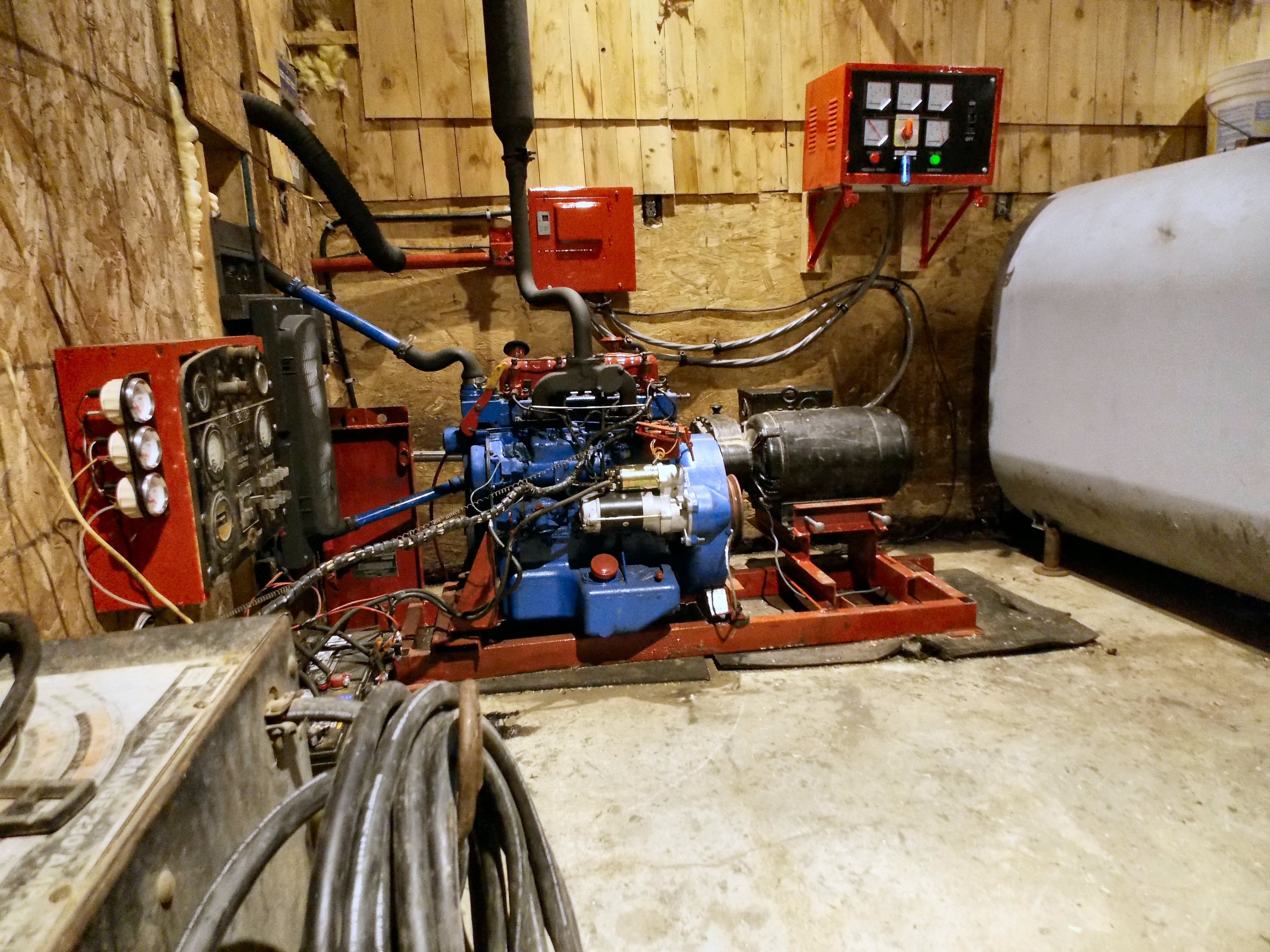

Are you guys sure you got the frequency calculations right? The last time I had a generator run, it was 91 hours without power, and I noticed the clocks were off by 15 minutes or so everyday. From the way the microwave and refrigerator was running, it seemed like the frequency (also called hertz) was low, not high.
At the time, my PTO generator only had a voltage gauge, so I would throttle it up to put it at 220 volts, but I had no idea what it was running for amps or hertz. Fluke makes a multimeter that shows frequency, BUT it does not work on generators accurately because of the electromagnetic forces they give off.
I decided to change that and bought a control panel. It shows amps, voltage and frequency. It cost me $180, but good gracious, that is nothing compared to ruining the motor on a refrigerator...or the motor down at the bottom of my well. Just the work alone to replace that pump would be a pain to say the least. The key thing to keep in mind is, hertz cannot be off at all. It has to be within + or - 2 hertz, and ideally at 61 hertz so when loads hit, and the governor kicks in, there is no shortage.
Since installing it, I found the voltage here via grid power is pretty high, at a constant 245 volts, with frequency at a steady 60 hertz.
You can see my control panel here in the upper, right corner of the photo: a 100 amp switch with frequency, voltage, and amps.
