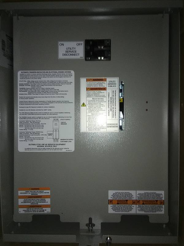

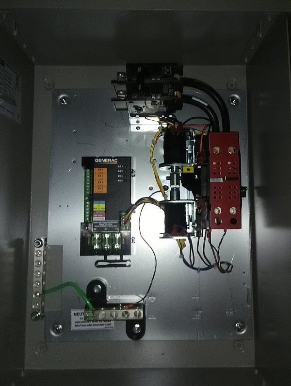

ATS showed up. Didn't expect FedEx to run today, but they did.
No knockouts in it at all, so now I need to find hole saws that will cut holes for 1-1/4" fittings in metal. Have a cheap HF set, but will have to see if they're metal rated.
Need to check with my local dealer first thing in the morning on the other two brands before I do anything more though. My guess is that now that I have it, I'll probably keep it and stay with G unless a compelling reason not to shows up. Now I guess I need to explore the 14 and 18K units. Drat.
There is a metal rod that inserts into the hole in the yellow tab to enable manual switching between sources.
674295d1603642427-generator-selection-deadfront-jpg
674296d1603642443-generator-selection-guts-jpg
I wish there would have been a better explanation of what 'suitable for service entrance' meant for us that aren't familiar with the term. I didn't really need the extra 100A breakers in here since I already have a set in the main panel and another set in the new disconnect I just installed. This makes three sets which I hope won't be an issue.

Service entrance means you can feed it directly from the meter can, then take the output to the old service panel. Zoro.com sells individual punch's. The cheap punches bind, so drill 1/4" then open with step drill then install punch. It will tilt cutting on one side, loosen rotate 90' and tighten again. I install a 200 amp panel for a 36kva diesel genset.

The Generac ATS is a dumb switch, that is the reason it is the cheapest. It has no line monitoring capabilities, although it does need line power to close the switch. It can do load shedding and staging. It is easily adapted to line monitoring controllers like the deepsea 7200. You feed 12vdc and then ground one lug to activate and if generator power is up it will transfer.

It's not exactly dumb in that it has utility power monitoring to an extent once connected to the generator controller. There are sensors in it that the generator controller needs. But no, it will not transfer automatically by itself.
I keep looking at the pictures though and noticing things missing or different from the manuals and diagrams. Simple things like labels, such as the E1/E2 and T1/T2 connections. Makes me wonder if they're rushing things through and the QC is slipping.
/ Generator Selection? #258
It has no sensors in it for line monitoring, it just passes 110V up to the Generator Controller which has the logic and programming. It does have loading shedding circuits that trip by frequency drop that indicates too much current draw. It runs via one 12voltDc double pole relay. The power to drive solenoids comes from either gen or line. So when controller tells it to transfer to gen, the relay connects the solenoids to gen power, another switch turns the solenoid off once it completes the transfer. It is nothing more than relays and mechanical switches.
The transfer switch has gone through several model updates, but is functional the same. They just keep finding ways to lower the cost.

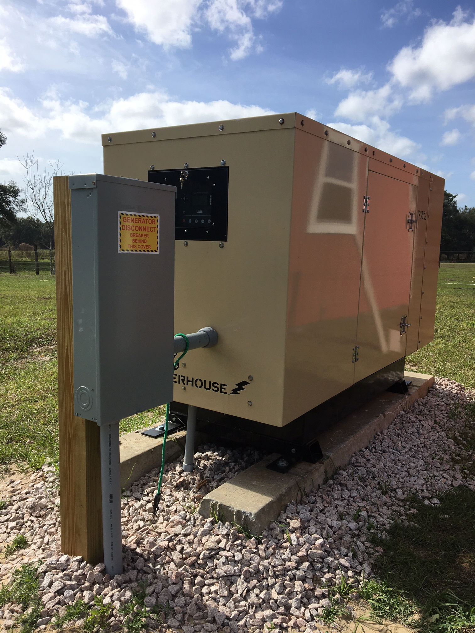

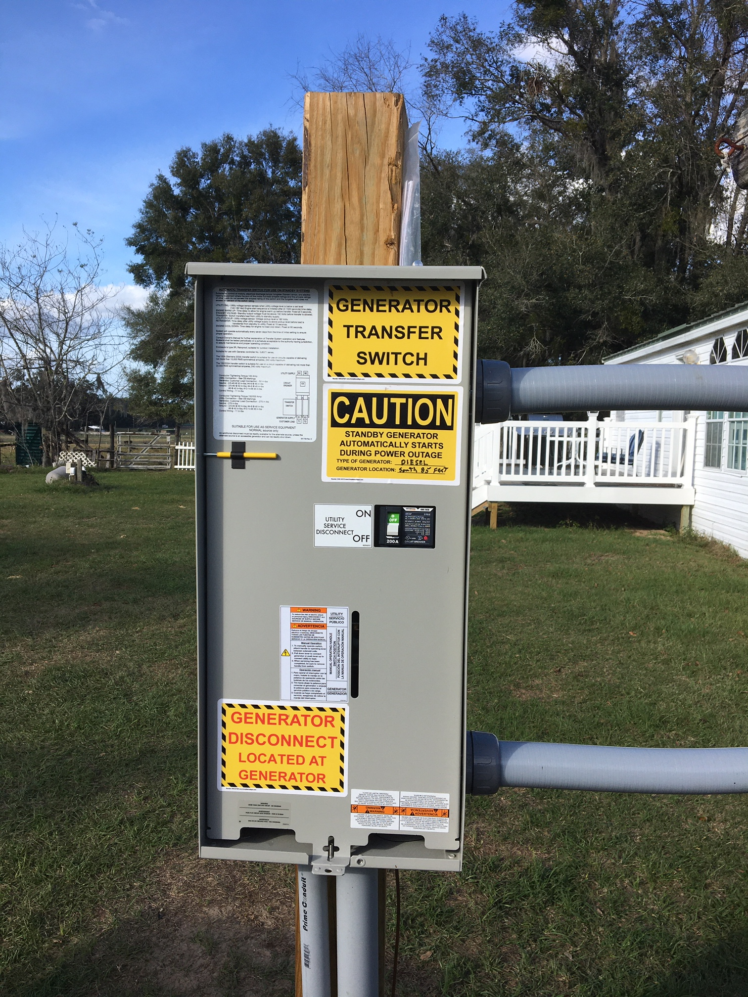

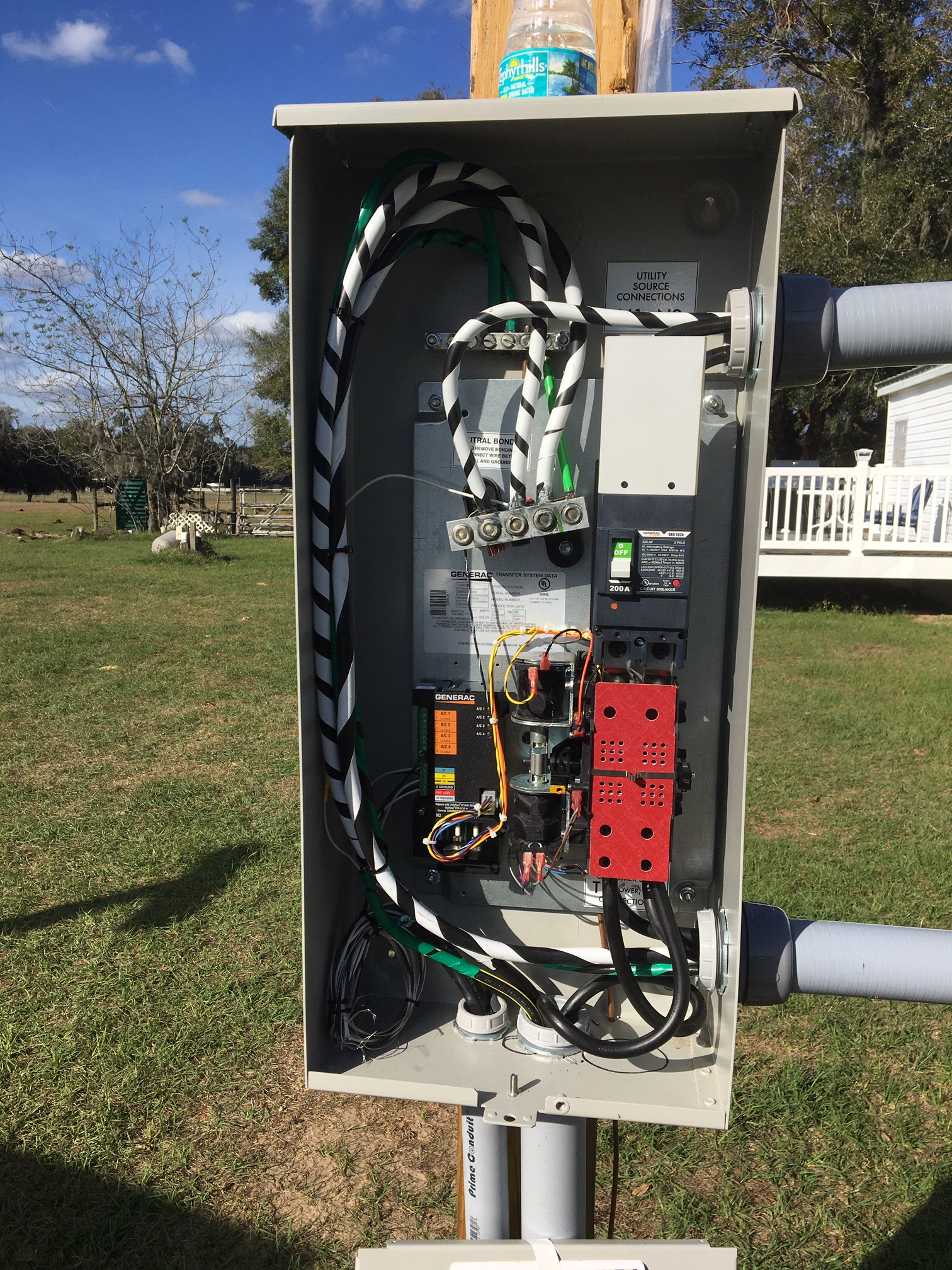

Here the pics of a 36kva I designed, this is so quiet you can talk standing right next to it, only pain was getting it hurricane certified, as if that thing was going blow away.
