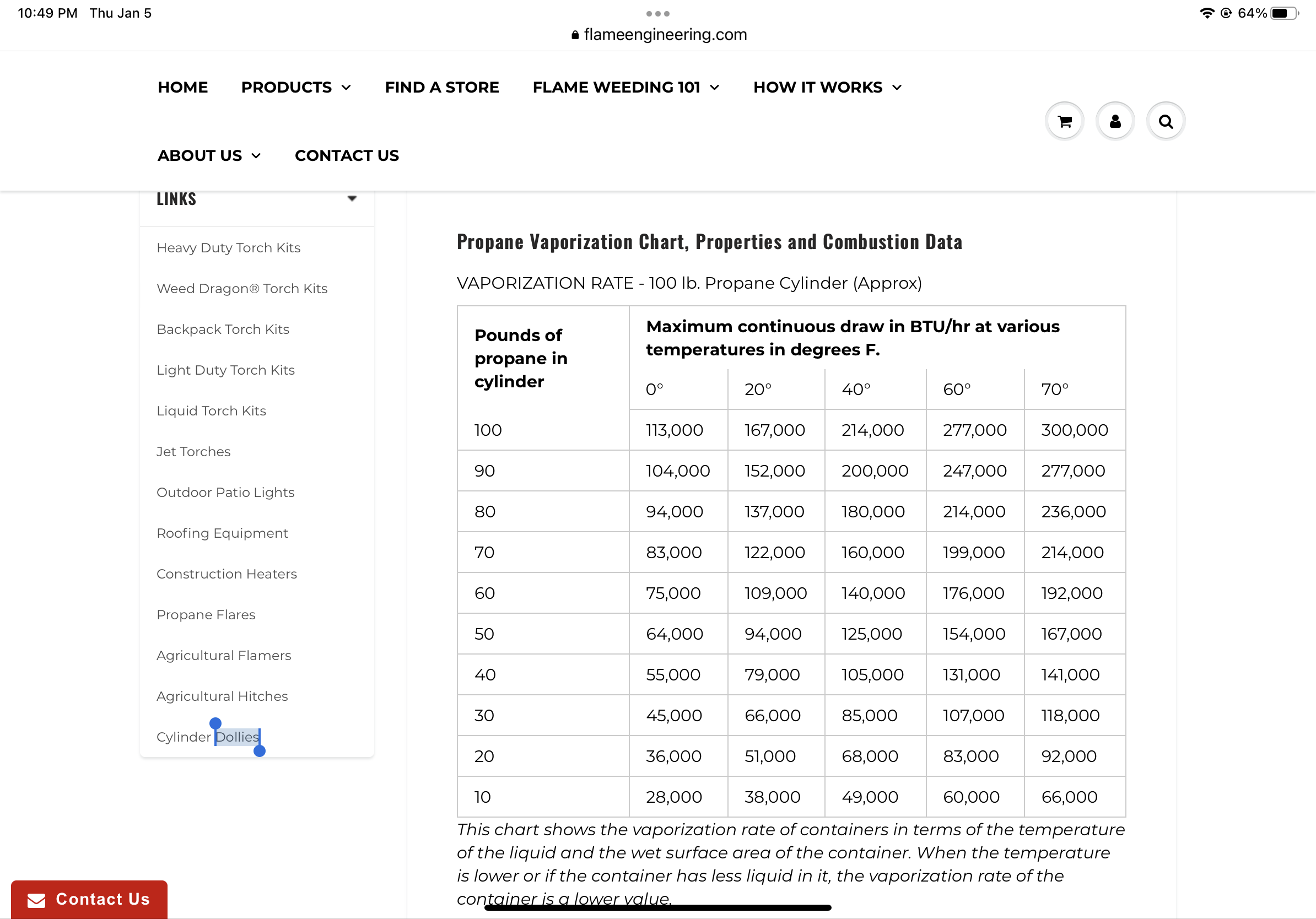

I was hoping with it being an inverter I could do a smaller propane tank. Otherwise going to just use gas. I will borrow a 100# to try when it is cold out to see what will happen. Then if it works go that route. Otherwise gas can and a syphon from my Jeep…
Here is a web site with your answer about testing with a 100 lb tank. Check you fuel rate btu/ ht of your Gen against the table. Also, I copied the table in a picture below.
