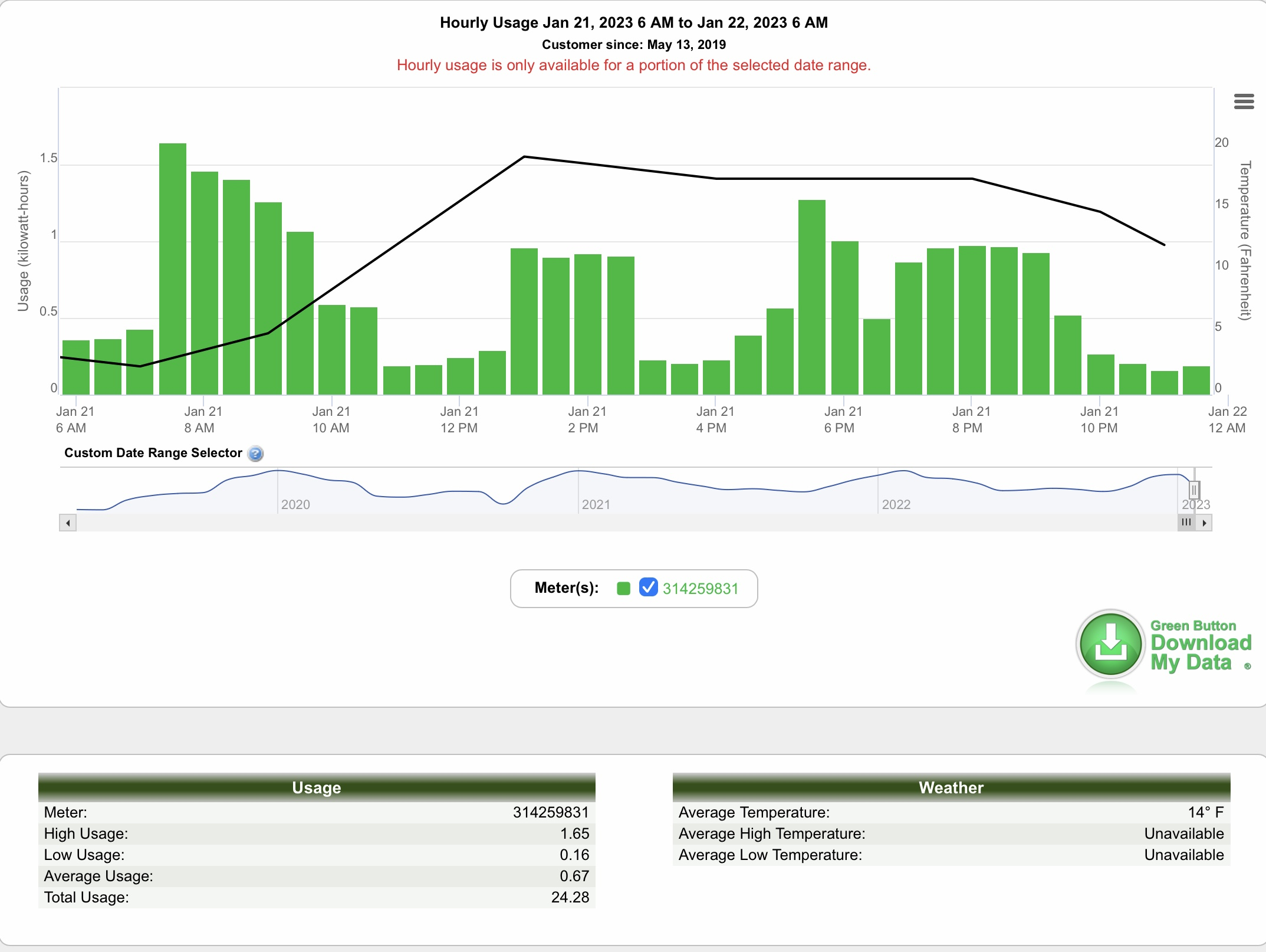

My electric coop has a good tool that I looked at to determine the correct size I need for my generator. It shows temp at the meter as well, which is smart. My max usage yesterday was 1.65 kwh, when my tractor was plugged in. The temp line is helpful to see as well. My 6k/5k inverter should be plenty to run 4 essential circuits.
just waiting on the high altitude jet from champion for my unit. Then I will test my setup.
If you are not sure what size you need take a look at your power provider. They might have something like this available.
