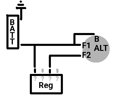

I bought this alternator for my snow-blower's cummins 5.9 12-valve (no internal wiring diagram).
DB Electrical AND71 Alternator (For 94 95 96 97 98 1332), Alternators - Amazon Canada
Not knowing any better (to research and do it myself) I farmed out the hookup to a retired technical school teacher. He tapped out a stator pigtail for a tach signal which subsequently worked (for a while).
Next he piggybacked an unidentifiable electronic external regulator that has 2 wires on it and a grounding tab. He connected battery positive to one of the regulator wires and the one of the alternator field tabs to the other regulator wire. The remaining field tab on the alternator was connected to ground.
The tach quit working so I provisionally bypassed the regulator and connected live battery + to the alternator field tab. The tach now works, I haven't yet checked charging.
I also ordered a new Tru-Tech VR166T regulator (no internal wiring diagram).
While trying to get myself spooled up on the topic I stumbled upon this blurb which seems to contradict all of the above.
https://dodgeforum.com/forum/1st-gen-ram-tech/303000-diy-external-voltage-regulator-conversion.html
If I read this correctly the BATT should connect to the batt tab of the regulator AND to one field tab on the alternator while the other field tab on the alternator should connect to the F tab on the regulator. This suggests that the one filed tab on the alternator receives battery power which then exits via the other field tab to ultimately ground out in the regulator tab.
Can anyone chime in on this? TIA

I have a Delco Remy service bulletin attached. This is a very common alternator on older equipment, and easy to work on. The regulator is inside this alternator but the bulletin shows you the principle.
The right charging voltage is important. We had a tractor with a bad regulator at work. The gauge showed max voltage. The boss said we look at it when we have finished. Not long after, the operator walked of the field. 2 batteries had exploded and the battery parts had damaged the radiator. Battery acid all over!
Weird, I AGAIN did not get an email thread alert.
Thanks, that's a so called 3-wire alternator. I was advised to buy one with an external regulator because the new electronic ones (internal or external) are easy to blow. Mine probably blew when a battery terminal got unscrewed with the alternator charging, something I had been warned about. I tested it today with no regulator and just unregulated battery powering the field and an unregulated 17vdc charge was the result, which I of course did not leave on :))
I'll have to wait to see what kind of docs I get with the new regulator, it's evident now that the 2 field tabs on the alternator are just that, the 2 ends of the field coil, one of which has to be grounded the other powered. What I do not know at this point is if the regulator (presumably F) tab provides modulated output power to one of he field tabs in which case the other tab would only need to be grounded, or if full BATT power goes to one one the field tabs on the alternator and the modulation is still done by the regulator but on the line grounding the field via the other alternator field tab connected to the F tab on the regulator? Also need to know if polarity is important.
Any mechanic used to working with charging systems would know this blindfolded but I only share the latter attribute :)

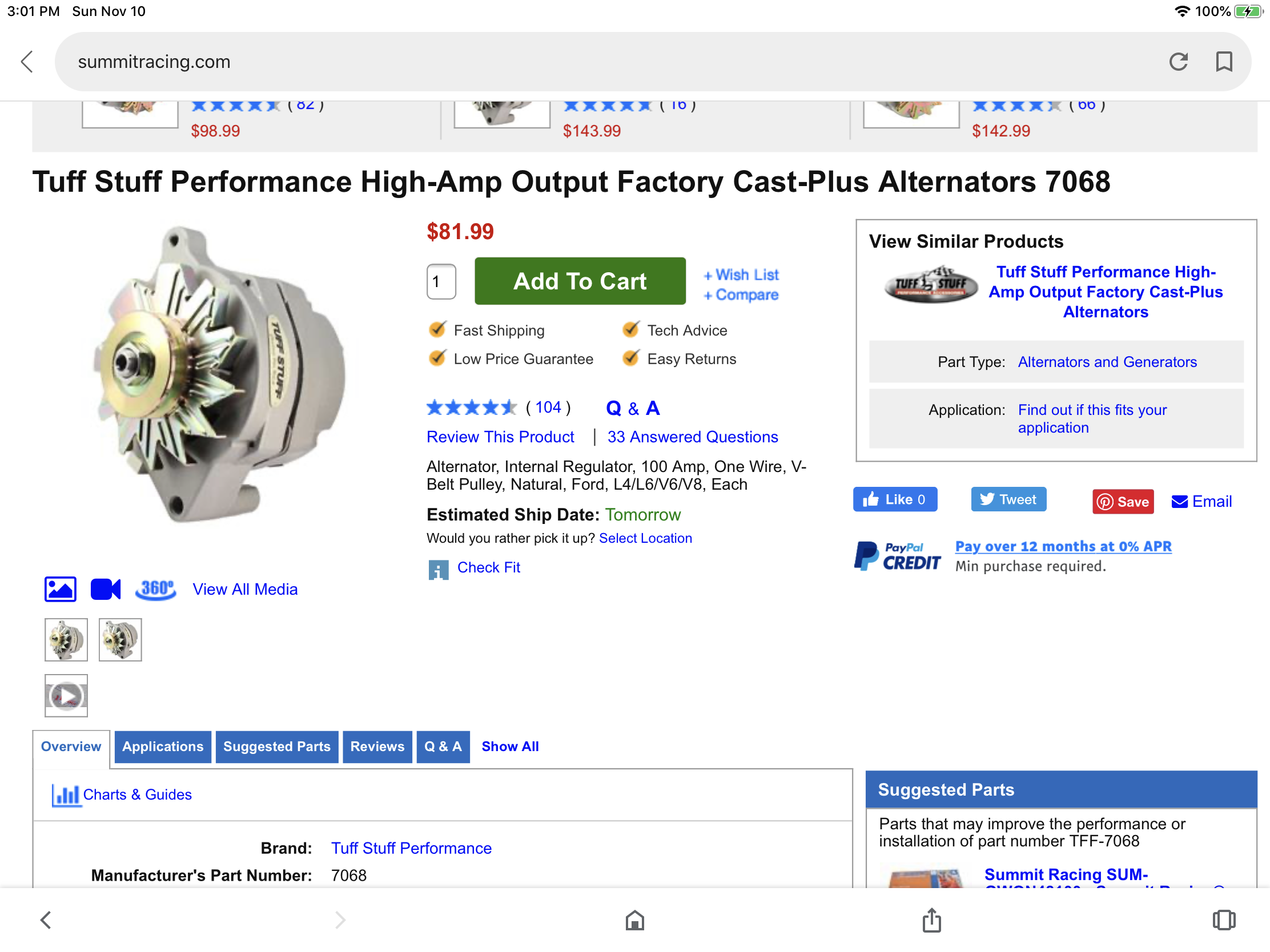

I put this 100 amp one wire on a old ford last year.

I understand that internal/external reliability is similar but if an external one blows you don't need to replace the alternator. Meanwhile I presume that mechanical ones are more reliable. There is a warning (below) to "never disconnect a battery terminal with engine running'. Remember when this WAS the standard way to test an alternator? We probably still doe not need this warning with mechanical ones(?).
I went to the local supplier and the only alternator with a tach-tab he has in stock is 3-wire one for $400cdn (not ready to buy one of those!).

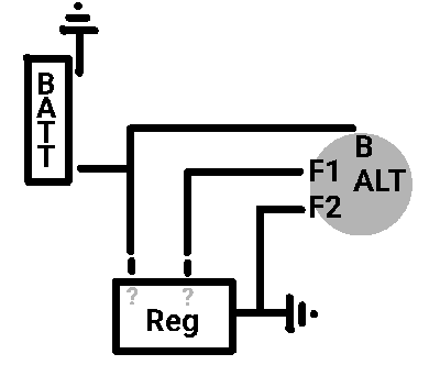

I need to rephrase my original question. The alternator I have is an externally regulated model suitable for a 1995 Ram diesel pickup (the engine it's going to). It has 2 unmarked field terminals. In the case of that truck I /think/ the external regulator is actually he external vehicle PCM module so that one field terminal on the alternator gets full 12 volts from the system and the other one goes to the PCM where it is then reduced if needed and then grounded (regulated).
I don't have a PCM, I have a generic ford-compatible electronic 4-terminal (I-A-S-F) external regulator.
"I" normally goes to ignition which I do not have, it could be a light which I do not need, ergo "unused"
"A" is where regulator gets 12v, connect to batter or BAT terminal of alternator
"S" supposedly goes to STATOR, not sure about purpose/use of this one
"F" what is the exact function of the F terminal?
Case-1: my 4-terminal external regulator acts like the external PCM so one of the 2 alternator field terminals gets battery 12v (from any source) and the other goes to the regulator F terminal inside which the voltage subsequently gets reduced if required before being grounded (regulated). In this case the F terminal does NOT SUPPLY.
Case-2: the 4-terminal external regulator F terminal PROVIDES already regulated voltage in which case it gets connected to one of the 2 alternator field terminals (same as above) but then the other alternator field terminal must be just grounded to alt-regltr-frame.
I don't wanna blow the regulator with a + to + connection as soon as powered, nor blow up the battery because all it really gets is 16-17v which result from continuous un-reduced 12v going the the alternator F terminal all he time.
