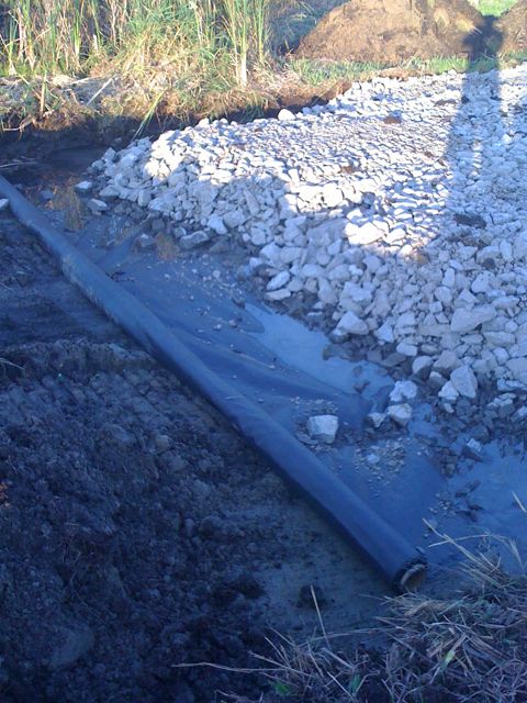

We had a 1200 foot driveway built last summer with the first 600 feet going through a swampy section over a wet clay base. The builder used a 12 foot wide membrane with 4-6 inch crushed rock 2-3 feet deep followed by 6 inches of 3/4 gravel. Total of over 100 22 ton loads.
The road has not moved an inch, no potholes or any detectable depressions. That is with a full summer of construction traffic including concrete mixers.
Membranes are highly recommended if crossing unstable ground.
