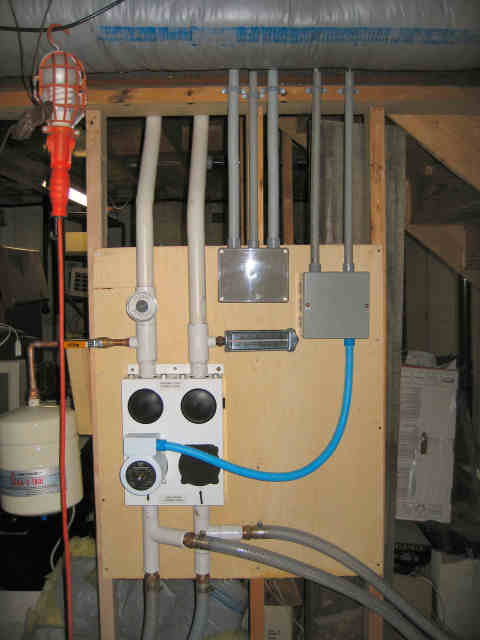

As stated earlier, I installed a 240 volt power relay for the circulator pump. Each geo unit has a power out to the circulator, which energizes when the unit runs. Since there is only one circulator for two units, the relay is used to operate the circulator when either unit runs. ClimateMaster makes a module to handle this task, but the relay was 1/3 of the price and simple to implement.
I also deviated from the trade norm which is to have the thermostat and compressor wiring all connect together at the airhandler. Since the airhandler was in the attic, in a not so easy to get to spot, I decided to bring all low voltage wiring to a central J-Box in the basement. This was If I added or changed anything in the low voltage wiring, I could do it in comfort, standing up.

Circulator panel with both units connected. On top the low voltage J-Box and relay.

Showing the inside of the circulator relay enclosure.

Low voltage J-Box. This has the wiring for both units.

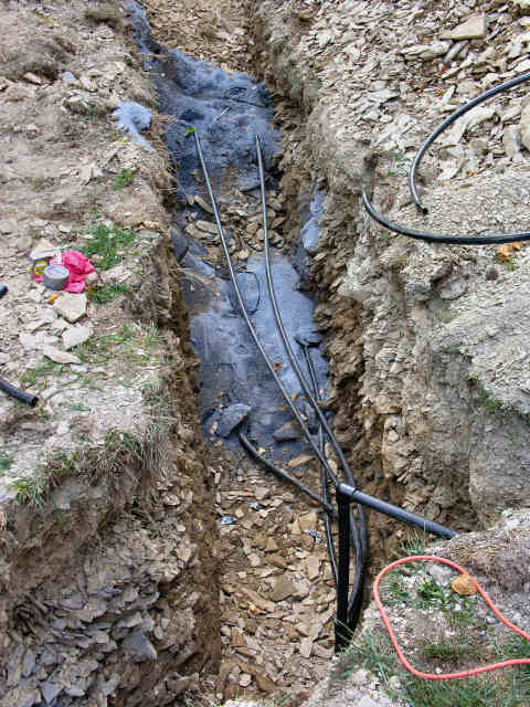

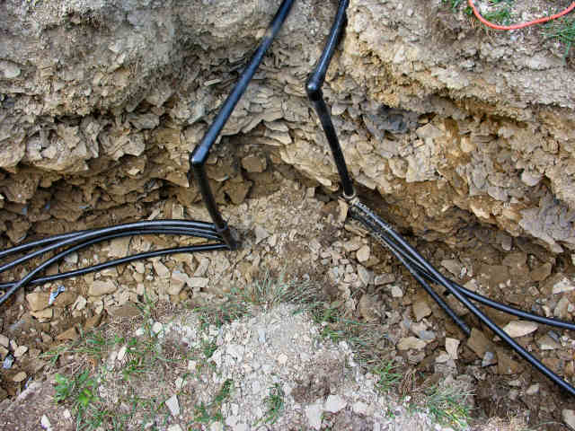

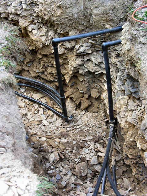

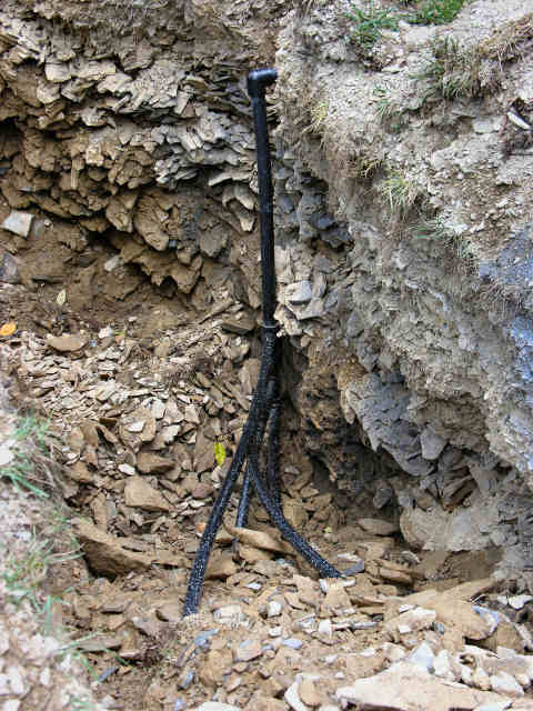

I didn't have time to read thru all your post,but will when I have more time. I did view a couple of pics of your system. In the one pic you showed the tubing in the ditch. It would concern me that there was so much rock and shale in contact with the tubing. Over time the vibration of pushing a liquid thru the pipe will wear a hole in the tubing. I also noticed that you did your manifold outside under ground. What happens if you develope a leak in one of the runs in the dead of winter? Wouldn't it have been better to had the manifold inside your basement with values on each run so that if you did develope a leak you could isolate that run and still run the remaining system runs?
   / Geothermal Heat Pump Project
#60

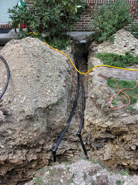

The picture of the tubing was not a finished shot. About of 1 foot of screenings were put in and the tubing was lifted and centered in the screenings, so there is no shale in direct contact with the tubing. Also the tubing is 200 PSI rated with nearly 1/4" wall, tough to cut through even with a sharp knife. I feel very comfortable with the screenings protecting the tubing, and also providing a thermal coupling.
As far as the manifolds, the joints are thermally fused, as good as solid pipe. Depending on the install, couplings in the run may be needed (not in my case) and they are always thermal fused, same process as buried plastic gas line. Again no concern with the joints leaking. The area with the manifolds was filled with screenings as well to minimize settling, etc.
