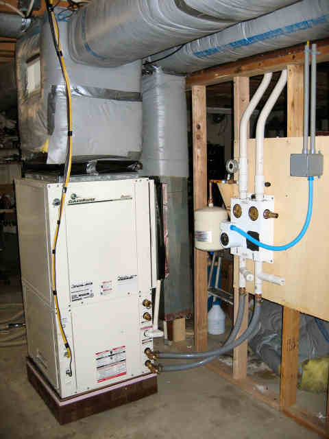

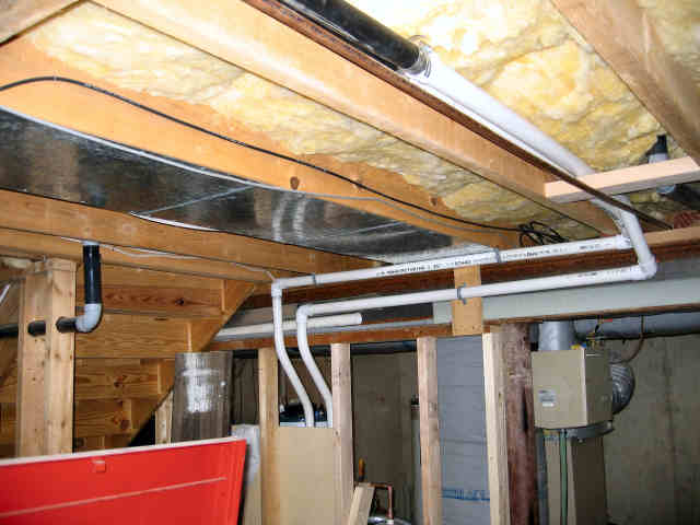

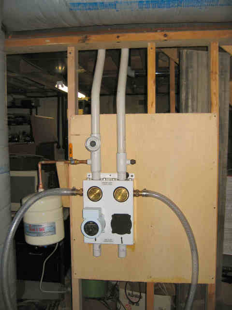

I just found this post. Very, Very interesting and thank you for all the details. I, too, wondered why you didn't put the manifold for all the 500' sections inside the basement. Just a different approach, I guess. I learned there is more to these systems than what I see at the Seattle home shows. Thanks again.
   / Geothermal Heat Pump Project
#63
Putting the manifold in the basement has no real advantage. It would take more room, more or bigger holes in the wall, etc. If you have faith in the fused joints, then I see no reason to have the manifold indoors.
Many systems have slices or joints outside. All vertical loops have multiple field joints. Thermal fusion is used. Any mechanical joint is specifically warned against by all of the geo heat pump manufacturers, due to possible leakage. If you see a cross section of a fused joint, it looks like one solid piece. So with the right tool and proper training, as well as pressure testing prior to backfill, there is no worry.

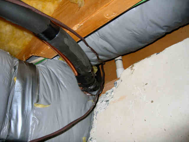

Paul,
Thank you for taking the time to put this thread together, lots of good helpful information. I do have a quick question, what did you do to seal up the penetration where the pipes come thru your basement wall??
Thanks,
I core drilled the foundation, about 3/8" bigger than the pipes. I fully filled the gap with silicon rubber.
Paul
   / Geothermal Heat Pump Project #70
I sleeved pvc pipe thru the wall first, used hydraulic cement. Then ran the loop pipes inside the sleave, caulking both inside and outside. I ran all my loops inside and did my header inside, so I could control each loop individually. Also, it makes purging air easy. If you header outside, you need to use to use a large flush pump to get rid of the air, by putting the header inside, with shutoff valves, you can flush with the circulating pump.
