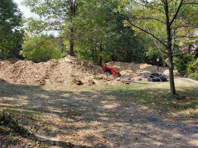

Here you can see the start of the loop. The top line goes off to the house and the loop lines with backfill on them. You can see the 2 levels of the tubes here.

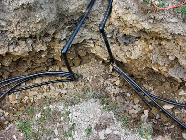

Here you can see the end of the loop and its header. You can also easily see the 2 layers in the screenings.

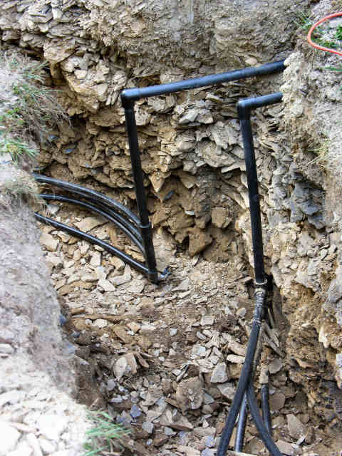

Here are the two headers and the transition to the house.

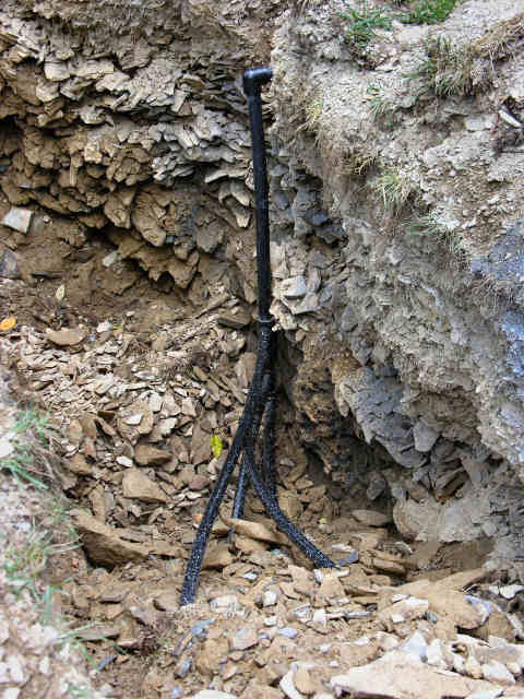

Another view of the headers.

Here you can see the lines from the headers to the basement. These lines are 2-2.5' deep at this point.

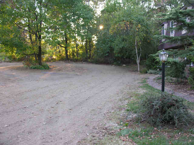

The front yard when the backfilling was completed. Wife was not happy.

After grading and York raking, the yard looked better. Unfortunately a few days after this picture we had 6+" of rain. The result was a 6-9" settling over the trench. This spring will be regrading and raking and getting grass back.

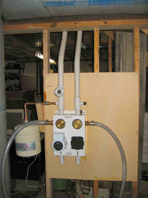

Chapter 8
The inside work was now starting. First was to get the circ panel in. To connect the loop to the circ panel, I transitioned to PVC with standard glue joints. Temps and conditions are fine for PVC, and if there is a joint problem, it is readily accessible. I added a small expansion tank (recommended to me) to keep the loop pressure steadier. The manufacturers do not recommend a tank, and the loop pressure varies from about 30 PSI to 80 PSI seasonally. Using the small tank I have had a 3-4 PSI variation. A potable water tank should be used. They have the fluid in contact only with the bladder, and not the steel surface (furnace tanks sometimes have the air in the bladder and water against steel). Using this style minimizes the chance of any corrosion in the loop.
Another decision was to use bent joints in the PVC rather than fittings. This was done to reduce pressure drops in the loop, to maximize flow rate. Bending was done with a heat gun and layout table. You need to be careful to maintain diameter and avoid wall thinning when bending PVC. Experience at it is the best tool.
The panel has the pump and a blanking cover for a second pump, used in the 2 pump models. The brass disks are the 3-way valves to select closed, flushing or running positions. The side fittings are for flushing and the bottom fittings go to the units..
Continued on Chapter 9
paul

#32
View of the piping transition to PVC. Note the bent tube runs. The lines are fully insulated now. By early January the temperature of the pipes reached the dew point in the basement and started raining. 3/4" rubber insulation was applied to all of the pipe runs to stop the condensation.
Paul

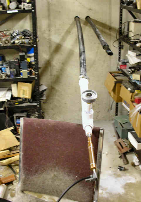

/ Geothermal Heat Pump Project #33

With the loop plumbing done, the next job was to install the 1st floor unit. Having removed the old equipment, installing the new geo unit was relatively straight forward. The tin knocker made adapters for the plenum and return ducts, and some trimming and bending later the connections were ready. The unit was places on a few course of bricks to get it off the floor. On top of them a layer of foam for some sound and vibration insulation followed by a layer of rubber vibration pads from the supply house. I was told that the unit is VERY quiet, but that it should be mounted on a vibration pad and that any base support material should be a soild layer. Apparently if you mount it with say a perimeter of bricks or blocks, the base plate can flex with compressor vibration and amplify the noise.
Electrical hookup was straight forward. It was now time to fill and flush the loop. Since I did not have a flush cart (although I could have borrowed one, but schedule was a potential issue), I used an alternate (but recommended) method. To achieve the required 30 GPM and 30 PSI min flushing requirements, I used a 1 HP pool pump. A 35 gallon high side plastic storage tote served as the tank.
First the loop is filled and flushed. The valving on the circulator panel was set to that configuration and the loop filled from a hose. I started the high flow flushing with the pool pump and quickly realized how much air was in the loop. A couple of hours and a lot more water later the loop was finally fully filled, with minimal air left. I flushed for about 4 more hours. During this flush, the flow was reversed in the loop every 30 minutes or so, and between that time the return flow was shut off rapidly (using an in line 1" ball valve), allowing the loop to pressurize to 30-50 PSI pump pressure, then the valve is quickly opened to help remove small lodged pocket of air and minimize dissolved gasses. By having the return flow in the tank below the water surface, it was easy to see any air bubbles in the flow as I flushed.
Satisfied that the loop was sufficiently flushed, I next added the antifreeze. This was done by running the flushing as before, but initially dumping the return flow outside (drain) until there was just enough level in the tank to keep the pump supplied. Then the 5 gallon buckets of methanol mix (30%) are poured into the tank and into the loop. During this time the return is still drained outside until the last couple of buckets of antifreeze provided a reasonable level in the flush tank. Then the return was restored back into the flush tank. The result is the antifreeze being charged into the loop and in the end the flushing is continued with the antifreeze. Only a premixed methanol solution should be used indoors so that it is below the concentration where it is flammable, and ventilation of the work area is a must.
In the end the loop holds about 100 gallons of fluid. The methanol is selected to give the desired freeze temperature for the system. The loop was flushed for another 4-6 hours to eliminate any remaining air that may have been introduced with the methanol, and also to help mix the methanol throughout the loop.
Next was to fill the heat pump water circuit and piping. The circulator panel valves were changed to connect the flush ports to the geo unit. The flush pump was used to fill the unit from the antifreeze mix that was in the flush tank. Again a few hours of flushing to remove air, and the valving was changed again to connect the loop, geo unit and flush ports all together. Several more hours of flushing of the complete system and checking for any remaining air bubbles the system was finally ready. The last step was to pressurize the loop. This can be done with a hose from the water supply, or as I did it with the flush pump. I set the air charge in the expansion tank and opened the valve to connect it to the loop. I started the flush pump and used the ball valves at the flush pump/return to trap about 20 PSI in the loop. The valves on the circulator panel were then set to the normal run configuration. The system was ready to run.
All in all the fill and flush took 2 full days. With some experience, it can be done in one day if everything is in place and ready.
