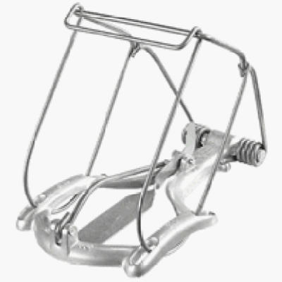

This is the best trap I have found for moles:

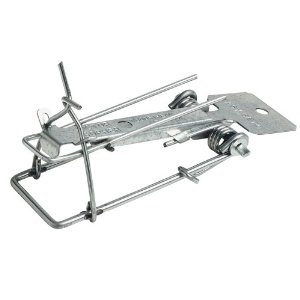

This is the best trap I have found for gophers:
The Nash trap, the one you have pictured above for moles... is a pretty good trap. Only problem is they are expensive and EASY TO RUN OVER WITH YOUR MOWER [ as in destroy ]... Even if the idiot operator painted the aluminum frame with bright yellow paint. [ who ever he was.... :( ] :)
LOL! Sounds like something I would do!
I set a bucket over the trap so that a dog or some other critter doesn't get their nose in there and set it off. Though lately my wife has forgone the bucket and she ties pink flagging tape on the trap to make it easy to see if its been tripped.
