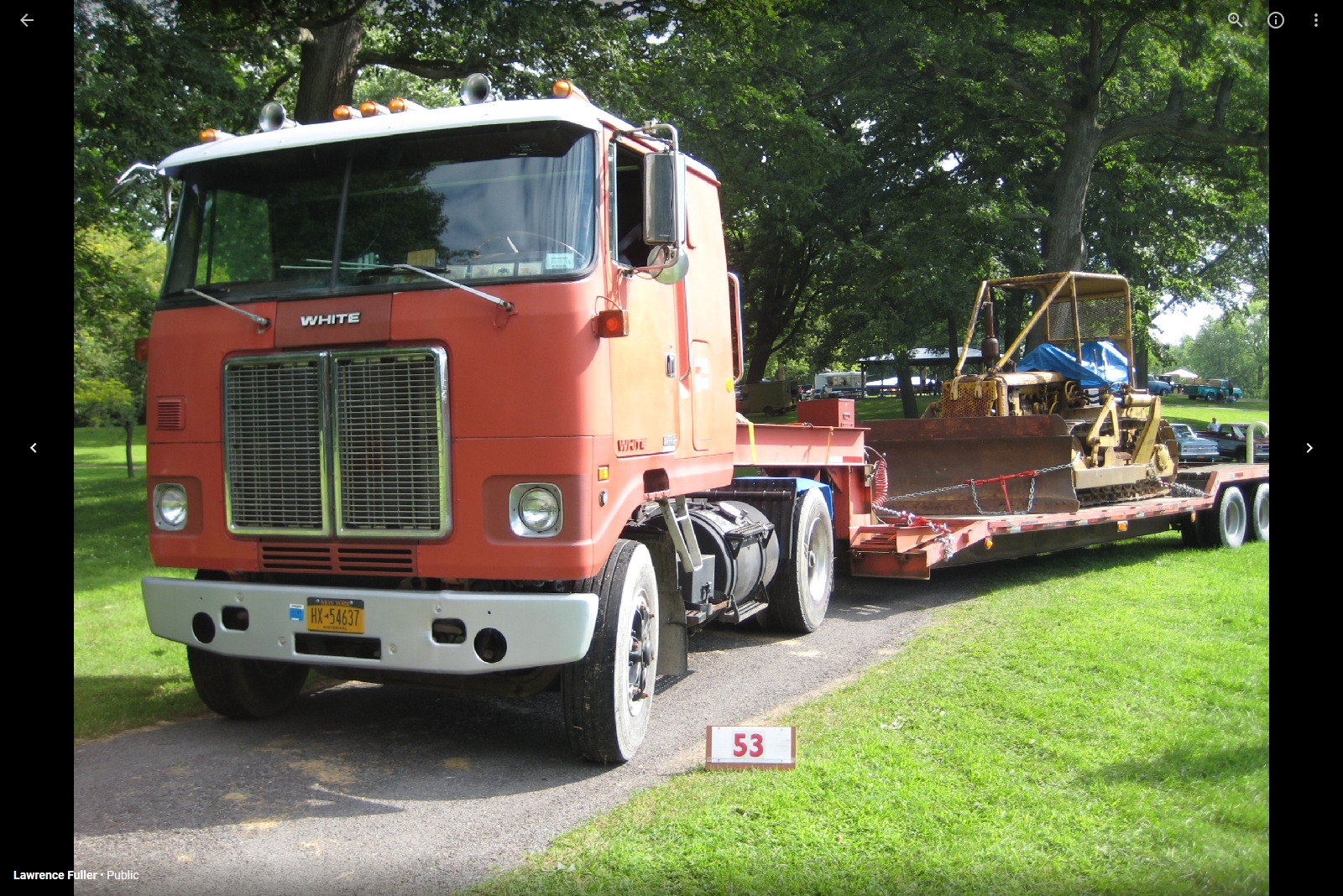

Still running this one. 6V92 under the seat. I just wish it had power steering. Tight maneuvering is a bit of an exercise.
