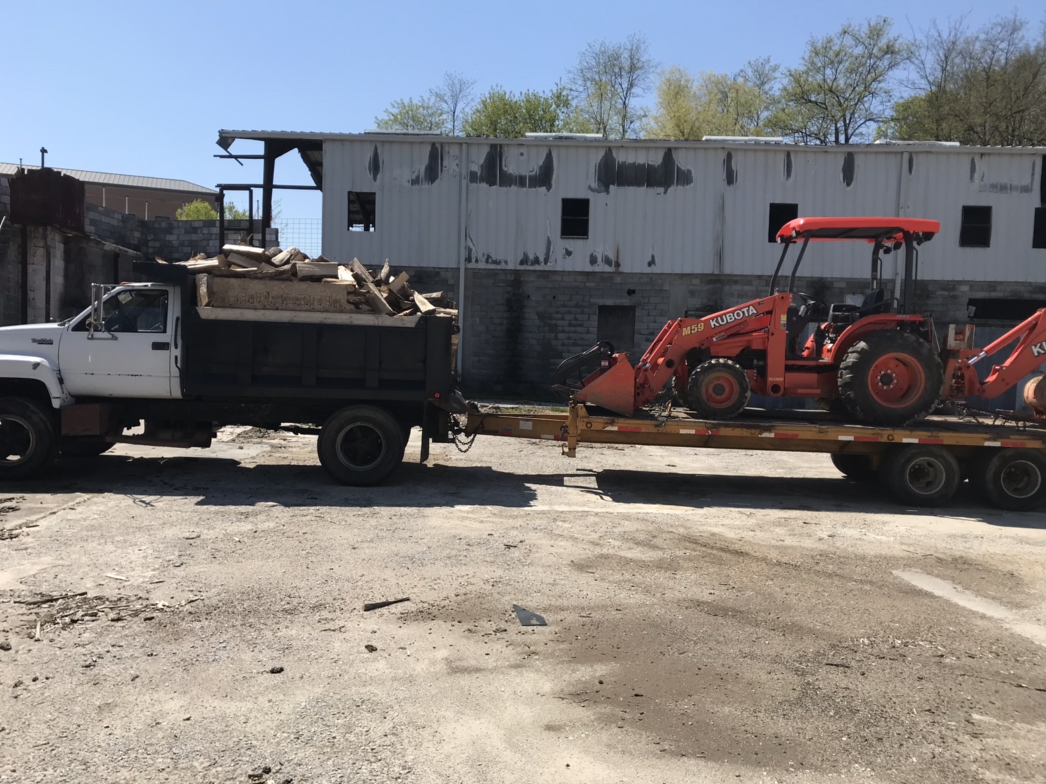

My Topkick is gas. It drinks plenty of it but it’s not that bad for an occasional use truck. The 366 has proved reliable and cheap to work on. It’s still a pretty cheap way of getting work done. It’s way better than 3 trips on my ton truck. IMG_8580.JPG
