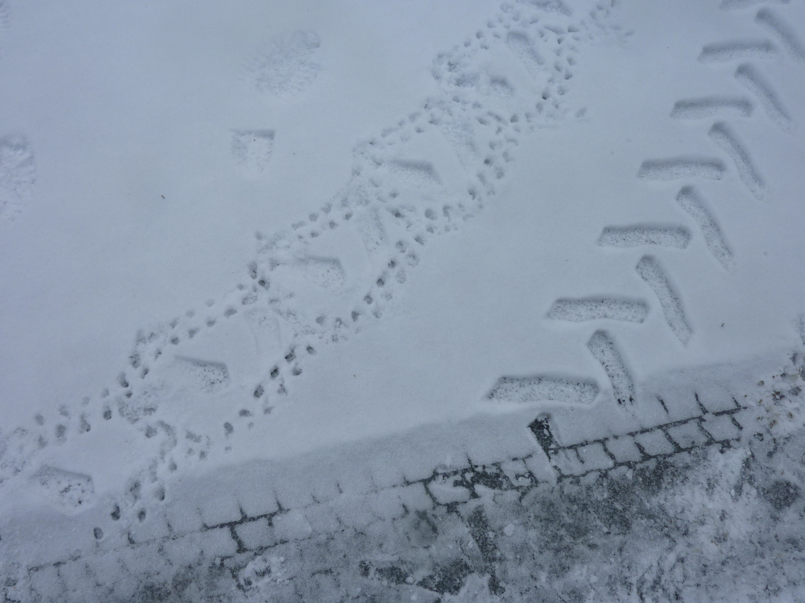

I noticed this clean set of track prints I made yesterday. We have ice under a thin layer of snow. To me this shows how a good set of ice chains work. The right track is the unchained front. The left is the chained rear. Notice how all of the weight on the rear tires is on the chains all the time. You can hardly see the ag tires making a mark. The chains are never down between the tire lugs - always on top.

Excellent example...
/ Good Ice Chains at Work #4
Looks like you have the perfect set of chains there.
/ Good Ice Chains at Work #5
Nice set of chains GG. It's also nice to see such a good fit, too. My Dad always told me that a properly fit tire chain did not need elastic tensioners across the hub!

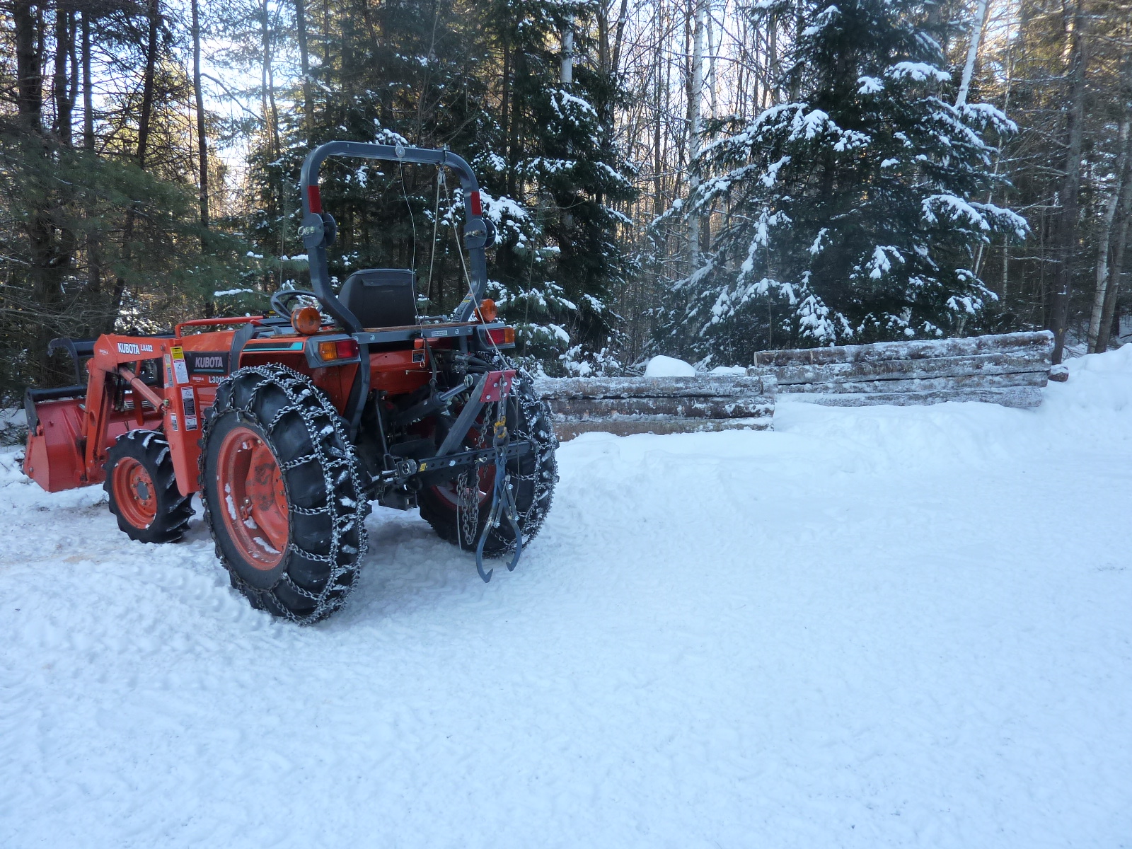

sweet chains, do you use them in the summer too? different pair?
I am also really interested in your hydraulic toplink and drawbar-logging arm. I like simple ingenuity like that!:thumbsup:
Sorry I didn't see this sooner. I see you are in Corinth - we are in Waterford. I like to use the chains in the woods year round. But I take them off when I have work to do on the gravel road and don't put them back on until that is over with.

Very neat. I was also looking at the cool frame you built off the 3 point draw bar, and connected to the hydraulic toplink. Do you ever feel like you need a protective plate, like on a Farmi winch? I am a novice, and have been using my rear blade for skidding single logs. Works well.

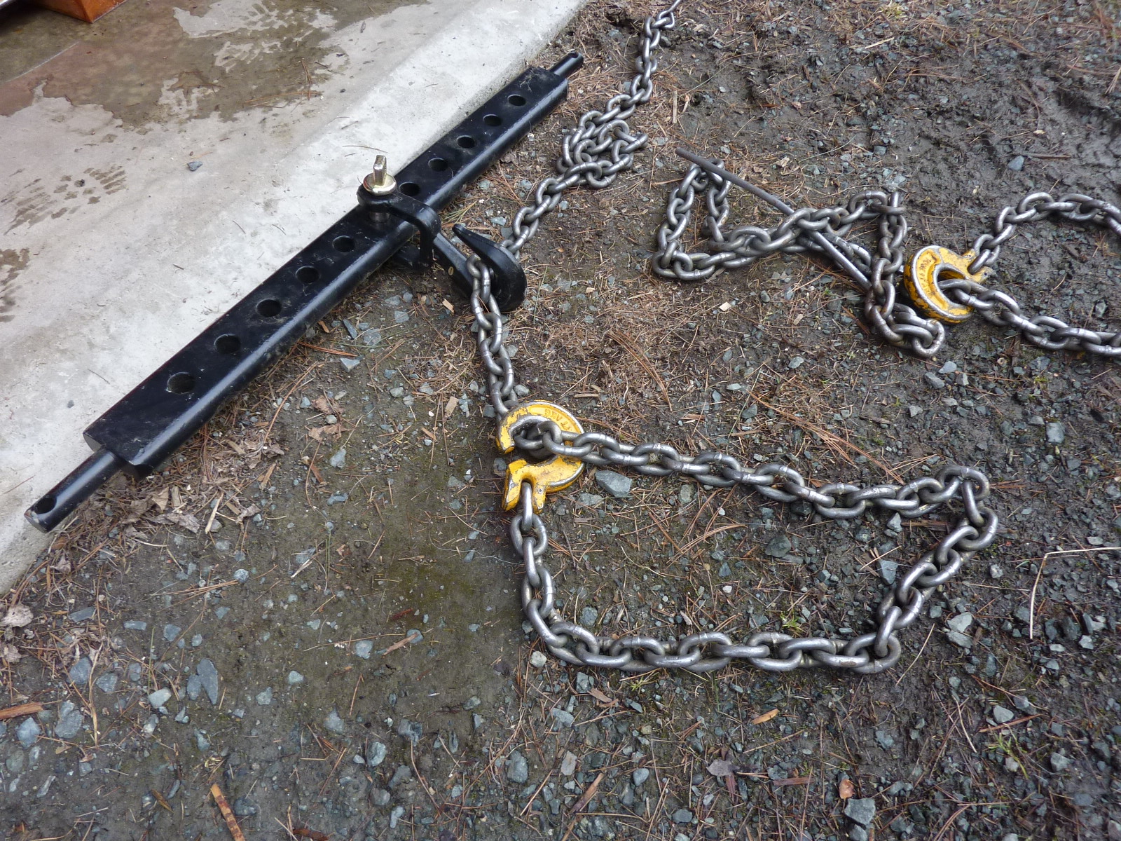

Hi Mr. Gould,
Do you have any more detailed pictures of your logging tongs you wouldn't mind sharing- I would love to be able to understand how that secondary articulation which you have bolted to them works, as well as seeing how your remote opening control is attached and deployed.

Hi Mr. Gould,

Thanks for your interest. Here is the tongs thread I made. There is a picture of the welded A-frame near the end.
The first A-frame used a chain top link and did not require welding which may be of interest. It allowed me to play with dimensions and angles.
In the center of the rops is a key/tool retractor that I use for "managing" my winch control rope. It zips it up off of the ground when I release it so it doesn't get caught in the chains and tires and is hanging easily accessible when I need it. The other item on the rops is a small pulley so I can get a vertical pull on the rope to latch open the tongs

We use a L3000DT in the woods;just about perfect.We have a similar log arch.
If you pull your logs low, slow and easy and pay attention you don't need a protective plate for the logs to push on. Do a search on skidding logs and you will get an education on how people do it and see the widely varying opinions of what is considered dangerous. Just always work low and slow, that is, keep the log low as possible and go slow. Millions of logs have been moved with tractors. A simple cross draw bar like mine fitted with one or more tractor hooks is an easy way to start. Nothing wrong with using the rear blade either but the weight is kind of back. Getting the log closer to the tractor could be better if they are larger logs.

Awesome, thanks for the info. I read your build thread on the tongs and putting together the A-frame, I like the idea of fabricating something similar. As did everyone else in that thread!

What brand are those chains/supplier?
