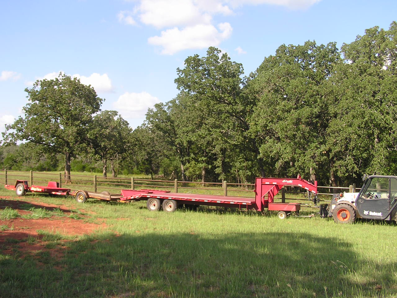

   / Goose neck vs bumper pull #67
It will be much better to drive, no more tail wagging the dog effect. No more tongue weight bouncing the front end up and down.
Very nice trailer.

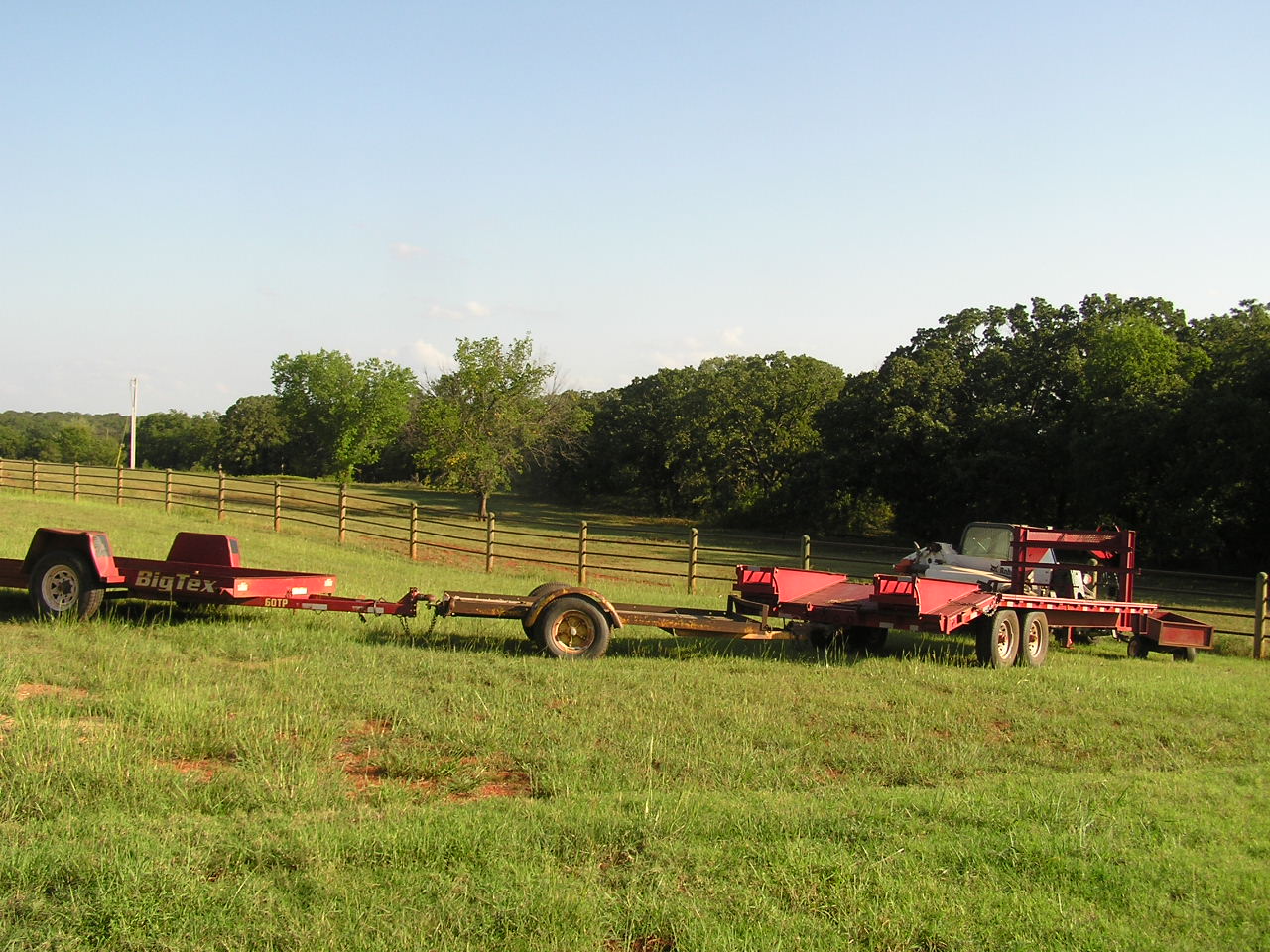

   / Goose neck vs bumper pull #68
   / Goose neck vs bumper pull #69
Ive got three trailers right now and need another one which will replace two. So I'll still have two after its all over.
I had to do some math, I've got 4 trailers. :)
At least you didn't have to use fingers on both hands to count.
Very nice trailer.
Thanks, it has been a good one and had a lot of use.
I also have 4 trailers and can pull them all at the same time! :thumbsup: :D
But I can't back them very far. :thumbdown: :eek:
