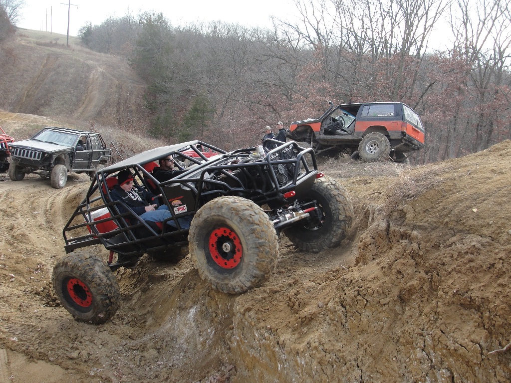

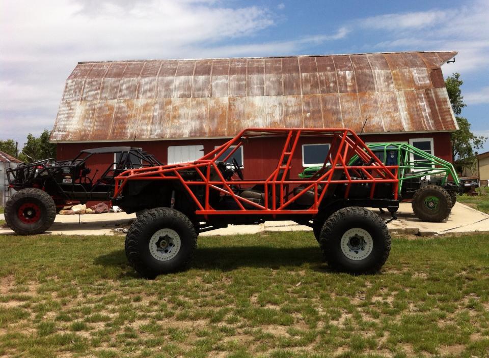

Trailer pulling story. I was pulling my 6800# GN trailer with 2 Jeep Buggies onboard with my '00 7.3 Powerstroke. Friend of mine was pulling same size trailer with a Jeep Buggy and a Polaris RZR onboard with his '06 6.0L Powerstroke. On an accessable 4 lane hiway. A GM Duramax truck pulled onto the roadway ahead of us pulling same size trailer with a Bobcat CTL onboard. My friend was ahead of me. We caught the Duramax before he could get up to speed and started passing him. My friend got ahead of him and pulled back into the right lane. I was coming behind still in the passing lane. I noticed the Duramax was in the throttle and smoking. Ahhhhhh,,,, the race is on. The Duramax pulled into the passing lane ahead of me so I had to match his speed. We slowly crawled past the 6.0L. After he got past my friend the Duramax pulled to the right lane. Him and I raced for about 20 miles. Took me that long to get past him. I looked at my speedo as I crawled past him and I was going 87-88 mph. As I passed he gave me the thumbs up and courteously flashed his lights when I was clear to move to the right. My friend in his 6.0L was at least 1/2 mile behind by this time. The two Powerstrokes were stock. Pretty sure the Duramax was too. Hope so anyway or he would be very disappointed. :)
Nice Jeeps ovrszd. I'm mainly a mud racer, but I have some friends with buggies and they are a lot of fun. Here's one of my similar towing stories.
I guess it's left over from my street racing days, but it doesn't take much to get me going either. Just after daylight one Sunday morning me and a few friends were on the interstate still trying to make it home from an all-day/half the night race. I was driving my 250 (7.3 Bully Dog equipped) pulling a 28ft gooseneck loaded with my race truck and all the other usual stuff you haul around (2 sets of tires, generator, fuel,etc.) when I hit a single lane construction zone which was about 3 miles long. I slowed down to around 60 and wasn't paying a lot of attention, but just as I was exiting the construction zone I noticed a 3500 Duramax pulling a dirt track car coming up on me fast (he obviously didn't slow down).
Just as we exited the zone, he shot to the inside lane and started around us. My buddy (still half asleep) looked of at me very surprised and asked "You going to let him do that". At the time, I was tired and didn't really care, but true to my nature .... started thinking. He managed to get his trailer just pasted me when I decided not today my friend. For the next mile or so it was on, somewhere around 90 I pulled back up beside him and started to pull away. Neither one of us lifted and I pulled him a truck/trailer length before he finally did and fall back. I don't know, but I'm sure we broke triple digits.
My buddy (still half asleep) asked "Changed your mind". I said yeah, got to thinking that the very first thing that guy was going to do Monday morning was tell all his friends at work how he blow past this Power Stroke and there was no way I was going to let that happen.
