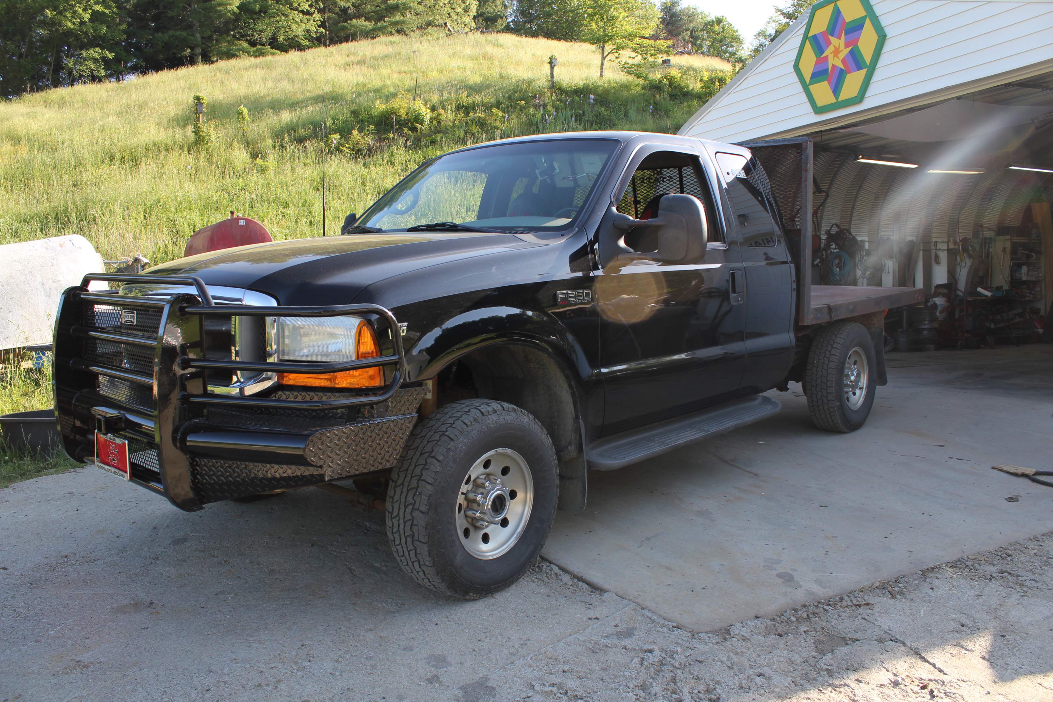

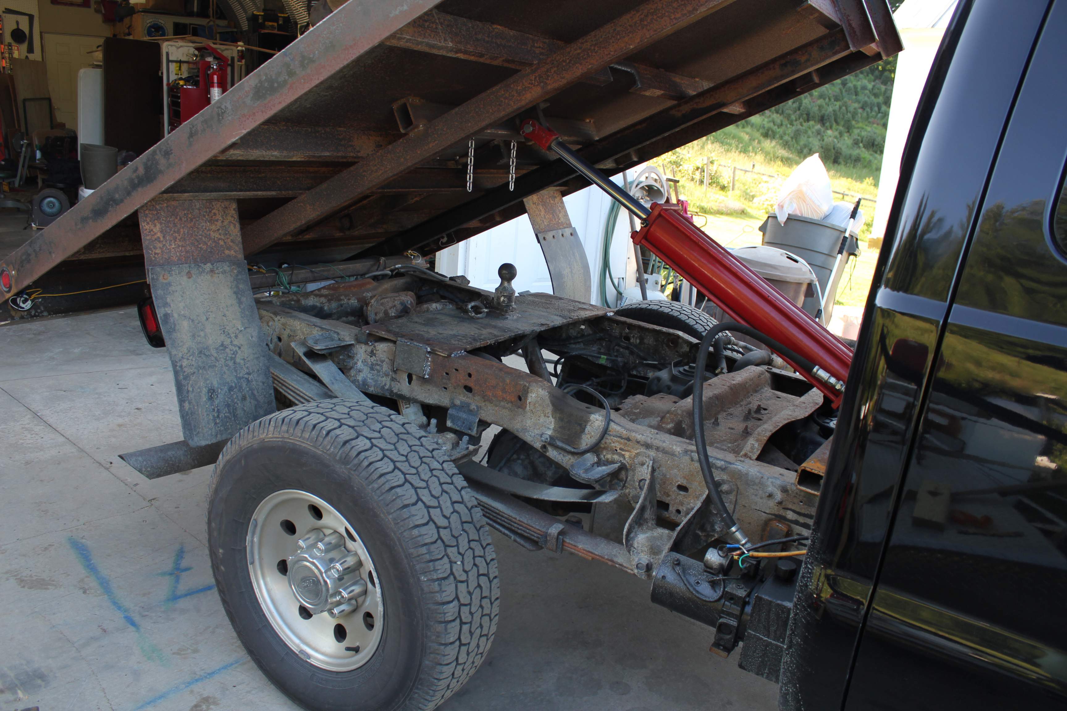

QRTRHRS, you are correct.99'F250 SD extended cab, V10 4x4. We replaced the rusted pickup bed with 7' flat dump. Used a center mounted 30" cylinder with a old Northern electric/hyd pump. Best I can figure the old bed, bumper weighed about 350 lbs,the new bed,pump,cylinder is 1000 lbs, so I weigh about 650 lbs more. Total truck weight now is 7400. The gooseneck ball is frame mounted, about 6" behind the rear axle, it was centered before the conversion. I know that is not ideal, but that was where it would fit. Thought about using two sidemounted cylinders, but they just didn't seem t fit and I would had to have a bigger pump tank. I don't pull heavy loads, so I think I will be ok, it just won't ride or pull like a more forward mounted hitch.
Not sure what the dump is rated, but it did dump 1 ton of gravel yesterday, which is about as much as I want on the truck anyway. So far, I'm happy. Pictures soon

As promised, here are some pictures. 99' 250SD, V-10, 4x4. New steel bed, 7', electric/hydraulic dump, frame mounted goseneck hitch. Bed will be painted this week, truck was painted last month, new RanchHand front bumper.

that's a nice looking truck, you will probably be ok especially considering that you are still leaps and bounds better than a bumper pull hitch as far as weight position.
   / Gooseneck ball installation #11
Always AHEAD of the axle, as far ahead as you can get it, the one on my 1 ton is approx 12 inches ahead.
Directly over is a common mistake, that leads to a teeter-totter effect that you WILL feel.
   / Gooseneck ball installation #12
I would not go aft of the axle, only in front of it.
Sell the GN.
