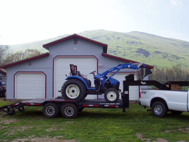

I am in the process of preparing to buy a Woods BH90-X backhoe and hydraulic thumb that will attach to my New Holland TC-40. My gooseneck flatbed steel trailer deck is 16' with another 27-1/2" beaver tail. I have been working closely with a fine member of this forum who has been providing me measurements of his similar to my tractor with a BH90-X backhoe and with this information the backhoe bucket will be at about the upper middle of the beavertail with the FEL resting on the gooseneck. The trailer is a 1974 Zieman and can carry 16000 lbs.
Are you sure it can carry 16,000# or is the the max GVWR of the trailer? I am guessing from the looks of it its GVWR is 16,000# and the trailer weighs about 5,500# leaving 10,500# for the load.
Just curious?
Either way its a good looking trailer for a 1974. Probably has never been abused.
Chris
   / GOOSENECK - TWO QUICK QUESTIONS #20
Just curious?
Chris
Yes, the GVWR is 21,000 lbs. I could not find an attached spec tag on the trailer when I bought it so I called Zieman in SoCal and with the attached (welded) serial number I got that GVWR over the phone. I put new tires on it, matched what was there-7.50-15, 14 ply rating, DOT OD57, Flange Guard. These are very heavy split rims, a thing of the past but in very good shape. The trailer has a steel diamond tread deck and electric breaks with a battery operated break-away system and there is no major or minor rust, some surface scale and very little of that. I bought it on E-Bay for $1400.00 and it was located about 15 miles from my house so I got a chance (several) to inspect it.
