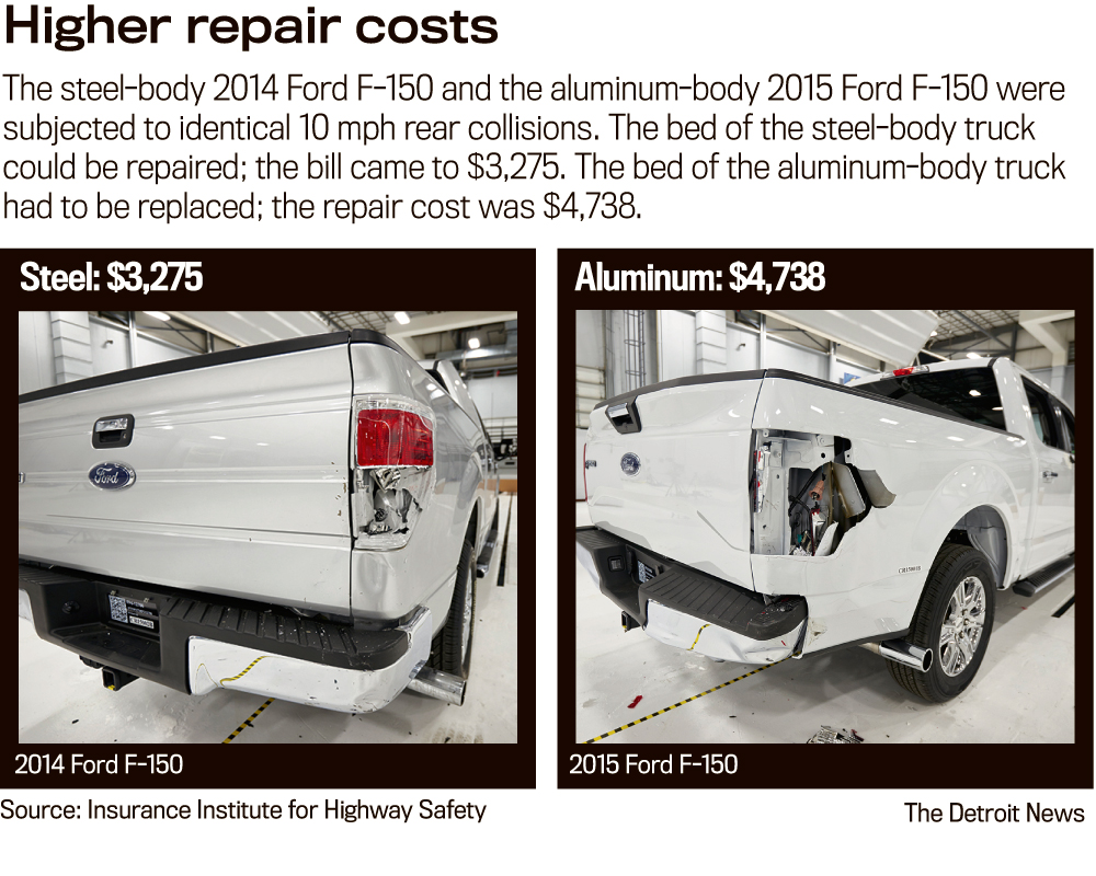

Notice how the conversation gets changed from body shops being able to repair aluminum to Alcoa splitting into 2 divisions and semi trucks using aluminum. This is about the ability of the auto body industry to do repairs on aluminum vehicles for the same cost of traditional steel body repairs.
The issue here is that only 15% of the body shops in the USA are certified to do aluminum repairs. Doesn't take a genius to see that this alone will drive costs up. So if you have an aluminum vehicle you are a very limited choices for repairs and those shops who have gone to the trouble, training, and equipment purchases to handle aluminum repairs are certainly going to pass those costs on to the customer. Maybe manufacturers like Ford can subsidize that training and equipment to some degree but then the costs will simply be passed along to the purchaser of the vehicle. One way or another consumers will pay for this whether it is through higher insurance costs or higher vehicle costs as these body shops, manufacturers, and insurance companies are not going to eat those costs.
