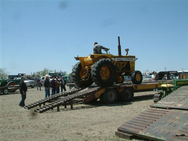

Pucker factor--how about this one
That's an 11,000+ lb Minneapolis Moline G1000 pulling tractor unloading at the Pioneer Days Rodeo in Guymon, OK in May08. He's backing that beast down 10-ft ramps-- those ramps can't be more than 18" wide and look pretty beat up to me.

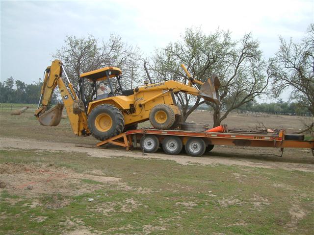

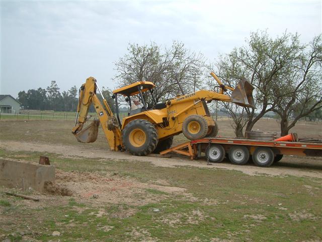

But some folks do it their own way. Here's my contractor backing his JD410C TLB off his deckover trailer
Those ramps can't be more than 5 ft long. Looks like fun.
I had him over to my place to dig a couple of holes to bury several concrete pony walls (lower right in the 2nd photo) left over from an old dairy barn that burned down or fell down, I don't know which. Cheaper than breaking up the concrete and hauling it away.
