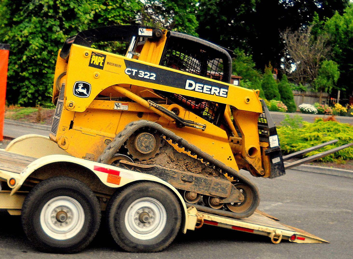

That will be a great tractor hauler. :thumbsup: I have loaded a LOT of machinery onto trailers before. The one time that I unloaded my neighbor's BX24 off a goose neck the ramps were 6 foot long and the deck was 3 feet off the ground. Kinda scary to back off of but i got it done, just put it in low and 4wd and went slow. I have loaded skid steers, multiple tractors, etc. In fact, when I went with my dad down to California to get the CT322, i drove it around the lot and put it on the trailer. They were so impressed that they gave me my own key for it. :D:thumbsup: I like backing on more since it rides better and is easier to unload. I attached a picture of me off loading the CT322. :thumbsup:

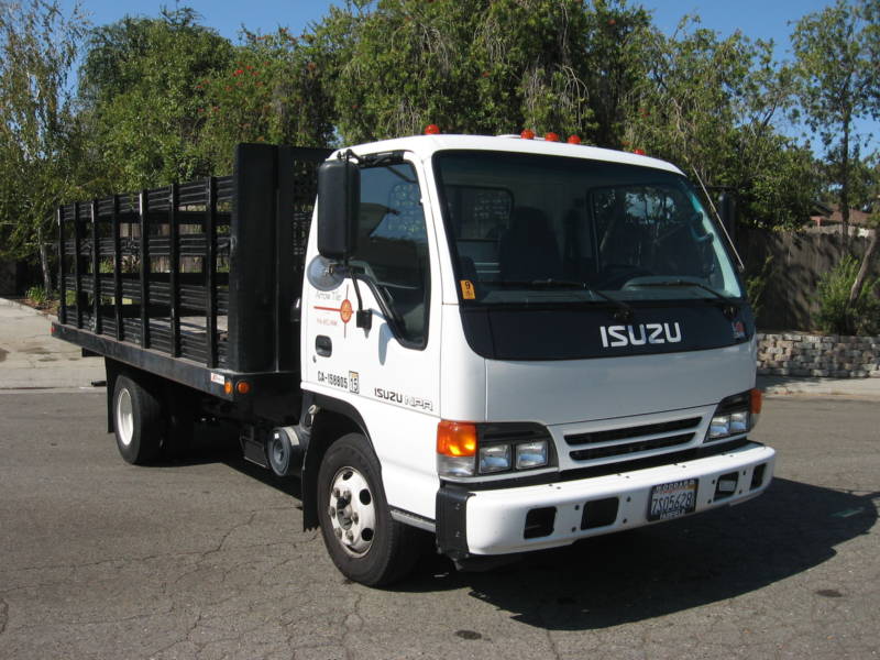

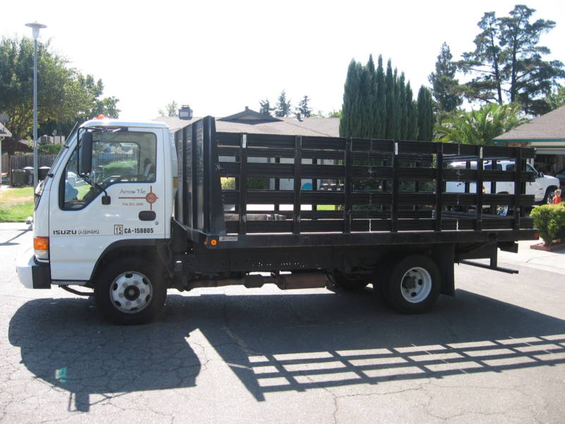

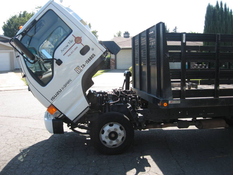

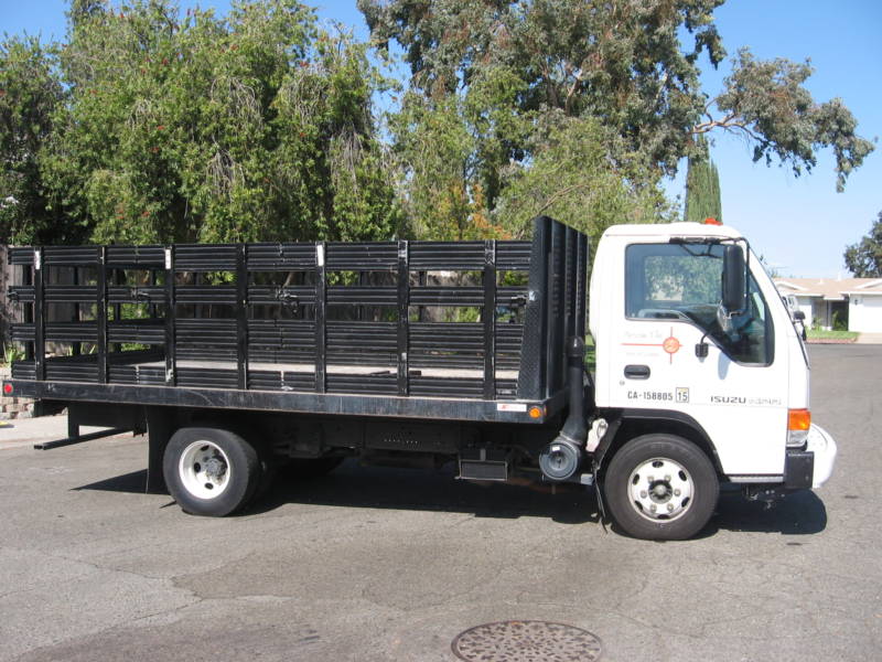

My problem: transport my restored parade tractors (Farmall Cub, Farmall Super A, Minneapolis Moline BF, Massey Ferguson 135, and counting) to tractor club outings (parades, picnics, tractor meets, etc). Max tractor weight is about 4000 lb.
After agonizing over 3/4T vs 1T pickups, Ford/GMC/Dodge, gas vs diesel, gooseneck vs tag along trailers, low-boy vs deckover dual axle trailers, I decided to go with this setup:
View attachment 190536View attachment 190537View attachment 190538View attachment 190539
It's a 2004 Isuzu NPR EFI stakebed (8ft wide x 14 ft long bed) with 49500 miles showing. It has the 6.0L (366 cu in) GMC gas engine (LQ4) the 4L80 4-speed automatic tranny and 4.78 rear end. This baby easily hits 75 mph (unloaded) but is a gas hog (10-12 mpg). No problem since I only need it on weekends to haul tractors (less than 3000 miles per year).
Next steps:
a) Get D-rings welded to the bed for chain attachments
b) Get an electric winch with wireless remote installed (I'm looking at the T-Max EW-9000W)
c) Get two sets of aluminum ramps. Discount ramps has car hauling ramps rated at 5000 lb per axle (10 ft long, 16" wide #05-16-120-01). I'll pair these up to make 32" wide ramps for the tractors I have now which are non-tricycle types. If I get a tricycle type tractor in the future, I'll have enough ramps to handle that configuration.
d) An underbody tool box (I'm looking at an aluminum 36x18x18 box by Highway Products).
Boy o boy, this is fun!!!!!!
Nice!!! :thumbsup: Be sure to post pictures when you load it the first time.

Nice job! :thumbsup:
