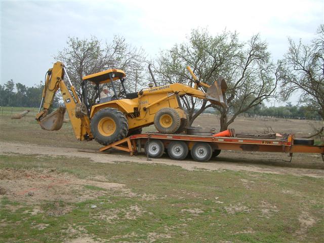

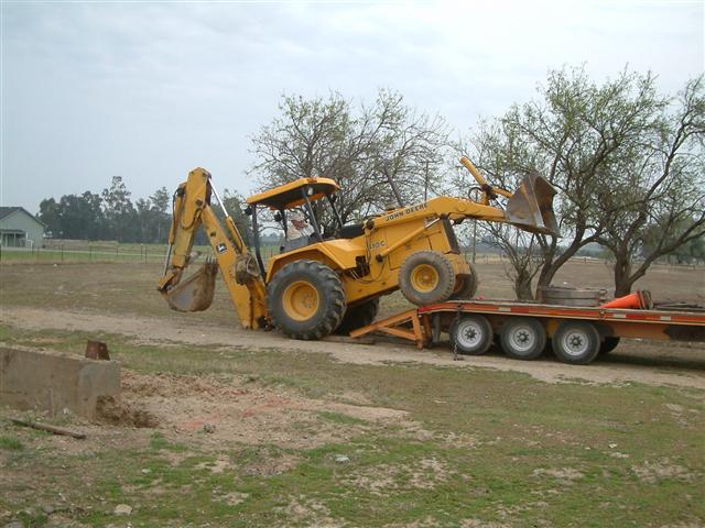

But some folks do it their own way. Here's my contractor backing his JD410C TLB off his deckover trailer
View attachment 190666View attachment 190667
Those ramps can't be more than 5 ft long. Looks like fun.
I had him over to my place to dig a couple of holes to bury several concrete pony walls (lower right in the 2nd photo) left over from an old dairy barn that burned down or fell down, I don't know which. Cheaper than breaking up the concrete and hauling it away.
Why doesn't he use the back-hoe to inch himself down those ramps.?? I had have that bucket engaged.
I've seen that method used before. Roy didn't seem to think it was necessary.
