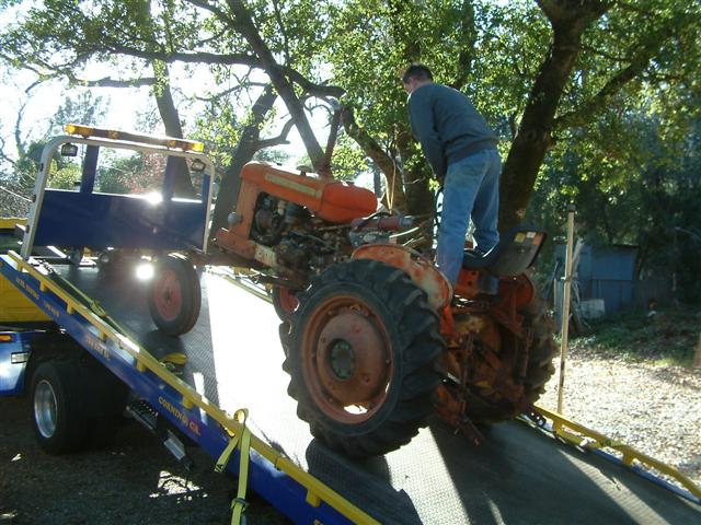

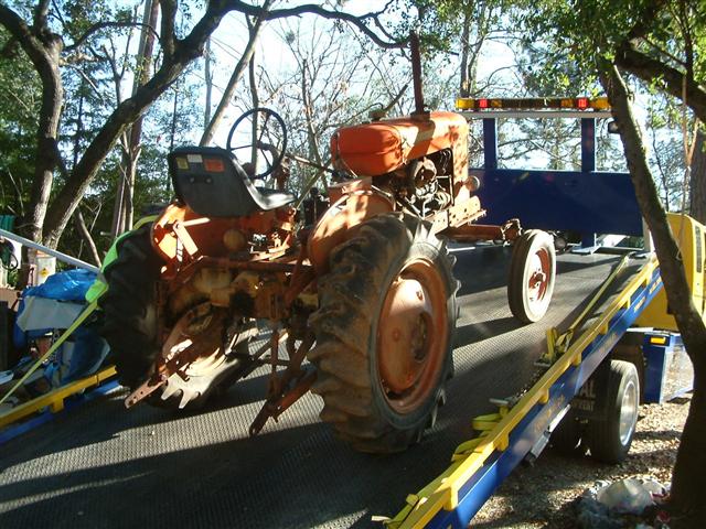

When I bought my 1951 Minneapolis Moline BF two years ago (now being restored), I had it hauled on a rollback. It wasn't running (no compression on 3 of 4 cylinders) so it had to be winched onto the rollback.
