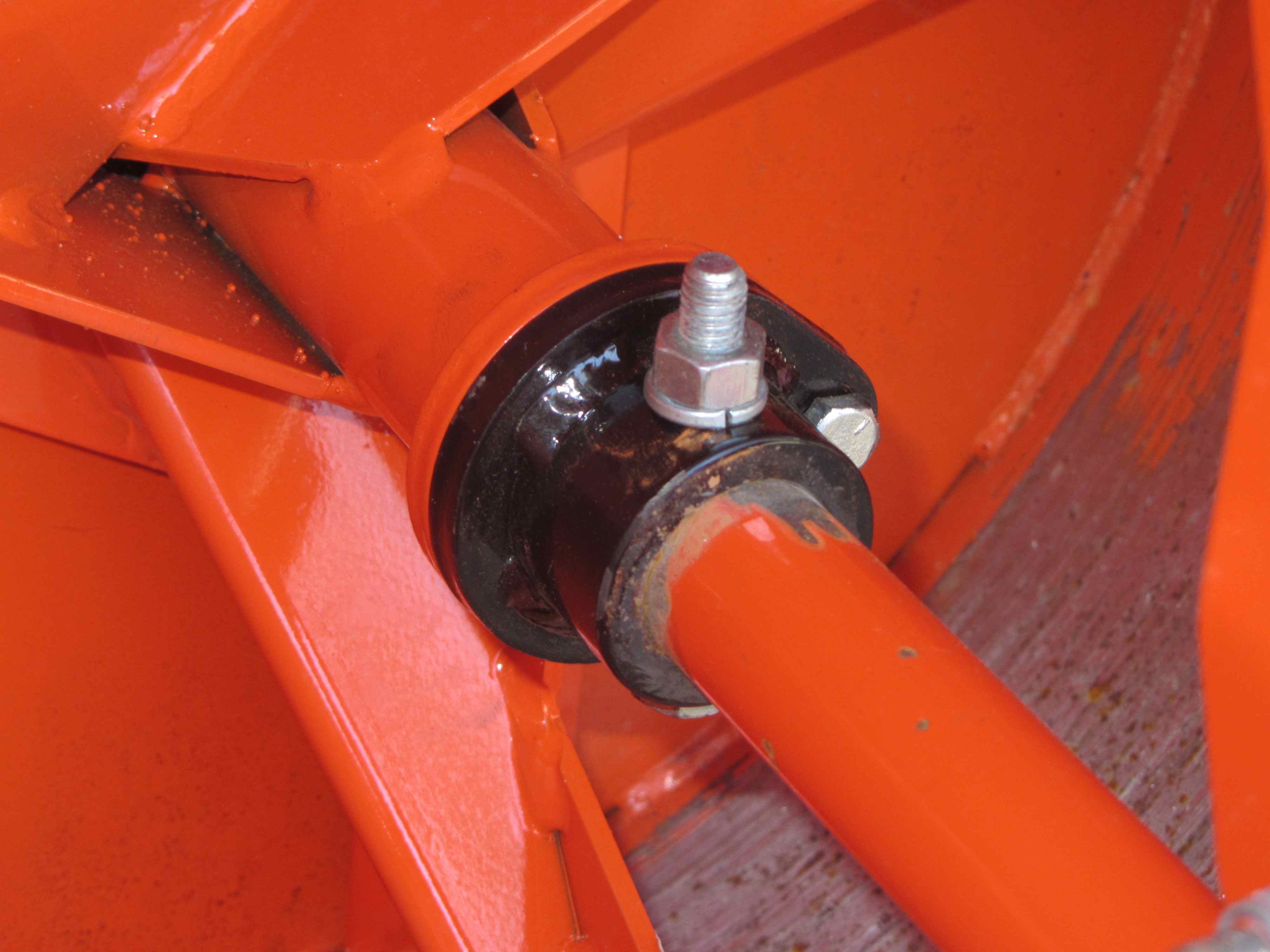

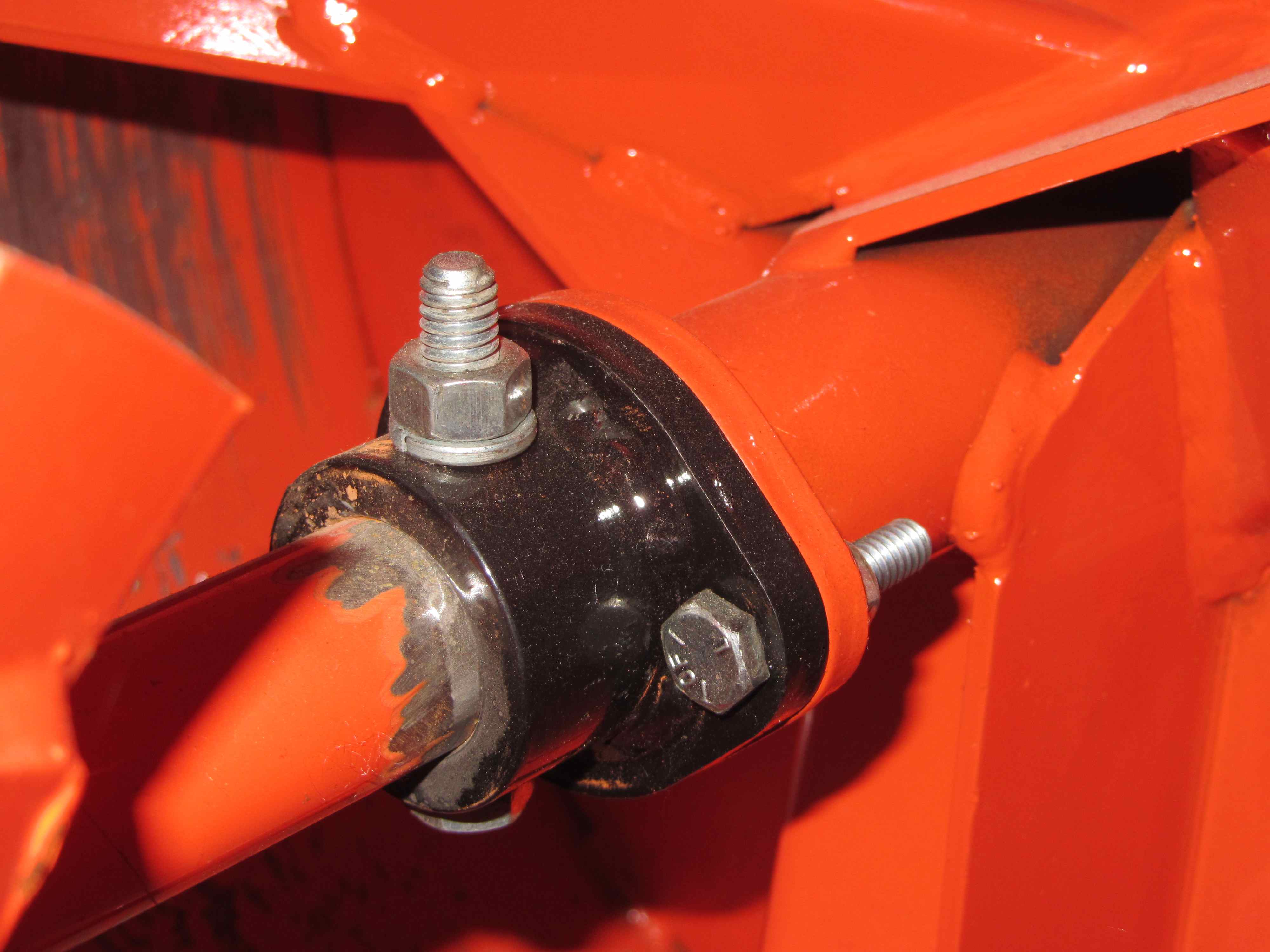

My dealer checked it out at the end of the season and replaced the fan with a factory upgrade. The new fan has a slightly different shear pin collar.
I too have this blower, but it is still in crate, I have no plans to unpack it until November. Can you send pictures of these upgrades to I can check mine? If it has not been upgraded, I would like to address that asap. Thanks. Philip.

Blowin Snow 2012.jpgGR2728 - New Fan Hub 2.jpgGR2728 - New Hub.jpgGR2728 Original Fan Hub.jpgBlowin Snow 2012.jpgGR2728 - New Fan Hub 2.jpgGR2728 - New Hub.jpgGR2728 Original Fan Hub.jpg

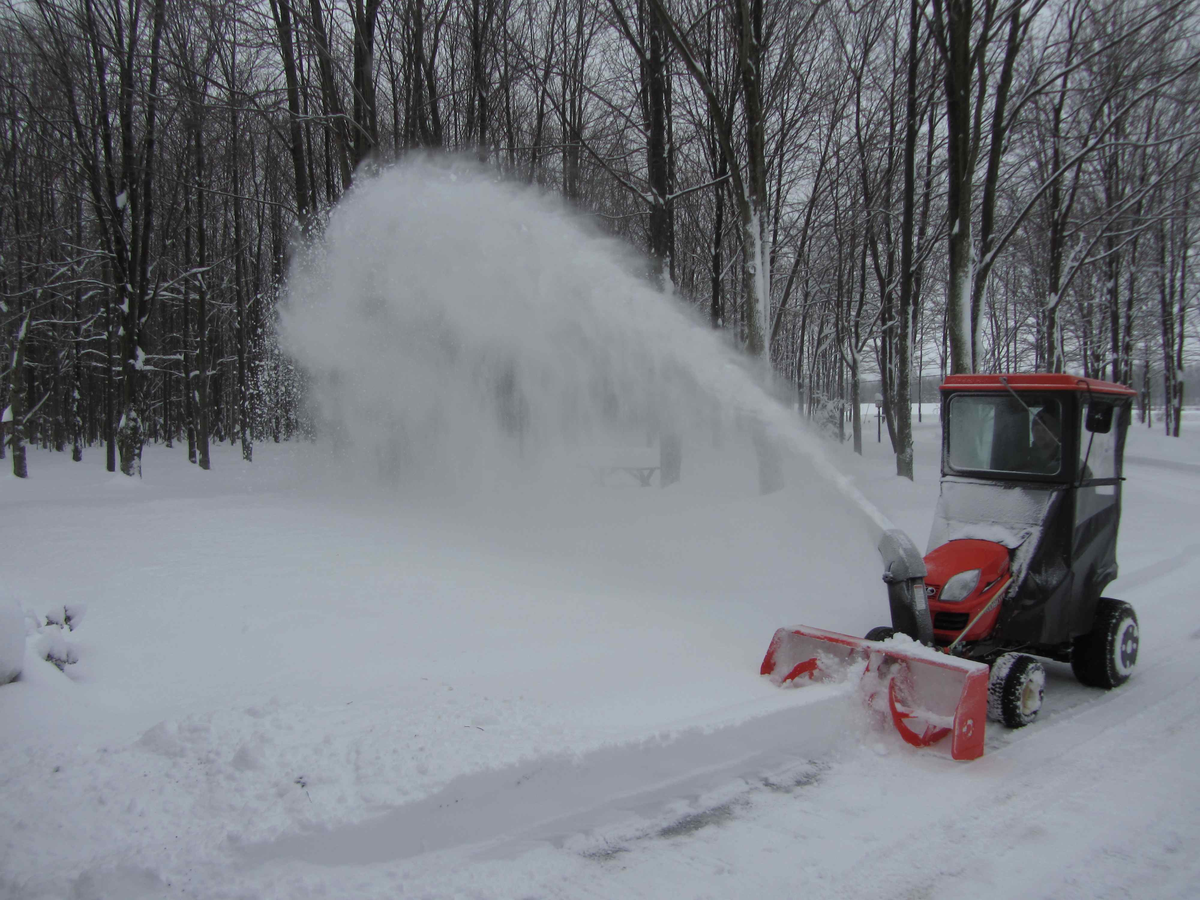

Hopefully I was able to attach the photos of the new Fan and Hub assembly. As you will see it is quite different. The shear pin is still the same. Also I added a shot of what you have to "look forward" to. Good luck with the new orange tractor.

Andre, The pictures are very helpful. Thanks so much! Philip.

I was looking more closely at this new fan/hub attachment and noticed a couple more differences (aside from the bolt/flange on the side.) First they appear to have eliminated the zerk fitting on the fan. Second, when you remove the shear bolt, the fan no longer rotates. My old fan would spin easily on the shaft. Finally, I am not sure what the purpose is of the bolt on the side... (you can't get a socket on it as it is too close to the shaft so you have to wrench it off. which wouldn't be bad except it has a locking nut.) So, I guess I have some questions for my dealer the next time I get down that way.

I did talk to my dealer regarding the new hub. As I expected, the "side" bolt" is the new shear pin. Since your unit came with it standard, do you have a part number for the shear bolt & nut? If you do I would appreciate knowing what it is. (On mine it looks like a grade 5 bolt...)
I havent looked in the blower manual where it lists the part numbers, but this is what they told me on the phone
The Fan sheer bolt is 7006004465

Where did you buy the Cab at? Did you have to drill a bunch of holes?
   / GR2120 Yea or Nay #57
The cab is from "Original Tractor Cab" Original Tractor Cab. You can find their products sold either directly from them or other online sources. Installation is fairly easy, no holes to drill. It is a custom fit for the GR2120. I had the same brand cab on my old Toro 520H for over 20 years and it was still like new when I traded it in. The new cab has some nice improvements. I did get the glass windshield on the new cab with the manual windshield wiper. It is a pretty good option but you can definitely live without it.
The cab is really great. The only minor issue I have is due to the reverse air flow on the GR2120 it tends to suck in snow at the door seams... My old tractor was just the reverse and blew all the hot air into the cab which was very nice. Anyway, this season I plan on putting an air vent in the back of the cab to reduce that problem. Just wish their was an easy way to vent the heat from the radiator into the cab. Need to think about that a bit. Note: I have more pics of the cab posted on Orangetractortalk...
   / GR2120 Yea or Nay #58
It will take a little work, but you can get a pusher fan from Multi-Wing that will blow hot air into your cab during wintertime. You will have to remove fan, measure, and provide details, but they can make you a new fan. I would not use it for summer operation though. Philip.
