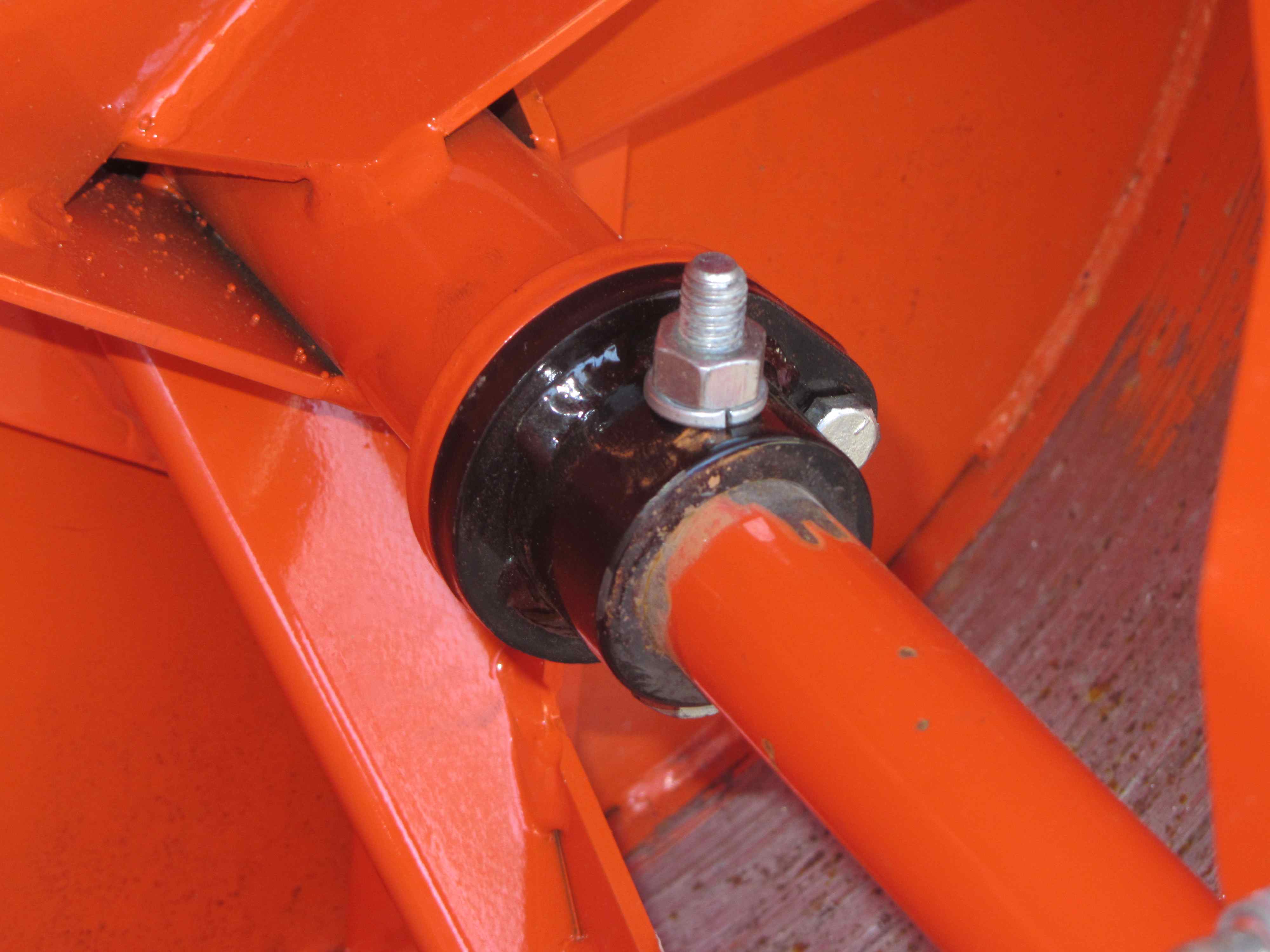

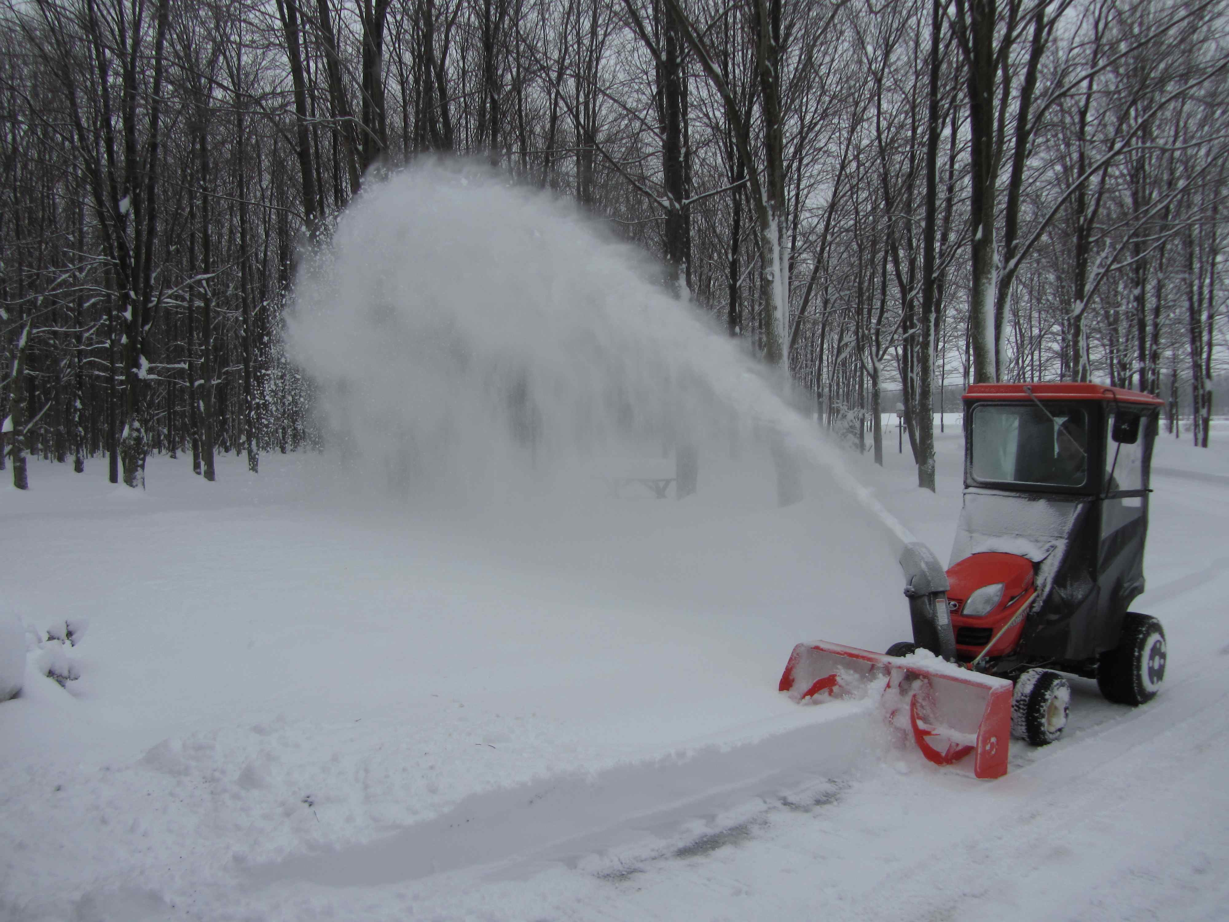

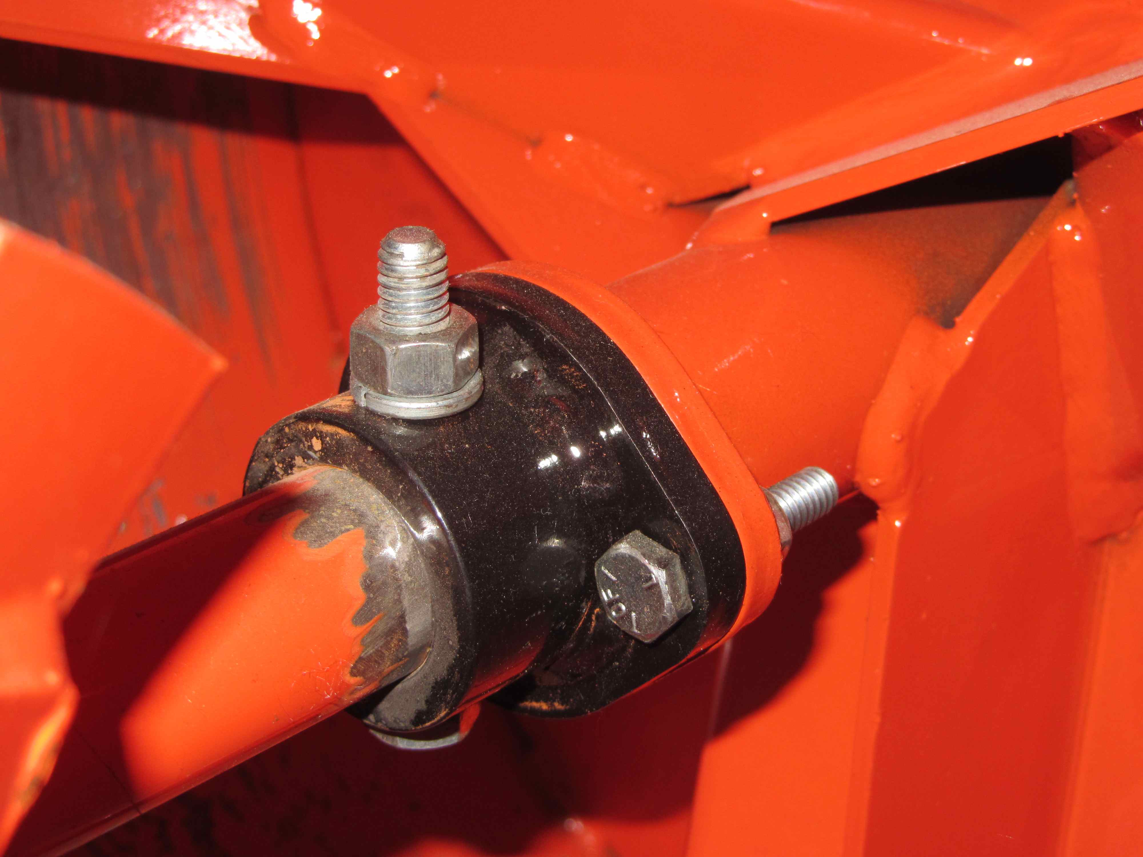

Hopefully I was able to attach the photos of the new Fan and Hub assembly. As you will see it is quite different. The shear pin is still the same. Also I added a shot of what you have to "look forward" to. Good luck with the new orange tractor.

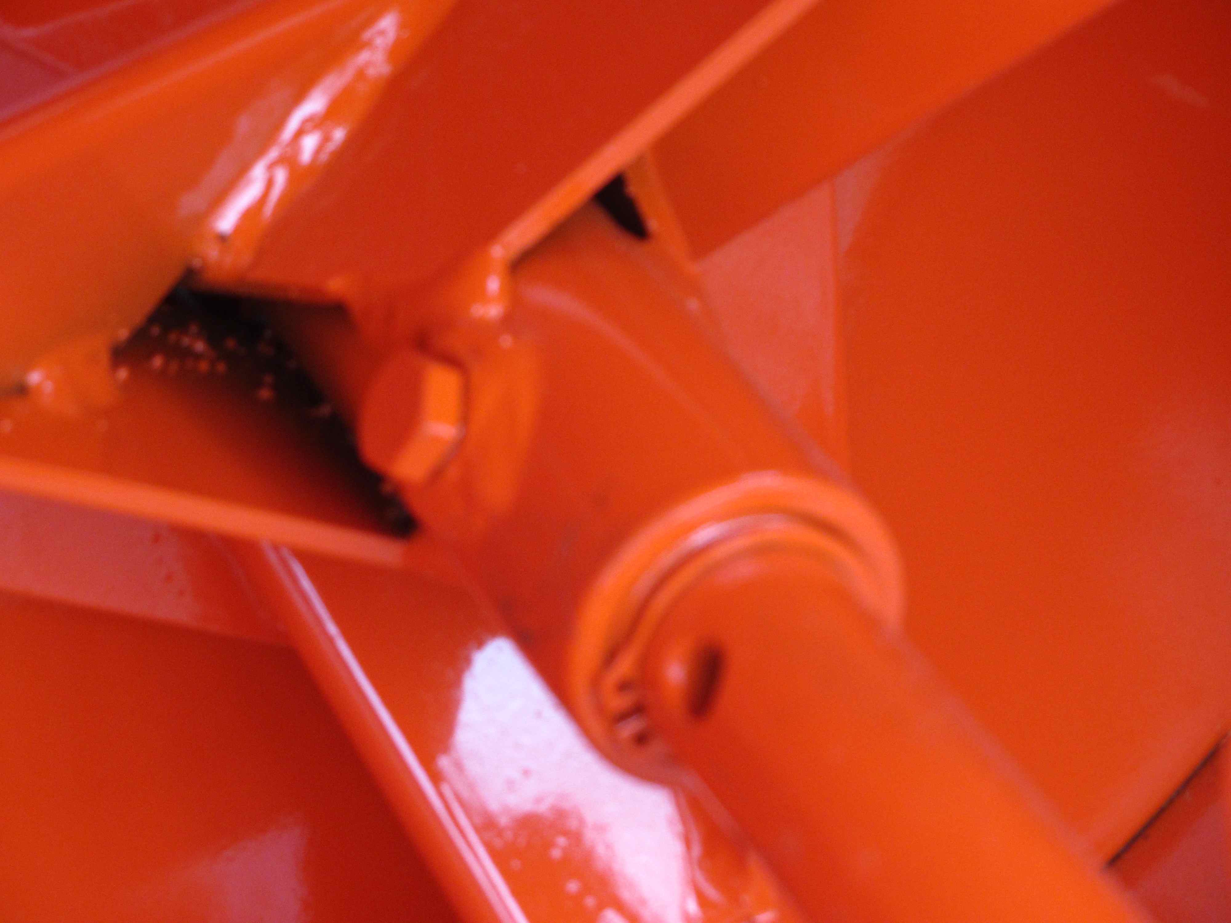

That black part is the updated part i take it.......which is the same on mine, but it's orange, which means it came out of the factory that way. Looked mine over today, since i have to replace a sheer pin and noticed that that vertical bolt showing is not there, just the horizontal one. Nothing turns by hand, thinking if lost that bolt, i should be able to turn it like the auger i lost the pin from is. Got me wondering now......
Philip...can you take a look at on yours for me and see if yours is the same as on mine on the pic below or as in the picture above?

Looks like you are missing the bolt that connects the shaft to the hub. Lossened up and came out? That is not a shear bolt. Do you have parts manual? Will be in there. The shear bolt is connecting the two flanges, in your picture at two o-clock. Philip.

That bolt going through the 2 flanges serves no purpose at all, since they are both welded onto the same tube. There is nothing to sheer. Parts manual calls it a sheer bolt....hmmm.
The bolt going through the tubing/shaft, that is missing on mine, apparently is only there for looks. It too serves no purpose as i see it. Everything works/turns without that bolt.

The bolt going thry the two flanges is the shear bolt for the fan. Trust me, I know. Philip.

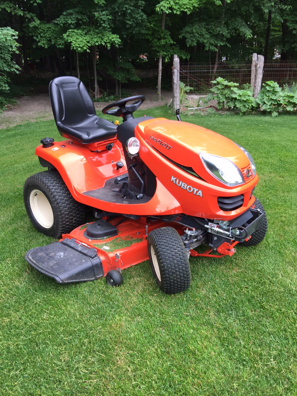

Got the 2014 GR2120, with 66 hours for the same price as new, except it included a snowblower, the completed 50 hour service and not tagged with a $1600 tax bill. Major win!. 66 hours on the clock produced savings of $4500 over a truly "new" 2014 unit. Further, the previous owner did a great job (solder, shrink wrap) on an aux light install (which I will probably replace with LED's) and rear tail lights. The whole unit is mint.
Here she is, after a flawless first cut (means so far I am in the 'Yay' camp!
