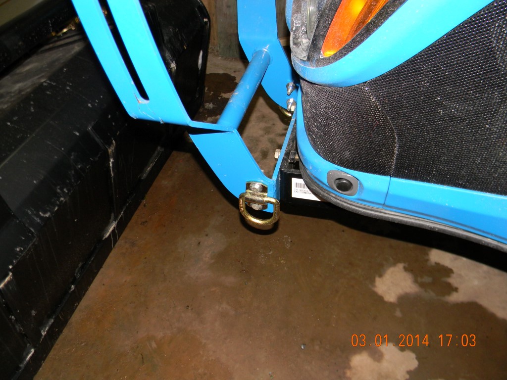

I bolted D-rings on my front brush bar for tie downs. On back I use a twisted clevis on the drawbar. I can drop a chain through the clevis loop and run one to each side of the trailer.

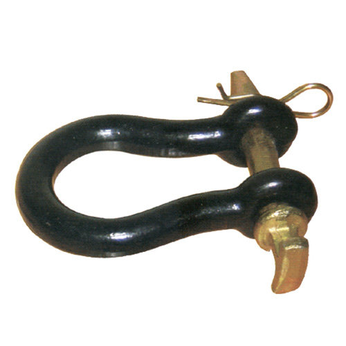

I don't have a grille guard on my T2320 but there are holes to bolt one to it. I drilled two of the holes, one on each side, to fit a clevis like this.
1 1/4 x 3 3/4 Straight Tractor Clevis

The frame on my XR3037HC does have holes pre-drilled that I could have bolted the D-rings to. However, where the D-ring would have bolted on the right side the exhaust pipe is right in the way for it to swing up. I didn't want to cut or bend the pipe which is why I mounted them on the brush bar.

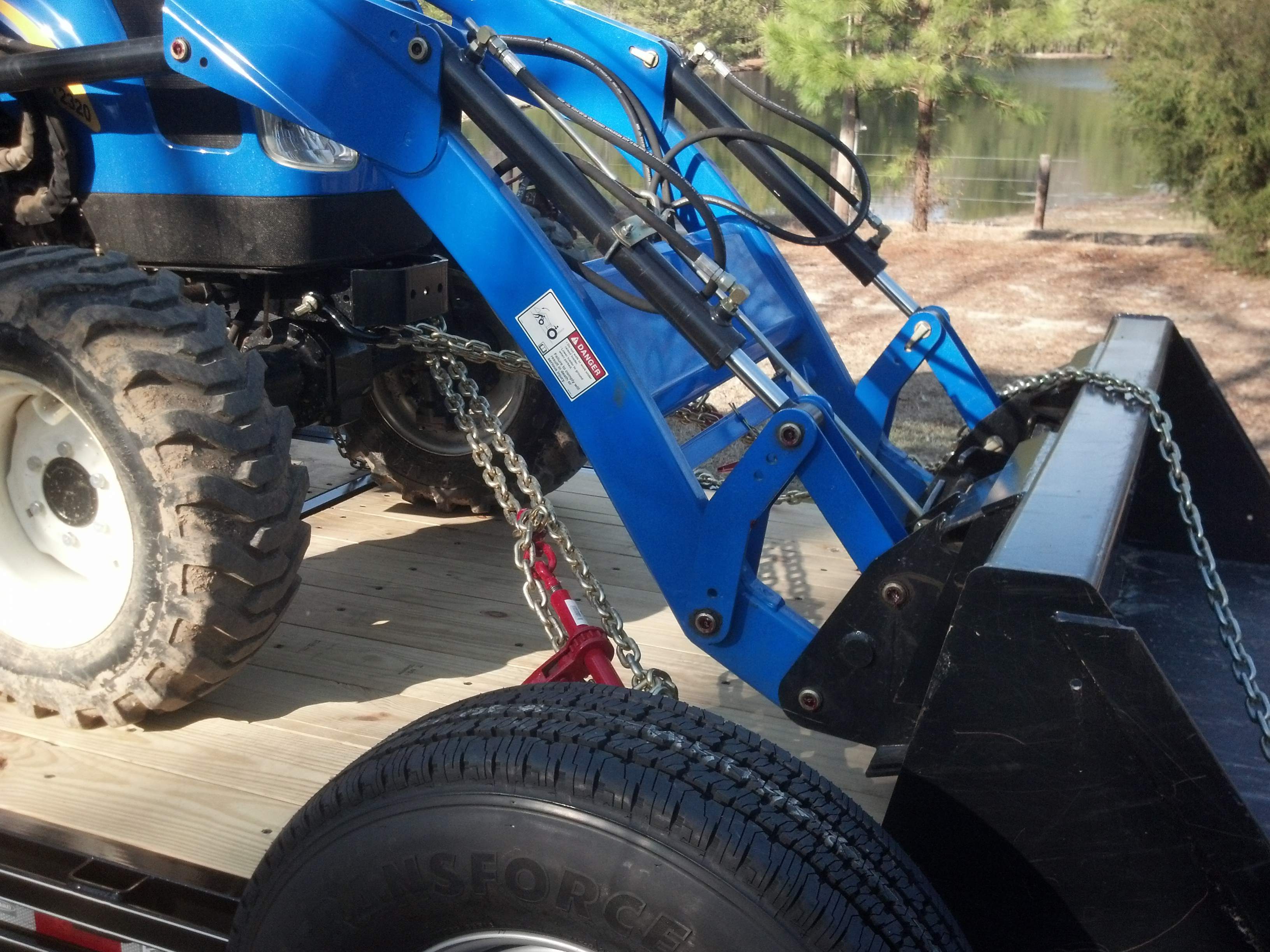

Here is what I did to mine
