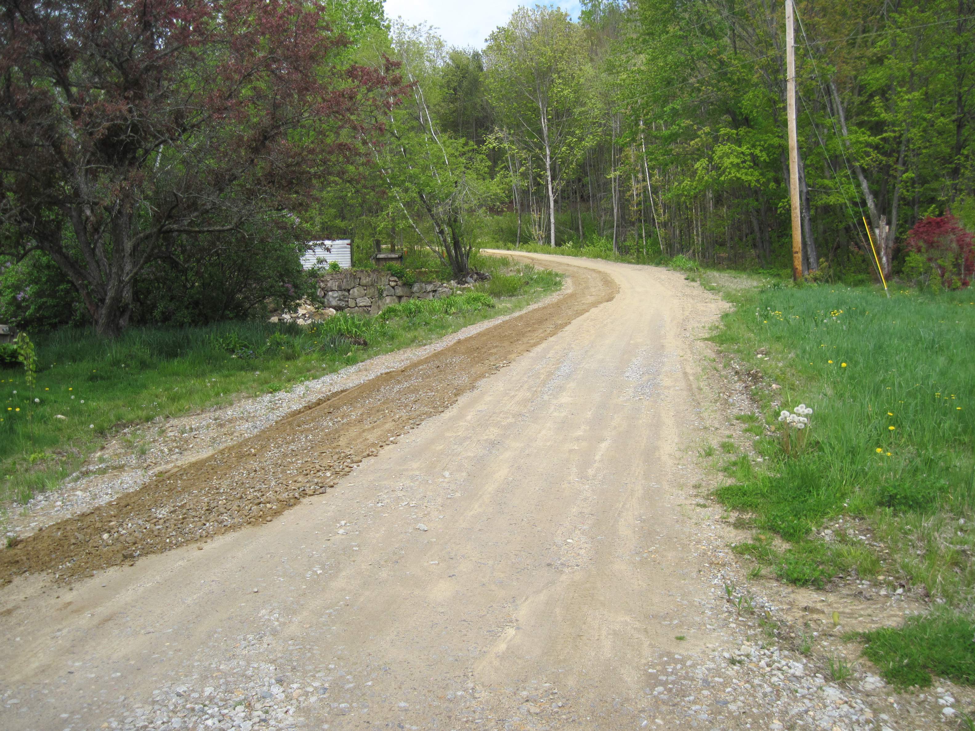

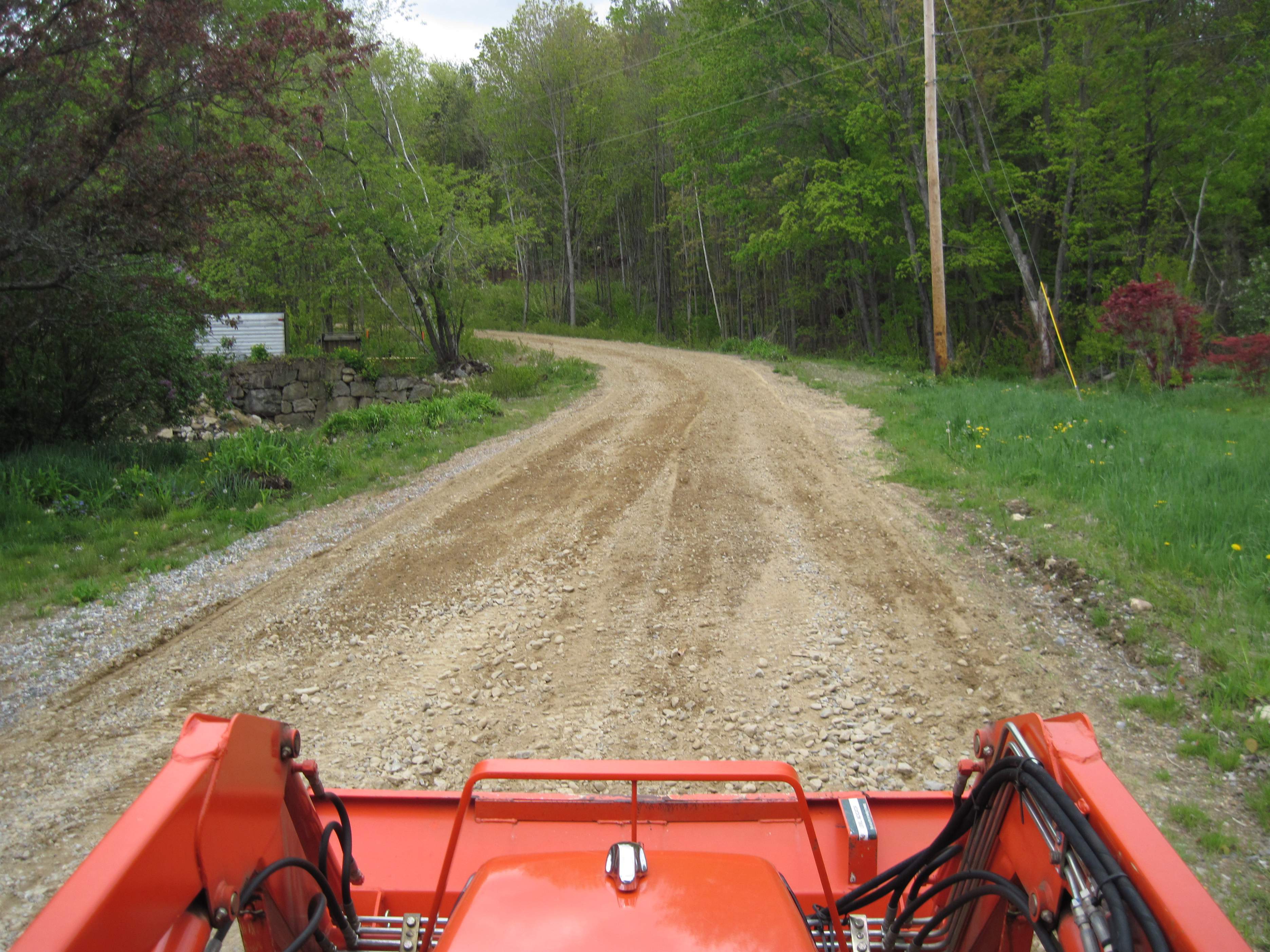

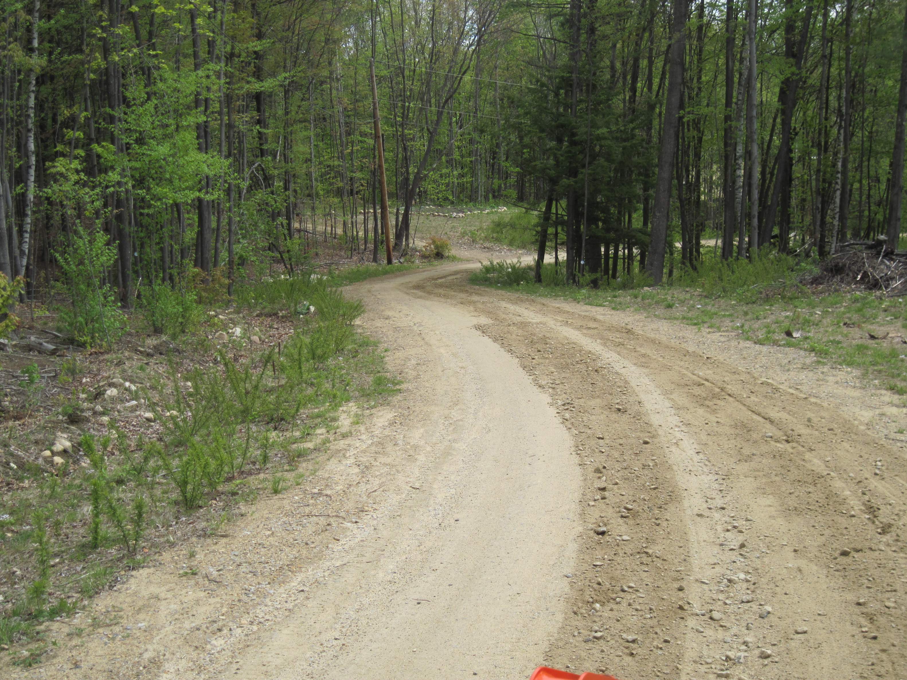

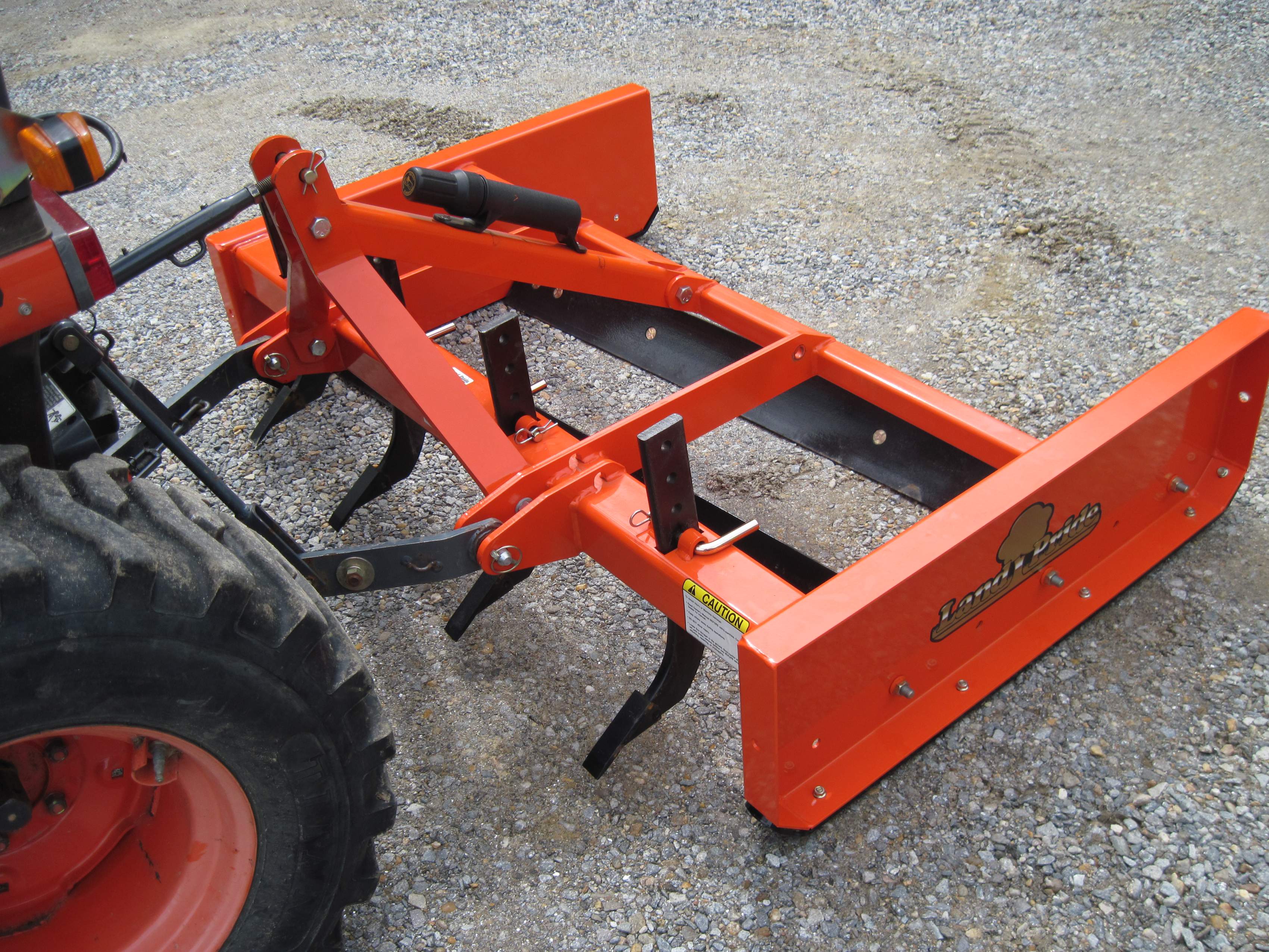

The sides on this unit are 22" tall, and I routinely have material over them. A lot depends on the type of material being graded, moisture content and if I'm lazy that day and don't pay attention. There are a lot of times that I don't pay attention. ;)
I took those pics to my friend as well.:D
